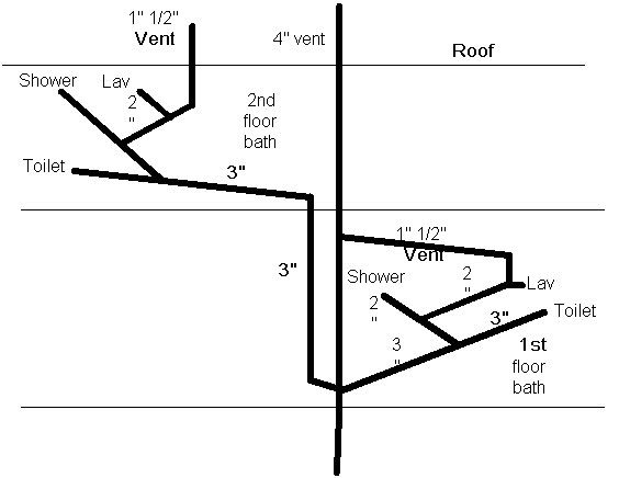

I'm starting out on a new kitchen remodel. I intend to do this right and obtain full permits for everything I was told I need to make drawings and provide measurements for the whole house.
i'm a terrible artist and have no idea how to start, except by getting some graph paper and start measuring and drawing. I figure theres got to be some computer programs you folks use that aren't expensve or maybe free.

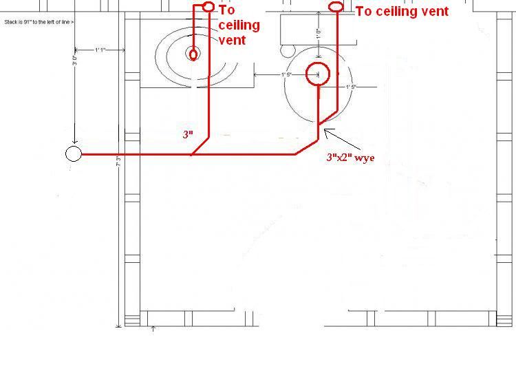

AFAIK , and in my area on the east cost, you need to submit drawings with the permits of the work that will be performed.
Example I submitted these plumbing, electric, and fixture layouts for an upstairs bath I dormered out..
I found the plumbing.
[IMG]
[/IMG]
I cant find the electric.. Here is another type for additional plumbing from the other view, and you would use the same for electric with fixtures and such in the proper locations.
[IMG]
[/IMG]
I use visio, but its not free..

I'm no artist either but never thought that drawing floor plans was difficult since you're using a ruler and drawing everything to scale. They even make templates to draw in plumbing and other fixtures.
Many but not all permit offices require detailed drawings, it all depends on how strict/lax your particular office is. IMO paper, pencil and ruler is easier than computer software but then I am a low tech guy
For drawings on a kitchen remodel, they are interested in whether or not you are removing walls or changing the structure in some way. The electrical and plumbing are done in stages usually and those plans sub-permits are usually pulled by the licensed plumber or electrician. So there is a master permit and all trade permits under it. Optimally, you could submit copies of the original blueprints and indicate the changes on them if structural.
On a simple remodel, you can usually get sufficient plans with off the shelf software such as those provided by the "Punch" company. It will get you close enough to pass your permit phase. If all else fails, have a meeting with the permit dept and ask what they need. They are pretty friendly in my town. Home Design Software for PC and Mac | Interior Design and Landscape Design | Punch! Software
