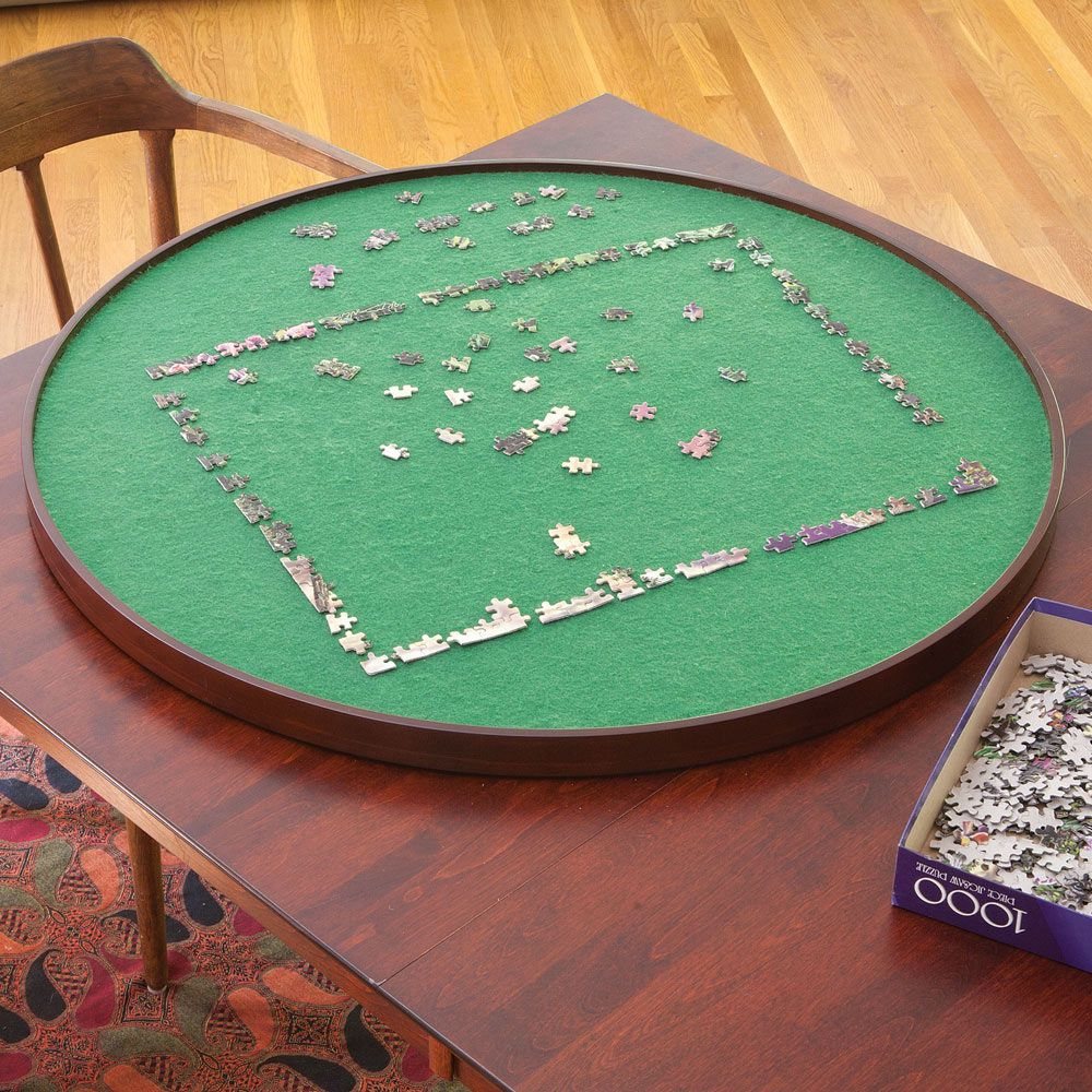

I wasn't quite sure where to put this. I want to build something like this for my in-laws. Looking for some ideas for the piece to run around the outside. Obviously need something flexible.

Go to Amazon and search for flex trim. There are a variety of profiles to choose from. If that is too pricy, you could always bend and glue up your own molding from several layers of thin wood strips.

Never knew there was such a product, especially available on Amazon. Something there will work. Thank you.

I don't think you will find that size surface disk. However, you can buy a Lazy Susan that you can mount a very large wood disk. From Amazon there is this.
Woodpeckers Lzy-12-1 Lazy Susan 12" 1000 lb. Load Capacity Hardware 5/16 Thick Turntable Bearings
