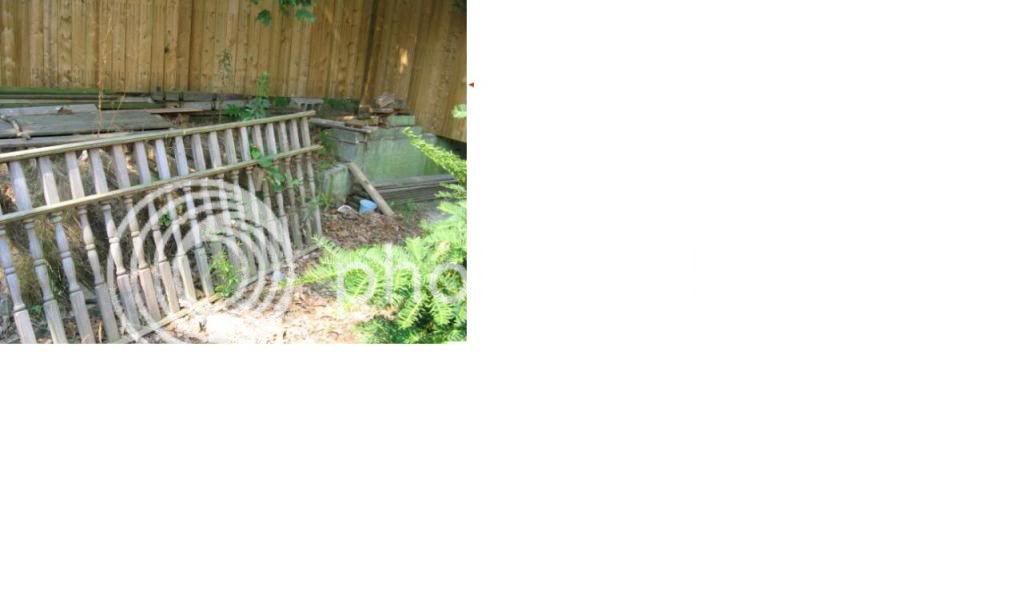

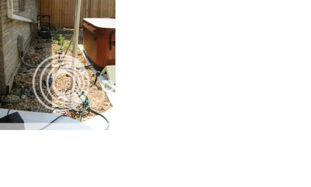

well i did research over the winter and had a personally referred contractor come out and after 3 visits have decided i will probably let him do this...what do you think of the plan?
1. Near my breezeway (rear left side of house) is where tons of water accumulates, after it gets 3-4 inches deep it will go in the breezeway. He will put a yard drain right at that point where the water collects (making it impossible for it to accumulate) then run along the entire left side, back, and right side of the house, up to the front and have it drain into the front yard. He also will put a few more yard drains in back of the house so the water coming off the hill will have somewhere to go. I'm amazed water will travel that far..probably 130 plus feet but he said a gentle slope is all it needs and it will be fine.
2. The gutters are all draining incorrectly (subterranean drains clogged) so he will caulk up what he can and then about a foot under ground, below the yard drain line, have a 2nd drain system exclusively used for the gutter water. I like this idea a lot. I cant afford new gutters now but this should still help a lot
3. around the entire foundation (estimated 3-4 ft deep) will be a membrane..i insisted on this and after watching the Holmes on homes show believe this will be a 100% waterproof solution. 2 bucks per sq ft installed.
4. the membrane will "L" out at the bottom to draw water away then there will be PVC pipe with holes at 4 and 8 o clock so if any water is near the house, it will fill from the 'bottom' into the pipe and again, that will go around the entire house and drain in the front of the house
So that's 3 different drain 'systems' and i should be covered, right? I lose all landscaping around the house but only 5 bushes are worth saving anyway.
I cannot see how this very involved process won't work but was wondering what you thought and what i may be overlooking.
He will also let me have use of the dumpster and 2 guys for a day to get rid of my old deck /lumber, a huge thorny bush i needed to get rid of, all that wood under there and all the concrete block i have laying around. There's a lot of work involved with my yard debris i've been collecting. And of course all the construction debris he has. there's an underground oil tank he will have to remove too and i lose all the concrete patio around the back of my entire house..but i cant afford to pour a new sidewalk/patio that would be about 100 linear feet and go anywhere from 4-8ft wide.
total cost.. 12,400 plus the 2 dollars per sq ft installed membrane.
i know it's a lot but i do feel it will work if he does it as he has told me. I just hope i'm not overlooking anything.
what do you think?

A lot of depends on your landscaping.
Here in Florida, building codes require a 6" slope within the first 10 feet away from the home. That' means you'd need 6" of water everywhere else before you get water up the foundation.
Make sure you're gutters aren't dumping water right next to the foundation wall.
Check the wall for cracks, just crawl around on the inside of the wall and look for tell-tell signs of where water is coming in.

Well they are dumping water right on the foundation, that's part of the problem...clogged under the house etc. But heck with this new membrane etc, even if they ever do clog the water still shouldnt get into the house..i hope?
crawling under there is no fun at all..esp because full of mold. Last time i did it i did see one decent sized crack but with this membrane, no more water should come in there, right? that IS why i'm doing this

no my home isnt like others...the rear yard is about 2-3 ft up from the rear patio...block wall holding it up..and thats leaning lol...so all the water yard comes down against my house..literally can see 2 inches of water on back patio where no other paved surface has any accumulated water. And where my breezeway is thankfully it has to be 3-4 inches before it gets in the breezeway, that's sloped a bit. But thats another saturation corner with 4-5 inch deep there in torrential storms
and in front the flower beds seem to be sloped toward the house and actually someone built a concrete curb on the one side (to keep water near the house? LOL)
edit i just realized he will be digging near my water line..i hope he calls one call!

Originally Posted by Michael Thomas
It would be helpful if you took some pictures of all 4 sides of the structure from a distance, illustrating the problems, posted then to a free hosting service, and linked to them here.
found one old pic online...obviously an incomplete picture but it's all have handy now. Thats where a huge amt of water is..right where i'm standing. You can see a white table at the bottom..that's sitting on concrete and thats where all the water flows to. And thats just the surface water
So what you see drains towards me and right where i'm standing will be a yard drain.
you are facing east in the pic, i have a hill south of me sloped towards the house
ok found another pic..the only thing it's good for is to show you the rear wall..the green part on the right center of the screen goes about 80 ft to the right and the house is more towards you/severe right on the pic...will try to get other pics
