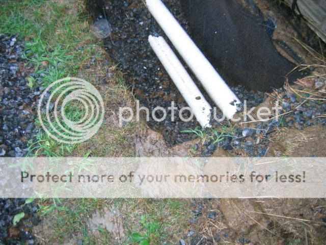

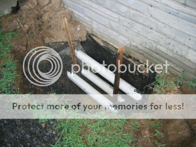

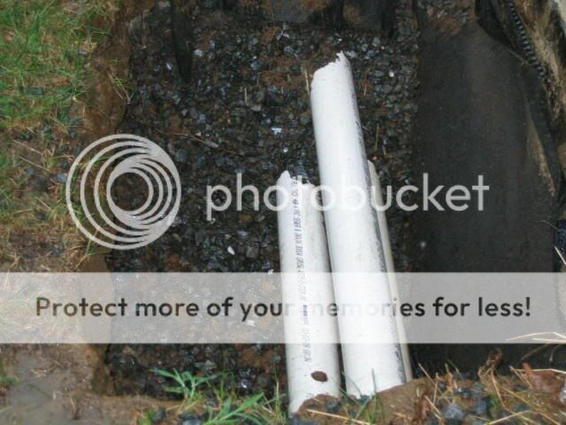

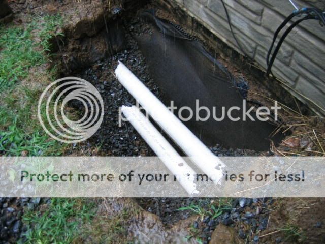

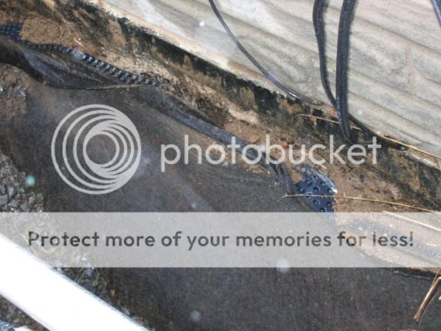

well he took a look at my pics and said he will be back within 2 weeks to manually dig up the rear corner of the house then when it's pouring come over and see where the water goes. He said he's never had a foundation leak after he's dug it and the only thing he could think of off the top of his head was that somehow the water is overwhelming the system and he may put in another yard drain or 2 out back. He had asked me if water was ponding in back of the house
but i really doubt thats the issue. it more seems like somehow it's getting thru the membrane...or around it. I doubt though that water goes down under it, over to the house then up to the foundation though. Maybe it just wasnt dug below the footing like we thought. it's just so perplexing.
here are the crawlspace pics from last year if you'd like to give suggestions on how to fix it. I never posted pics of the job from the outside so maybe i will do that sometime
http://forum.doityourself.com/baseme...e-how-fix.html
also note that the leaks to the left of the window (the one vertical crack between the blocks) is not where he dug up, it's under a breezeway pad and wasnt part of his job. That one will be up to me to fix. he recommended food dye outside the house to try to see where it's leaking in, use my hose and saturate the one low spot on the driveway

When we sealed foundations, we had to watch for 2 things. One is that dirt didn't get behind the membrane when we back filled. That's as good as not having the membrane there at all.
Secondly, we dug below the footing & overlapped the membrane. In other words, there was enough membrane to extend below the footing & horizontally away from the structure. Then we threw a few inches of gravel before we back filled.
Either you have a high water table or he didn't pay enough attention to the area around the footing.
well i dont know if dirt got behind the membrane but i do know that at the top of it, it appears water may be able to get behind it a bit. I'd take a pic but my digital cam is out for warranty repair. i just figured that as long as the dirt pushes it against the house it's ok but i always thought water was the strongest thing in the world and thought maybe it still gets behind all that dirt and stones. also the membrane does go down to the footer and out at least 2-3 feet from what i recall. but maybe he didnt really get below the footer, i am not sure. I cant believe they would do all that work and not do that though. they were very professional about things and even used some kind of laser thingie to ensure the slope was correct to ensure drainage.
however, on the other side of the house i can see the membrane in the same "condition" and i know that side is dry. But i do know more water comes in the back of the house, than the side, because i have a hill that is sloped towards the house So maybe it is overwhelming things.
id have to dig up old pics to be sure but from recollection the series of things went membrane/gravel/pvc pipe (drilled out at 4 and 8 oclock)/more gravel/yard drain pipe/gravel/rain spout drain pipe....but i may not have that right,it's been a year. The theory was that whatever made it to the bottom of the pit would fill up the lowest pipes from the bottom up and be carried away. he said the holes should be placed downward so as to prevent clogging.
If my understanding of a water table is correct, i dont have one. but i'm not sure. in the front of my house is a long stone wall holding back my yard, 6 ft high, then there's a gentle slope up to the house. in back of the house i have about a 8-10 ft level 'grass patio' but then i have a 3 ft block wall 'holding' up my yard (not really lol) and my yard has a decent grade up to the back property line. Bascially if you stand at my back door and look straight ahead to the back, the grade winds up at shoulder level. So i pretty much have about 1/8 acre of a hill draining right towards my house
if that qualifies for a high water table, i guess i have it then. i do know i have very hard clay; however, for their excavation they dug it all out and replaced it with fresh soil and of course tons of stones. It annoyed the heck out of me because they didnt compact it and i didnt know i wasnt supposed to walk on it so to this day i have 6 inch deep footprints from where i was standing to water the new lawn lol. and those footprints do fill up during storms. i dont know if that means anything or not.
one other thing, i know my one side gutter isnt big enough to handle the water on the one side as i see it overrunning during heavy rain. the one side of the roof is huge and i think it's about a 10 ft gutter for all that volume. but it's impossible to add more based on how the house is. However my thought was even during a hurricane all this new drainage should be able to handle this? And in that spot it's not even the worst part of the issue i'm having. the side with the leakiest crawlspace is actually a side with no gutters at all but since no water is directed off the roof that way, they arent necessary.
also on the other rear corner of the house i do have long gutters but that still overflows as well. however that side of the house in the crawlspace IS dry. So that side was successfully sealed.

If the hole is being opened again, you should be able to see if a mistake was made or where the water is entering. Fill the hole with a hose if you can't see anything.
The membrane should come down the wall, then horizontally along the top of the footing, then down the front of the footing & away from the footing along the dirt. It should look like a carpeted staircase. Then the gravel is thrown on top of the bottom most part.

these pics were taken over a month ago after one mini storm, i dont have pics from today:

i realized i forgot to finish up this story
he came back this summer and installed 3 new yard drain
then after admitting his guys sloped the bottom pipe way too much (water had to get over 6 inches high for it to be carried away in some places), he ran a 2nd parallel pipe correctly placed next to the existing pipe...so basically i have double the drainage now
they also went into the crawlspace and saw where water was still coming in and cemented it up a bit for me, but i havent been down there to see what they did
in 09 when they were here, they had run a pvc pipe through the foundation but never finished running the drain from the crawlspace..now they have a drain there so it's literally impossible for any water that does get in to create that 6 plus inches of water i used to have. so he spent an additional week or so on this project and i guess thats more that most other contractors would have done so i'm as happy as possible under the circumstances.
i hope he supervises his future jobs to avoid taking such a hit, he constantly complained how much this would cost him and the economy etc etc. but i kept hounding him until he came back and apparently thats all it took
