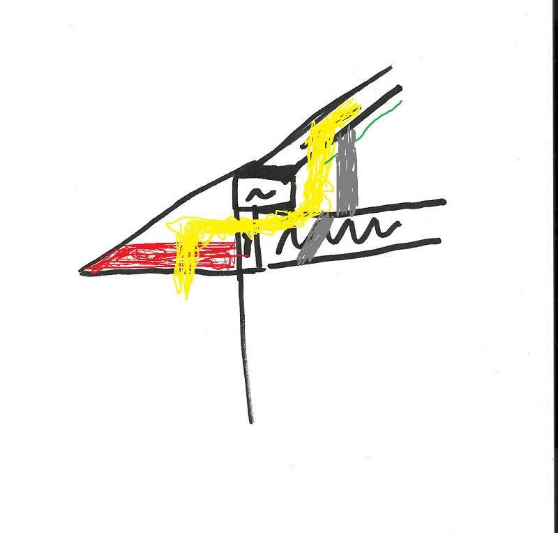

Thanks for the link. But my attic is different from the animation. The one thing that is different is there is a board that runs the length of the house that is tight to the roof and nailed to the plate. And the rafters tie into that board. In the animation where the place the baffle to hold the insulation down thats where the board is so if you were looking down my house it would look like this
this board is tight to the roof
______
|_____|
/__________| |
soffit

[IMG][/IMG]
sorry that its so big.

First let's see if the image loads...
I guess that the red part I added is tails to tie the plywood soffit onto.
Would it be possible to drill 3 inch holes every 6 foot in the plate to allow airflow as indicated by the yellow paint? This board is not as structural as the top plate.
The smaller green line indicates a airflow baffle so the insulation cannot block the air. You would have to block the floor joist and from the floor to the rafters as shown by the gray color to ensure the insulation does not block the airflow.

Thats how I was thinking of doing it, but it helps to see the airflow, it would be possible to every 6 foot just alot of work.
The solid wood isn't plywood its actually wood slats, like a hardwood floor. Just one question I had, you said "I guess that the red part I added is tails to tie the plywood soffit onto" what does that mean? Should I cut pieces of wood to create a "bay" in the soffit, where the vents are going to be?

Because added vents would still have a restricted air flow to the baffles, I would use this; Cor-A-Vent : IN-Vent
A 3" hole with a screen is only 2-1/2 sq.in.NFVA; Lomanco Product Lines You would need to drill them end to end with 1" space between holes to get the required 9sq.in. NFVA per lineal foot! Easier the pull the soffit, cut a 3" slot the length, add continuous vented metal and shorten-then re-install the existing soffit. Of course you still have the constricted air path to the baffles....
Gable vents are not nearly as efficient, but may have to work if not using either suggested method. Certain locations don't require attic ventilation, and color of roof is 20-30% of the cooling effect for the roofing shingles--- venting is only 2-3%; http://www.fpl.fs.fed.us/documnts/pdf2002/rose02a.pdf
