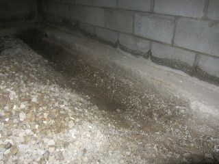

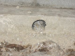

Hello, I have a few other posts out there but I finally dug out the perimeter of my crawl space. The space is un-vented and was built 6 years ago to build an addition which went up before we bought the house. The walls are block, all but one or two at the top are below grade. The floor has a poly layer covered by 6” of gravel. The poly layer stops short about 6” from all the edges, making for a very damp perimeter and overall a damp crawl space.
We pulled all the rock away from the edges, exposing the poly layer and mud below. There was a corrugated black weeping pipe that ran around the 3 exterior walls but it didn’t go or drain anywhere. It was open on both ends. We also noticed two holes in each of the exterior foundations. It appears these go outside but then when I look in it just looks like mud on the other side.
My questions are:
- What are those holes for?
- What was the weeping pipe for if it didn’t go anywhere?
- What do I need to do to make this right?
Thank you!
Before pulling all the rock away:
After:
My questions are:
Thank you!
After:

I'm always an advocate for exposing & sealing the block from the outside first. Then decide if anything is needed inside. I can explain how that's done if you are interested. Most people don't want to bother.
Flexible, perforated plastic pipe is never a good idea for providing long-lasting drainage solutions. It's difficult to install perfectly straight, without undulations, such that fines working their way through the openings will collect inside at all of the low spots, slowing down the passage of water. Especially when installed without any mesh fabric to keep the fines out, as yours appears to be.
Time to yank everything out and properly install some rigid perforated pipe, inside of a mesh wrap. And use washed rock instead of sandy gravel.

Oh, one more suggestion. The picture submitted by the original poster shows me that that block wall has got water sitting inside. If you tile that foundation like it looks as if you should, you need to drill some holes through those blocks on the bottom course to allow the water to run out. That bottom course is saturated.
On the outside of the block wall make sure you drill a hole through the bottom course as close to the footing as possible (through mortar bed joint) and for safety's sake drill another about 3" up or just below the floor level.
Then you want to make sure gravel rises high enough above those holes that the water can escape the walls and drain to the outside tile through the gravel. Cover the gravel on top with geotextile cloth to keep sediment from plugging holes.
For a dry basement (not necessarily a crawl space)you woud drill the inside as well but provide a tube from the hole to the tile gravel inside tile so concrete can be poured across the footing for the floor with out blocking drain from wall.
bs5

Other posters are right - it appears your block is holding water inside. The holes? Not sure, probably some kind of low-point drain to let water out but never done right?
