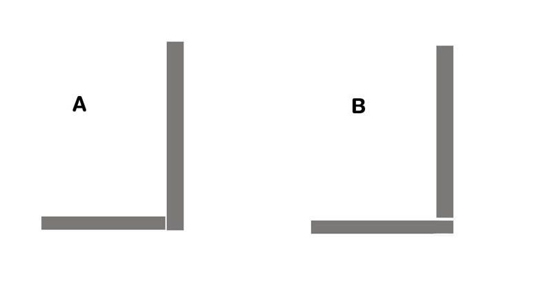

Next question, how is this wall/floor put together? I always assumed that the floor is like "A" below, but something tells me that it's more like "B" below.
So, if I dig out the dirt around the outside of the wall, what product should I waterproof with and how? I'm sure I'll need to clean and score the wall. I'm looking at the 'least expensive' method' (Wife and I are in our 70s, on fixed income) I have a tube of Liquid Nails Roof Repair, which I could use in this case if it would help to waterproof the area.

no 'weeping' or drainage system on the outside of the house
If you have a sump you have a drain field.
Wall construction is more like "a" the walls sit on the footing and the slab is poured inside the wall.
As noted the leak is on the outside so patching on inside really isnt going to do much.

@Marq Ok, now I'm confused. (But trust me, I'm easily confused...lol) The cement walls I have are pretty good at not allowing moisture through, so it would seem to me that (if the walls are like A) that the moisture is coming up from below, not through the outer wall. How do i water proof this? It almost seems as if I'm going to have to dig out and up under the floor slab to seal it somehow, and that's a major project.
Is the alternative just making sure that the area next to the wall doesn't puddle water?

It's more like this.
When you have water coming in from the bottom of the wall it can enter a couple different ways but the outside is most common.
So back to one of the prior question, is your sump system working, did you note if it increased more during the rain?
