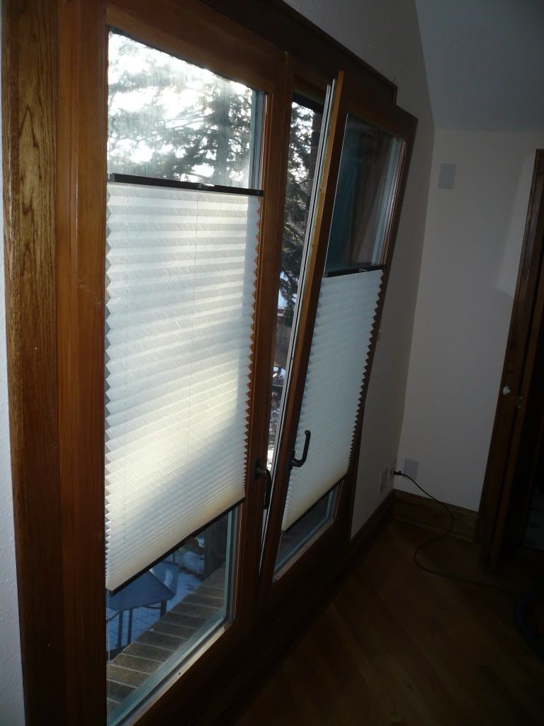

I am looking for blinds or shades made specifically for Tilt & Turn windows. These windows swing in like French doors and also tilt in hopper-style at the top. The only blinds I have seen have been from European sites.
I want something minimal and highly functional that attaches to the sash and has tracks or some other apparatus that hold it flat to the sash even if the window is tilted in. It should be as thin as possible so it won't bind when the windows are open nearly 180 degrees and laying against the wall.
All suggestions welcome, although vertical blinds or drapes that attach to the wall or window frame are not being considered. I'd prefer the current old-bedsheet-and-two-nails arrangement to that.
Photos at
http://s158.photobucket.com/albums/t103/ArgMeMatey/TiltAndTurn/

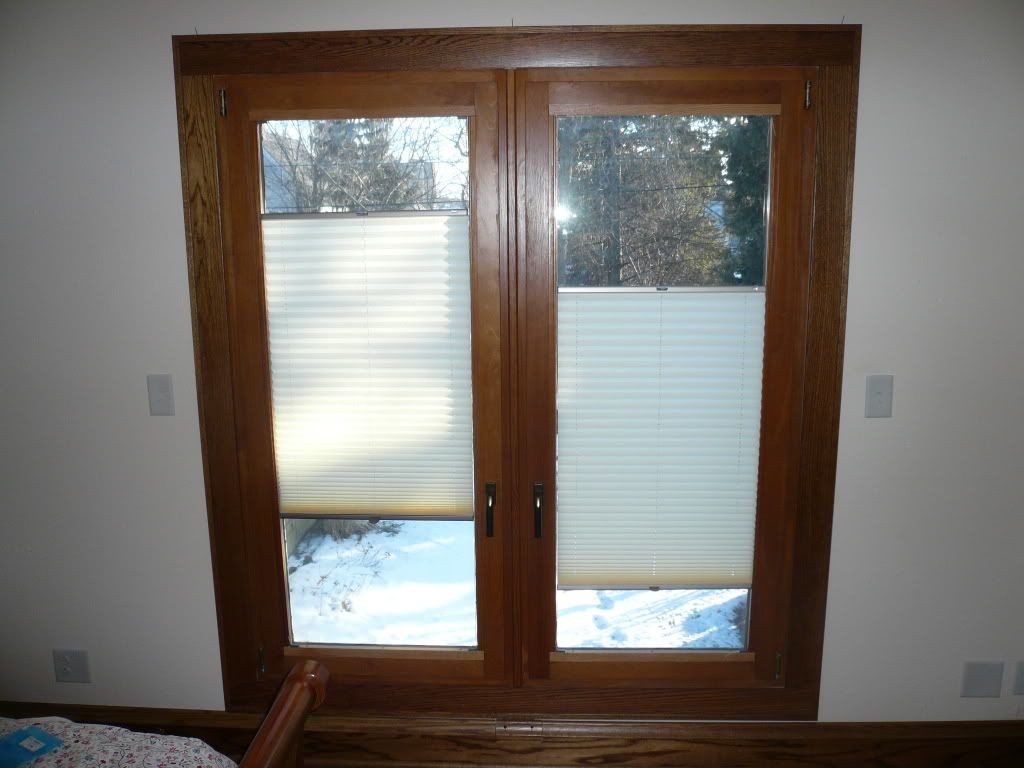

Just adding a photo if IMG linking is now permitted ...

After a long and fruitless search, I gave up. Then out of the blue last fall, a US dealer for MHZ found me and I bought these blinds and installed them. They are exactly what I was looking for.
