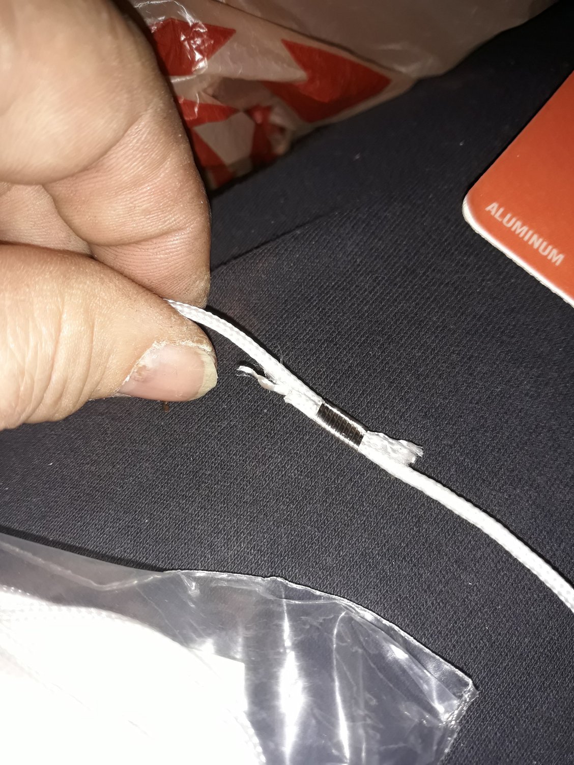

What technique or method would be the best to join the string on faux blinds to extend it ?I already have the extra . Is there a crimp used or maybe a way to sew them together ? I can knot it but would rather not .The squarestring parts that hold the blinds in is also where I will attatch but I can use small wire an maybe some epoxy at 2 corners at those squares since they only turn an dont go thru any holes ...
{these are some big 40 inch by 55 an $150 to replace both so I'd rather extend them 5 inches for a few bucks since I have extra off other blinds.]
i might find something at a hobby store too but wanted some ideas .
thanks .

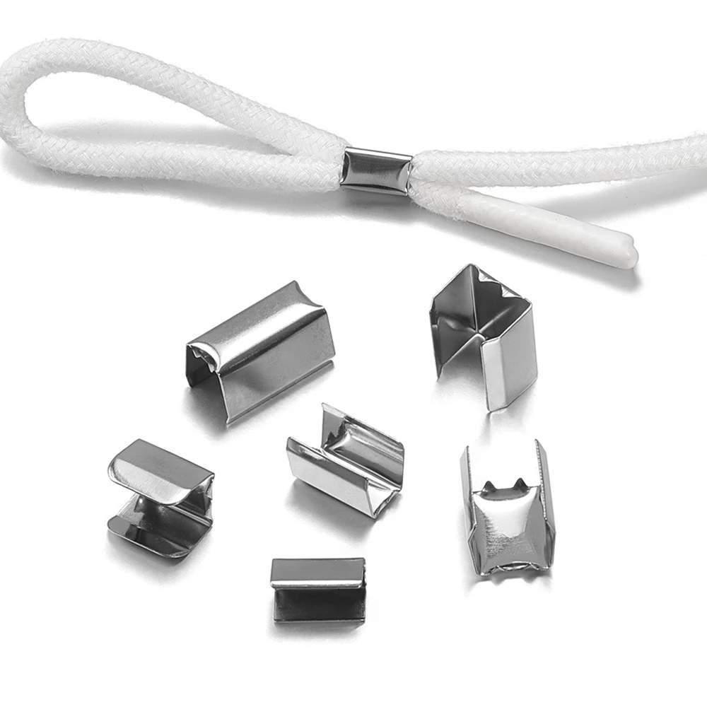

I found these tiny crimps in a craft store an it holds .that's before trimming ends ..
I can mash that aluminum tight an round an it will fit thru holes .I pulled on it an its strong ..
An the wire piece can be looped an twisted to a tiny loop holding the string square opening . Then ends cut.

Those lil crimps work GREAT! an the string can flow thru holes fine an its VERY strong..
worth sharing since these things can run$ 50 - 70 an up ..if anyones strings break this will be a good fix👍 that's before the trim
