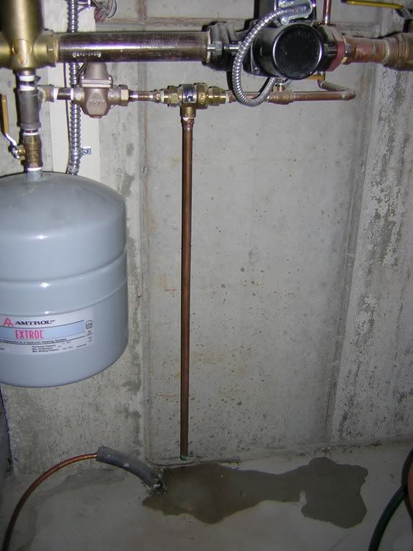

Hi, my daughter turned on the shower and I heard major vibration noise coming from the basement and some swishing sound. I had my daughter turn off the shower and ran down to the basement to look at the boiler (P-WGO-6 Weil Mclain oil boiler). I saw water gushing out of the T shaped pipe. I have an old picture of the T pipe. (The water you see below is not representative of the water that is there now. I think there is a 1/4 inch of water in the corner of the basement.) So, I turned off the boiler and turn off the valve that feed the pipe. I don't know what is wrong. We are going on vacation tomorrow and don't know what to do.

That Tee is a backflow preventer & is supposed to vent water if the pressure on the boiler side exceeds that of the incoming water. These valves do fail but most are repairable with a rebuild kit. Also sometimes, a piece of junk will get stuck under the seat of the valve & cause water to leak.

If you get lucky & the service person happens to have either a rebuild kit or a new backflow preventer, yes. If it were mine, I would not pay the overtime rates for a night call especially knowing it would be a gamble. I suggest you go to your local home center or hardware store & get a 1/2" & a 3/4" pipe plug. Just remove the pipe that goes toward the floor & plug the preventer, using whichever plug you need, until regular business hours.

Am I seeing a pressure relief valve in that line also though ? You could just suffer through a cold shower and wait until you get back from vacation.

That device is not a pressure relief valve to protect the boiler from over pressurizing. It is there solely to keep the boiler water from flowing backward into the domestic water supply.

At a minimum, you will need a rebuild kit for the make & model of the backflow preventer.
You will likely have to drop the boiler pressure to zero unless the reducing valve has a check valve in it & the check valve holds. The chances of this being the case are actually pretty slim.
After reducing the pressure in the boiler to zero, you can take the BFP apart at the unions incorporated into the device. Clean it well, install the rebuild kit, put it back together, & re-pressurize the system.

Is it normal for this type of value to fail? 1/2" 9D-M3 Backflow preventer with Intermediate Atmospheric Vent made by Watts. It seems like a pretty sturdy looking valve. Our house is only about 8 years old. Is there anything else we should check?

I would not say it is "normal" but it is not uncommon. The most common cause of failure I've seen is pieces of rust or sand from the water line getting into the valve & causing it to slightly stick open. Something I have found to help is a simple particle filter installed in the feed water line ahead of the valve. These filters are available at any home center & are easy to install.

Just an FYI. Yesterday night after realizing no one was coming, I had call the oil company that maintained our boiler to cancel the emergency call. But, this morning, they came anyway. The guy was here for less than 1/2 hour. He replaced the backflow preventer (as you have indicated) and charged us $230, 65 for part and 165 for labor. That part cost only $29 + shipping. We know since we were looking to fix it ourselves. Oh well....
