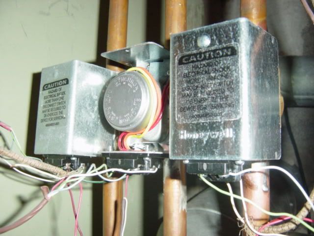

I checked the zone valve and when I put it into the normal position, it does nothing, the switch is just limp, so I guess that the rubber ball that blocks the opening is stuck. Can I pop off the motor and just work the ball around to get it loose or should I go about this some other way? Can anyone offer some insight for my bleeding question above? Thank you all again.

If that zone is not calling for heat, the lever should offer a good bit of resistance to moving. Honeywell had a lot of trouble with motors some years back. Try removing just the motor & see if the lever springs back to the closed position. If it does, replace the motor. If the lever is still stuck you will likely have to replace the whole valve.

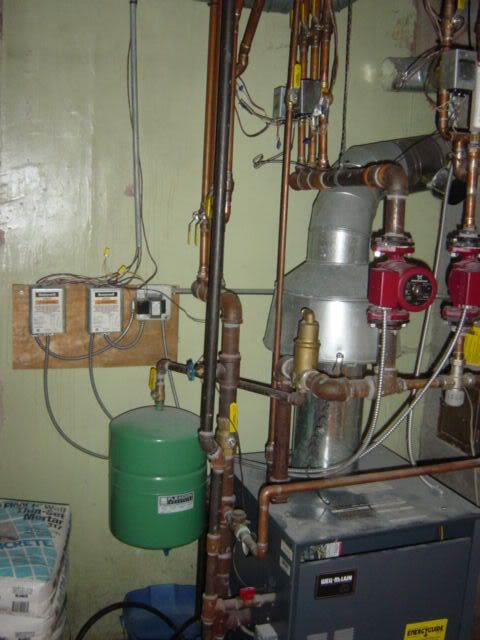

Before I can offer advice on bleeding, I will need to see pictures of the boiler & near boiler piping. You can post them on photobucket or similar photo hosting web site & provide a link here.

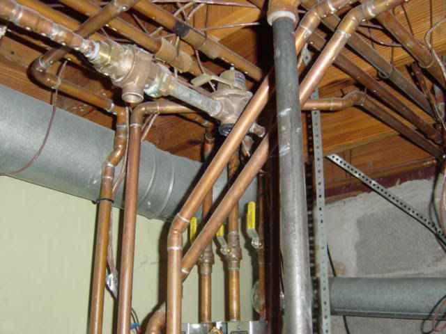

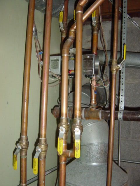

Alright, here are the links to my photos, please let me know the proper technique to bleed this system. I also included a picture of the bad zone valve, can I just unscrew the motor and see what happens (turn of power first?). Also, I have a picture of the press. gauge, it is loose and if I want to replace it, do I have to drain the system? Thank you again!

Good pics, thank you
To replace the gauge, you close every valve you can find, drop the pressure on the boier to zero via the boiler drain at the bottom of the boiler, unscrew the old gauge, & install the new one. By doing it this way, you minimize the amount of water you loose & the amount of air you introduce.
Zone valve: Yes, turn off the power, remove the one screw (quite small) holding the motor, give the motor a slight twist (counter-clockwise?) & it should come right off. You may have to hold or wiggle the manual lever to remove the motor.
Bleeding: After re-reading your earlier posts & seeing the photos, I don't know if air is the problem or not. The air/zone valve noise is usually a bang (water hammer) type of noise & those spirovents (brass part in front of boiler exhaust pipe) are usually very good at removing air as long as the cap is left loose. The pinging sound is likely just heat expansion of the pipes, especially the baseboard. Bleeding could make matters worse.

Thank you very much for all of your information. I am still worried about the clanking and occasional banging, it worries my, I don't want to spring a leak anywhere because of it. Just for future reference though, what would be the proper method for bleeding this system? Is the way I mentioned earlier correct? Thank you very much again.

Turn off power. Lock open all zone valves. Close all yellow handled ball valves for the heating loops & the large yellow handled ball valve below the hose bib (see pic 00002). Open one supply & it's corresponding return ball valve. Connect a hose to the hose bib (blue hand wheel behind gas pipe in pic 00002). Allow water to flow until you get no more bubbles. Repeat for each zone in turn. Restore system ball & zone valves to their normal positions & restore power.

I switched out the motor on the zone valve and now everything works fine. I am still getting all kinds of noise throughout the house though. At times there is even some loud banging, it is very worrysome. Do you think then that I should not worry about it? Also, thank you for the instructions on bleeding, but I wanted to ask, do I need to open the pressure reducer valve when doing it? Thank you very much for all of your help!
