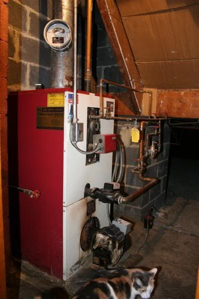

I have a Columbia, boiler which has started making alot of noise when the circ pump runs. Its like poping noise going through the baseboard radiators (copper with aluminum fins). I have also noticed that when the unit shuts off there is a sound that seems to be an air bubble rising in the boiler. The link is pics of the system. Any help on resolving or fine tunning my system would be great.
http://s162.photobucket.com/albums/t257/john2050_photo/

Not seeing any way to purge the system at the boiler, I have to presume there are bleeder valves on the baseboard. Remove the baseboard ends & look for small valves, usually with a little spout on them. These valves are usually operated either by a screwdriver or radiator key. Open the valve & allow water to flow until there is no spitting just a steady flow of water.
I don't see any way to drain the expansion tank either... it looks like there's a gate valve in the line, but shouldn't there be a drain at the tank ? Looks like just an elbow coming off there, is it ?
Nice pictures to look at.
No that long ago (a few months), I heard the godawfulest racket radiating all over the house, and found that one of the motor to circulator pump coupler springs broke. I removed the motor and made my own spring for like 15 cents and got er installed and have been back in business ever since. Runs quieter than a church mouse.

Thanks for the replys. I have bled the basboard rads till its a steady flow of water. I have approx. 4 bleeder valves and no air from any. Did you notice the pressure. When the pump turns on it doesn't drop below 26psi (split level house Boiler is in the basment). However, I don't know if thats the pressure for the boiler or for the domestic hot water? Could my expansion tank be full? I think there is a drain for the boiler? If you look at the boiler pic, you will see spigot with a red handle. I assume thats the drain.
The expansion tank on the right side has a plug, should I put in a drain there? Anything about the sound of air when the boiler kicks off? Its makes a blup blup sound. Wish I could explain it better. Thanks for the help.
John, I think a first step would be to verify if that pressure gauge is actually functioning properly. (it is the boiler pressure by the way). You can get a pressure gauge that screws onto a hose fitting at HD or L*%3s for a few bucks. May not be the most accurate, but adequate for the purpose.
You _could_ put a drain valve in that tapping, and even though it's not the lowest point of the tank, you would get enough water out to do the job. Be advised though, once you pull that plug (IF you can get it loose!) there's no going back. You've got nasty dirty red/brown/black water coming at you. So, if you decide to go that route, be prepared to catch that water that's gonna drain (quickly! at first).
You don't want to drain the expansion tank through the boiler drain, if that's what yer driving at ... won't work.
The "blup blup" you hear could be bubbles of air finding the high spots after being circulated in the system. If yer lucky, they are going into the expansion tank, where they belong.

What is that whitish deposit to the right of the pressure gauge ?
If the gasket around the tankless heater coil is leaking, you want to have that looked at and repaired.
See that plug in the bottom of the air scoop ? Removing that will allow you to hang a modern diaphragm type tank right there (if you didn't wanna mess with the old tank).
It's hard to tell from the pics: Is there room above the scoop to add an automatic air vent ?

Ok so I put a gauge on the drain and got around 20psi. So the gauge is bad and the pressure is ok. I guess all the pinging noise through the baseboards is expansion? Boy is it annoying, especially at 4-5 in the morning. Any way to curb it?
As for the white deposits, it must have leaked at one point. It was like that when we bought the house 2yrs ago and it has been fine. There is some room above the air scoop. How big is an automatic air vent. Would that help any? I thought the air scoop is to pull air and in my situation pass it to the expansion tank?
John, the automatic air vents are probably around the size (or smaller) of a can of Red Bull ... You could probably remove that small chrome manual bleeder on top of the air scoop and install the auto-vent right there. If you did that, you could just leave the old tank and piping alone.
When you measured the 20 PSI, was that with the boiler hot ? Keep an eye on the gauge and see if you can get an idea of how much the pressure swings.
Yes, the air scoop catches the air and is supposed to pass it to the expansion tank, where if this were a perfect world, it would stay. Problem is, it doesn't stay. The air is constantly moving in and out of the water with pressure and temperature changes of the water.
If you were to install a modern diaphragm exp tank on the bottom of that scoop, and the auto vent on top, the air would be vented out and not be in contact with the water in the tank.

That manual air vent is there for a reason. Do not install an auto vent with a conventional expansion tank. Doing so will cause the tank to become flooded over time. I agree with Trooper on his suggestion of replacing the conventional tank with a bladder type & adding the auto vent.

If the link below is a conventional tank with a bladder and an auto vent then there is no way that will fit without moving the piping. That room is just too, small and and I would smack my head on that who knows how many times?
The pressure swings about 3-4 psi from off to on.
So what is the purpose of the manual vent on top of the scoop? When would I have to use that to bleed air out if the scoop is functional?

Yeah, that pic is pretty much what we're talking about. You don't however have to put the tank directly underneath the scoop, it can be attached at that point with some piping, as your conventional tank already is, or could be piped elsewhere on the system.
But, if you can't/don't change-over, you should go back to thinking about draining your existing tank.
That manual vent is probably used as a 'purge' station when filling the system with water. If you had to drain it to service a pump or valve or something, it could be used to vent air as the boiler is filling.
If you keep the conventional tank you don't want/need an auto-vent.

Ok I know its been a while but tomorrow I plan on changing out that Temp/Pressure gauge and I also bought a coil gasket so I might as well tackle that, too.
So my plan is to label the wiring to and from the aquastat so I can remove the wiring so I can remove the cover (of course after draining the system). I plan on cutting the horizontal copper to the coil so I can pull the coil plate (which I have been spraying with liquid wrench to help loosen up all the bolts) off. Once that is off I plan on cleaning the the coil housing with steel wool and replace the new gasket and gauge.
Once completed I plan on adding a union so if I have to change the gasket again it will be as simple as unscrewing the two unions and wala.
Any tips and/or advice to help out will be appreciated. Thank you!!

Ok So I gave up trying to remove the nuts. They just wouldn't budge and I really didn't want to see those bolts break away from the housing. So I stopped and will continue to spray those nuts and bolts with liquid wrench and try next week. Any recommendations on a good penatrator that I could try? And that coil plate is at 180 should I shut the boiler off the night before so the temp isn't so high?
Oh and when I drained the boiler it filled about 1/2" of a 5 gal bucket. I think I should have had a lot more water than that?

For penetrating oil I use a product called Part-Ease. Others on this forum recommend a product called PB Blaster. I have never had much success with Liquid Wrench.
Absolutely shut down the boiler the night before to allow it to cool.
You got so little water out when you tried to drain the boiler because it went into a vacuum. You need to open a vent somewhere to allow air into the system and break the vacuum to let the water out.
You may end up having to split the nuts to remove and then "chase" the threads on the studs. You may purchase a nut splitter and the thread chasing die at an automotive parts store. The automotive parts store is also a good place to look for Part Ease.

furd, thanks. I figured that out right after I hit the submit button. I opened up one of the vents on the baseboard and the water started to flow. I'm going to look for the penetrating oil you mention.
Since I don't need my heat can I leave the boiler drained? There is some plumbing I need to remove like the plumbing that goes through my fireplace then connects to the basboards. I had a very hot fire and I think it created steam and all the copper in the boiler room were violently slaming against the walls. Not a pretty sight. I also need to remove a baseboard in a room that I'm redoing.

Rust would be my worry about leaving it drained for any period of time. You want to limit the time it spends empty unless you can absolutely blow out every last trace of moisture in there.

If you want to remove the oil burner and place a light in the firebox (about a 100 or 150 watt) it will keep the boiler relatively dry and rusting will be negligible. A small radiant heater would also work.
Commercial and industrial sized boilers are often left open for months with little or no rust.

I am not familiar with the Part-Ease Furd mentioned but PB Blaster is one of the best I've used. I've never had any luck with Liquid Wrench either. You are going to need a lot of luck getting those nuts off. A very time consuming technique I have used a time or two is to cut the nuts with a moto-tool grinding wheel. I don't think you going to have room to use a nut splitter but it is worth a try. Of course there is always the blue wrench.

Ok so what did I get myself into? So I started this afternoon trying to remove those damn nuts and sheared off 6 of the bolts, too. So luckily Columbia Boiler isn't far from me and they sold me some bolts and nuts. So I tapped the new ones but I have a few questions. If you take a look at the pics you can see how corroded the area is where the gasket sits. How would you recommend cleaning it all up? Also when I tapped the threads for the bolts I have 2 that isn't very level and the bottom of the nut touches the coil plate but at the top there is a gap. Will I be ok? Thanks for your help and I'm done for the night and will back at it tomorrow.

Bad Luck Johny
First you get drenched in black, stinky water. Now studs snap off. What next?
Sounds like some of the boiler jobs I run into.
Clean the mating surfaces with a wire wheel. Get some high temp silicone & put a bead around the whole perimeter of the boiler opening inside of the studs. The stuff I use is in a gold colored tube & usually comes with replacement coils. Follow the directions on the tube. By using heavy washers, you should be ok with the crooked threads but if you are not, take the coil back out & drill & tap one size larger. Good Luck

I have been soaking those nuts and bolts with PB Blaster for about a week. I started to loosen the first nut and it started coming off. I worked it slowly back and forth then I started to just loosen it and it snapped. I was able to save 4 but after looking at them, the base of the bolts were very thin so I cut 2 off and tapped those. What a nightmare. Mental not, when its that bad just ignore it
I guess I can pick up Hi Temp Silicone from a plumbing supply store? Oh and I know that some metal shavings feel inside the boiler. I guess I need to vacuum out the little bit of standing water and also get all the shavings that fell in, correct? Again Thanks.
