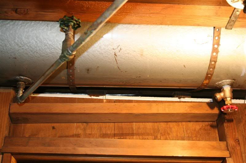

On some expansion tanks, there are two side holes that are npt threaded to except a sight glass configuration. Is it possible for you to post a pic so that we can get an idea of what your tank looks like, then I can tell you what they are for. Still kinda odd that you dont have a main drain hole on the bottom of the tank to allow you to thread on a ball valve to drain the tank directly. Please post pic.

my tank didn't have a drain either and I had to drain my system through the boiler drain.
Then I added a drain to my tank.

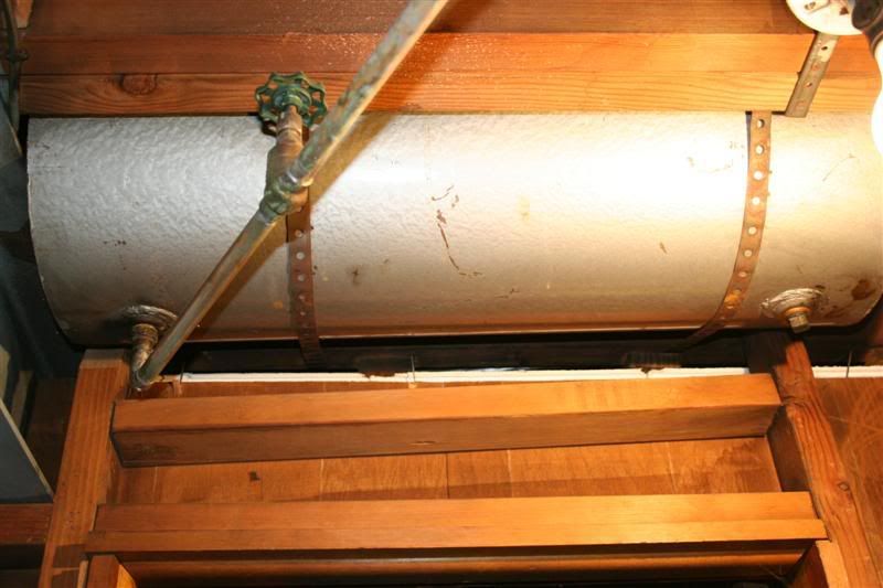

Is this a pic of the new tank installed or your old setup? If you still have 2 holes on the bottom on the new tank like you have in this pic(1 for water make-up and 1 for drain) then the side holes most likely will be for a sight glass so you can see where you level is in the tank. They are VERY handy to have on the tank so you can take away the guessing game of where your water level is. Can you take some pictures of your new tank, or is that what the pic is showing, already installed?

chitown, I belive those are pictures of John's tank, as an example for crhowell ... I guess a sight glass would be nice, but why not just drain it once a year at the start of the heating season ? I've never seen a residential tank with a glass on it.

"...If I understand these pictures correctly, I see that he can manually fill the tank..."
Well, yeah, sorta...
That valve is there ONLY to isolate the tank from the system while draining the tank. It serves no other purpose. It's either full open, or full closed.
The water level in these conventional tanks is not 'adjustable' in that as I said in previous post, it will find it's level based on size of the tank, and pressure in the system. After you drain this type of tank, close the drain, and open the isolation valve fully, water at system pressure will enter the tank and compress the air in the tank to whatever the system pressure is set to.
