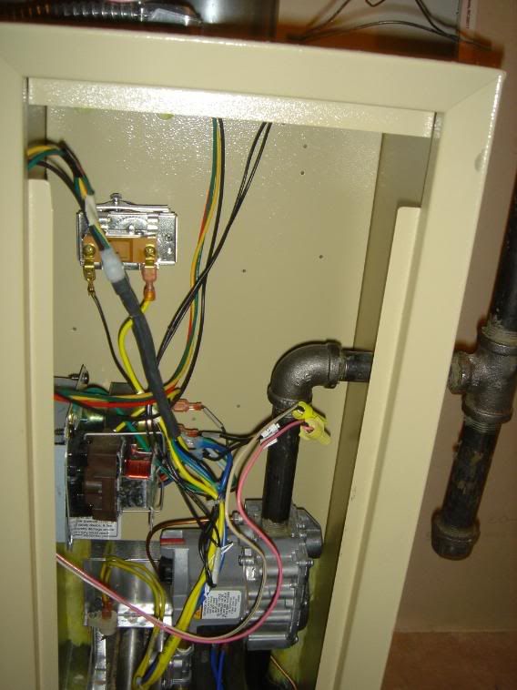

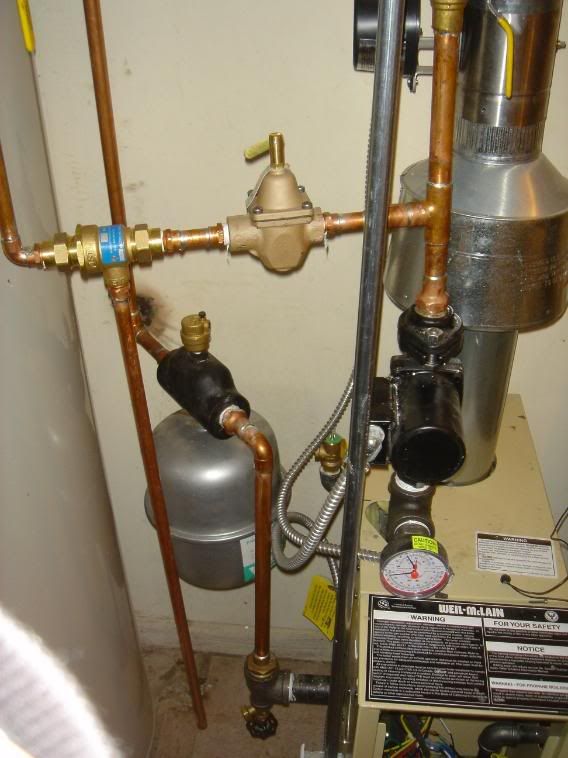

Hi Who,
it is a brand new boiler - its less than 1 month old, the person who installed it for me doesnt seem to be knowledgeable enough about these... Its a long story between me and this plumber who put it in for me... but anyhow, i have to pick up whatever that is left off now..
I am not sure where is the safety valve? I have uploaded some pictures.. canyou take a look please?
http://i218.photobucket.com/albums/c...7/DSC04903.jpg
http://i218.photobucket.com/albums/c...7/DSC04902.jpg
http://i218.photobucket.com/albums/c...7/DSC04901.jpg
http://i218.photobucket.com/albums/c...7/DSC04900.jpg
http://i218.photobucket.com/albums/c...7/DSC04899.jpg
Thanks,
Tak

I am not too familiar with boiler stuff - but i am pretty handy... (dont do plumbing usually, usually do alot of electric work...etc...) and i am not sure of where these relief valve is..etc... I have uploaded some pictures,
can you tell me where each component are, and walk me thru it?
Also, at the expansion tank - there is a opening thing, like where you pump air into your tire - what is that for? Is that for bleeding air out of baseboard heaters?

you want to have the boiler high limit set to 180 degrees F. the low limit is a 20* preset drop off of the high limit.
On the bottom of your return line on the left side of your boiler is a drain valve. You will need to attach a hose or place a bucket under there to get the extra water you have in your system out of there. to do that you need to shut off the yellow handle ball valve to the left of the auto feed valve. drop the boiler down to around 9-10 psi then close the drain valve.
now the tannish colored valve with the screw type lever on top is the auto fill valve. The nut locks that adjuster in place and needs to be loosened first. You want to turn that screw lever on the valve counterclockwise until it stops feeding water at 12 psi cold boiler then lock the nut. you will need to turn the yellow handle ball valve back on once you have the extra water out of the system to adjust the auto fill

the boiler should be off and cold when you setup the auto fill.
If you turn the the auto fill screw lever counterclockwise a few full turns before opening the ball valve you will be
close to where 12 PSI cold will be. If you listen carefully you can hear the water going through the fill valve. If the boiler gauge goes past 12psi then you know the valve still needs to be adjusted down. If the psi stays lower then 12 you turn the valve screw clockwise a little at a time until the boilers pressure gauge reads a steady 12 psi.
The top needle on the gauge is the pressure. the inside numbers are in pounds. It looks like your at around 25 psi (Hard to read) At normal operating temps you won't get near 25 psi more like 15-17psi
you dont set the low limit it automatically becomes 20* lower then the high limit which you will set at 180*
You are at 25 psi there is an enlargement button for veiwing those pictures

on that model you may have to remove the lever assembly by unscrewing it, then turn the screw that's located under the lever. The lever is for fast filling the system and manually bypasses the autofill
