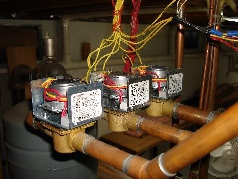

more info; pics uploaded
Ok, uploaded pic's.
http://i227.photobucket.com/albums/dd171/ctfl1/11.jpg
http://i227.photobucket.com/albums/dd171/ctfl1/6.jpg
http://i227.photobucket.com/albums/dd171/ctfl1/3.jpg
http://i227.photobucket.com/albums/dd171/ctfl1/2.jpg
http://i227.photobucket.com/albums/dd171/ctfl1/1.jpg
http://i227.photobucket.com/albums/dd171/ctfl1/4.jpg
http://i227.photobucket.com/albums/dd171/ctfl1/10.jpg
http://i227.photobucket.com/albums/dd171/ctfl1/9.jpg
http://i227.photobucket.com/albums/dd171/ctfl1/8.jpg
If i've figured out photobucket correctly these should be direct links to the pictures.
The valves are directly after the expansion tank on the hot side of the system, and yup they're hot enough to burn, found that out quick.
#11 shows the underside of the three zone valves
#6 shows the top side with all three motor assemblies on
#3 shows the left motor assembly removed
#2 shows the top adapter plate with the shaft turned all the way counter clockwise
#1 shows the top adapter plate with the shaft turned all the way clockwise
#4 shows the manufaturer info on the motor assembly
#10, 9, & 8 show larger views of the plumbing.
in #9 you can see four return lines in front, one of the zones is spit into two, these all come together into one line and then you see the circulator pump at the bottom of the picture. The circulator pump for the hot water tank is behind the boiler out of view. On the top right of the boiler you can see the outflow pipe coming up to the expansion tank, the line that's t'd off right after it comes out of the boiler is the line to the hot water tank, after the expansion tank the line splits into the three zone valves, the first one is a 1" line (which I assume is the one that splits into two return lines somewhere in the system) this one is working ok, the two behind it are 3/4" lines, these are the two that are not shutting off. As you see in pic's 2 & 1 no matter which way the shaft is turned the pipes on the outflow side of the valves remain scalding hot and the baseboard radiators put out heat.
Thanks again for all your help, Jeremy.

In pic's 11, 6, and 3 the 1" pipe that seems to be working properly is all the way on the right. The pipe after this zone valve is cool when the zone is not calling for heat. When the thermostat calls for heat the zone valve opens, turns on the circulator, and the pipe after the zone valve gets scalding hot. After the thermostat turns off, the zone valve closes, the circulator pump turns off and the pipe after the zone valve cools down again after time. The middle valve in the picture does all the same except the pipe after the zone valve always stays warm to hot. It never cools down even when that zones thermostat is off. The valve on the left does all the same as #2 except the pipe after the zone valve is always scalding hot and the radiators in this zone are radiating heat. Even after that zones thermostat has been disconnected for days. It would appear that the valve inside the body of the left valve does not shut off the water flow when the zone valve turns off; the middle valve appears to be leaking by but not fully flowing when it turns off; and the one on the right appears to be doing what its supposed to
Everything I see so far looks just fine. I wish my system looked so good !
Can you get some shots of the connections to the water heater ?
I highly doubt that system is 'ghosting' ... you are probly correct that there's some problem with the zone valves. BUT... that amount of travel on the shaft looks like durn near a quarter turn to me. I think that's about right. There just might be some debris under the ball seat, or when they were installed they used too much heat and damaged the ball. I don't think you need to replace the bodies, but I'm willing to bet if you drained the system and opened them up you'd find your problem right away.
Check this out: Patriot-Supply 8043 parts
I can't see where that gear appears stripped... could just be normal wear and tear ... I mean, it's still opening and closing the valve, right ? even thought the valve isn't sealing shut ?
I'm going back to look at the pics some more... might print one out as a 'pin-up' !
---editorial comment unrelated to the problem at hand---
You want to make an improvement ? (I'm gonna sound like Grady, watch...) Get rid of the zone valves and install three circs, each with an integral flo-chek valve. Get a four zone Taco panel, snip-clip, heave ho the lo-voltage wiring.
The ONLY nit-picks I can do on that install is the fact that it's not set up to 'pump away' from the expansion tank, and replacing the zv's with circs would take care of that. Also, on the return manifold, there are four valves... are those drains ? or shut-offs ? either way, there really should be BOTH, to allow proper purging of the loops, but like I sed, I'm nit-picking so ignore me.

It is quite odd for valves to eat motors as yours is doing. I may replace half a dozen motors a year out of hundreds of systems with Honeywell zone valves. The discoloration around the valve stem concerns me but I don't see any corrosion as if the stem seal had been leaking. One thing which will cause trouble is uneven tighening of the powerhead onto the plate or the motor being crooked for some reason, such as the plate being warped. I can't help but think there is a problem with the valve body &/or plate. Another thought: Check the temperature of the boiler. Those valves are rated for a max of 200º.
The reason those zones are hot is with the valve head removed, there is no spring to hold the valve closed.
Trooper is right. If you remove that plate, water is going to come out. He's also right about my feelings toward zone valves in general. I would second his suggestion about doing away with the zone valves but that is not likely to happen under contract.

well the first no no was to install the valves horizontally with the heads up on the output side of the boiler. The heads with the electrical componets are on top at the hottest point working like heat syncs. That's one reason why you have been going through those motors. It would be better to have the heads located under the valve bodies on that type of installation.
There are no isolation ball valves installed on either side of the zone valves to allow you to service the bodies without draining the entire system. Always spend the extra 15 bucks in ball valves to isolate each valve body on installation
The valve body access plate in the picture looks like it has taken a lot of heat as the metal is discolored. Does the valve lever turn easy or does it feel tight?

additional pic's
Here's some more pictures of the system and plumbing.

After reading Grady's post that the valve will not close off without the motor unit spring holding it off I took a pair of vise grips and clamped them onto the shaft, turned it closed, and then pinned it there with pressure. That seems to have turned off the zone. The pipe after the valve is now cool and there is no more heat radiating from the radiators on that zone. So it would appear that the ball inside the valve is working (although I did put strong pressure on it with the vise grips, I don't know how much pressure that ball should receive from the motor spring). Still the question remains as to why the gears keep stripping out on the motors. I'll get a new motor assembly this week and put it on. I'll keep you posted as to what happens
Jeremy.

OK, knock one of my nitpicks out the window, you do have shutoffs and drains on each return... good !
Why have you got a triple aquastat if you are running an indirect ? You aren't using the tankless coil, at least I don't see any piping to it. Was the indirect added later ?
OK, this is only a MAYBE ... I see that the indirect circ is piped off the supply side, that's OK, BUT... I wonder if it's creating enough suction to pull the zone valves open and cause flow through the heating loops in the opposite direction on an indirect call ... could be ...
I see what looks like a check valve on the return from the indirect, so when the heating circ runs, you don't get flow through it, but the opposite might not be true. You might need to have some flow checks installed on the heating loops. maybe...
edit: Yanno, the more I think about it... that ball in them valves is just being pushed against the seat by a spring. When the heating circ is running, and a zone is NOT open, that ball will only be pushed harder against the seat. But, when the indirect circ is running, and there is suction on the supply side of the zone valve, it probably can easily pull it open.
Is the indirect circ wired as "priority" somehow ? In other words, can the indirect circ run, and a heat call from the house still cause a zone valve to be opened and the heating circ to run ? Or will an indirect call tell the heating to 'wait until I'm done' ?
Jeremy.
Jeremy.
Vise grips?!?! Strong pressure? I think you've found why the gears are stripping. How much torque is needed on the good valve's stem to operate that ball valve? That don't sound right to me. Maybe Grady can chime in.
Pete

Strong Pressure
Those springs are pretty stout but I don't think it should require "strong pressure" to keep the valve closed. If someone were so inclined, it would not take a lot to determine how much pressure those spings exert.
After several motors, I would be inclined to replace the entire valve, body & all.

Hi guys, thanks again for all your help.
bear with me, i'm a jack of all trades and have mastered some, although this one i'm still learning
The easy one first... all three valves stems operate freely. However to stop the flow past the valve on the left I clamped the vise grips onto the shaft, then when the shaft stopped turning freely on the closed side I twisted a little more with the vise grips to get the ball to seat as tight as it could.
Now the learning curve... I'm assuming that the triple aquastat is the controller on the front of the boiler? That's going to be out of my understanding until I learn more. Is the tankless coil the hot water heater? And is that what you refer to as the indirect? I just went and studied the piping on the system a little more and I think I'm starting to see where a problem may lie. The hot water tank line is T'd off right after the outlet from the boiler. That line has it's own thermostat inside the hot water tank and its own circulation pump. The return from the hot water tank is T'd back in just before the in line to the boiler. So if I'm figuring correctly... without any sort of check valves in the radiator zone lines ( I don't see anything that looks like it would be that sort of thing ) then when the hot water tank zone runs it could potentially suck and push water backwards through the radiator zones. Would adding flow check valves solve that potential ? As far as the indirect having priority over the heat zones I don't know. That seems pretty sophisticated for that little mechanical control box on the front of the boiler. I don't see any circuitry that says it could actually think like that or any settings to make it do that. So I would have to say no, it doesn't have any priority. I'm actually pretty sure that I've witnessed both running at the same time.
For reference; pic 16 shows the line for the hot water tank leaving the boiler. The circ is in this line just before it goes into the hot water tank. pic 19 shows the return line from the hot water tank coming behind the boiler. pic 20 shows the return line T'd back into the return to the boiler just below the circ pump for the heat zones. Is this a typical sort of set up for a hot water heater connected to a boiler?
Thanks,
Jeremy.

I don't think you have a tankless coil, or at least it isn't hooked up. Don't worry about that.
The indirect appears to be that blue tank next to the boiler. Isn't it an Amtrol BoilerMate? That is what makes your domestic hot water.
Before you get carried away installing flow checks, why not test the therory? Here's how: Turn all room thermostats all the way down & leave long enough for the pipes to cool. Turn on the hot water to the washer or bathtub & just let it flow. When the boiler fires to make domestic hot water, allow it to run for a while & start feeling heating loop pipes. If you feel heat going out toward the rooms, maybe it's time to look into flow checks. Be sure to check both supply & return sides some distance from the boiler.

And my guess is yer gonna feel the returns getting hot first...
Jeremy, what you explained about the pushing and pulling was what I was trying to say in post #23, and also why I asked to see the piping to the indirect. My gut is telling me that the indirect circ is pulling enough suction to cause flow past the zone valves. You may also have damaged balls too ... (minds outta the gutters boys) ... so you could be looking at two problems. Maybe if the valves were not damaged, you would get a better seal, and the indirect wouldn't be able to force flow in reverse past them.
But, do Grady's test... let it all cool down and see what happens when you cause the indirect to call for heat.
And then, work the other way... turn all stats down, let the loops cool... call for heat on ONLY the one that DOES seal properly. Do you get heat in the other two zones also ?
I think it will help greatly to know if it's ONLY when the indirect pump is running that you are getting unwanted flow, or if it's whenever ANY zone is running. That should narrow down the problem some.
Let's go all the way back to the beginning... why were the powerheads replaced the first time ? Same problem you have now ? The gear in that pic doesn't look stripped to me. When I think 'stripped' I think all chewed up with no teeth. What I see looks like just a little bit of wear on the teeth. I wonder if there were no reason to change them in the first place ? Did replacing the powerheads ever actually FIX anything ?
Yes, your aquastat is that control box. That round plate behind it is where a 'tankless coil' would be mounted. A tankless is exactly that... no tank. It's just a coil of pipe inside the boiler that exchanges heat to the water as the water flows through the coil. No storage at all. Are there any pipe nipples on that round plate ? Tankless coils are the worst way to heat water, your indirect is the best. But, if there are no nipples on that plate, then I'm surprised that you have the type of aquastat that you have. Your boiler stays hot all the time, yes ? That's because that aquastat is designed to do that so that if there WAS a tankless coil installed, the boiler would be hot and hot water would be available to the house.
You would have to have another control box somewhere to set up the 'priority' for the indirect. I wondered if there was something out of view of the pictures. No, you probably don't have that setup.

Priority can be done with a SPDT relay. N/C would power the transformer for the zone valves & N/O would go to the aquastat on the indirect. Crown used to have it in one of their install manuals. Either for the CT series or Megastor indirect. Can't remember which right now or it may not even be there in newer versions of the manuals.

work that vise grip back and forth like that a few times to clear it.
It sounds normal to me that you need a lot of pressure to hold the valve shut when the circulator is running. Push the manual lever and feel how much pressure is needed to move the lever to the manual lock. Between the motor and the spring there is a lot of resistance.
I don't think the indirect plumbing is giving you the problems. Time to replace the head and not just the motor if the valves are not staying closed.
As I said before those valves don't like heat. these motors and end switches go a lot on those heads. The heads would last much longer being underneath the valve bodies even though honeywell doesn't suggest doing so. Even if you could install them on their side would help.
The best solution would be to move them to the return side and put isolation valves on either side of the valve bodies.
The airscoop back is all cast and black iron and holds the heat very well

The company for which I used to work installed dozens of Energy Kinetics System 2000 boilers. Every single one of them had the zone valves on the supply side although the valve body was verticle. Some of these boilers have been in 20 years or more & I can't recall having to replace more than one valve, motors yes but not valves.
grady
the electrics on the valve is what doesn't like the heat. the valves are pretty reliable
honeywell has made a bundle out of selling replacement heads for their valves
