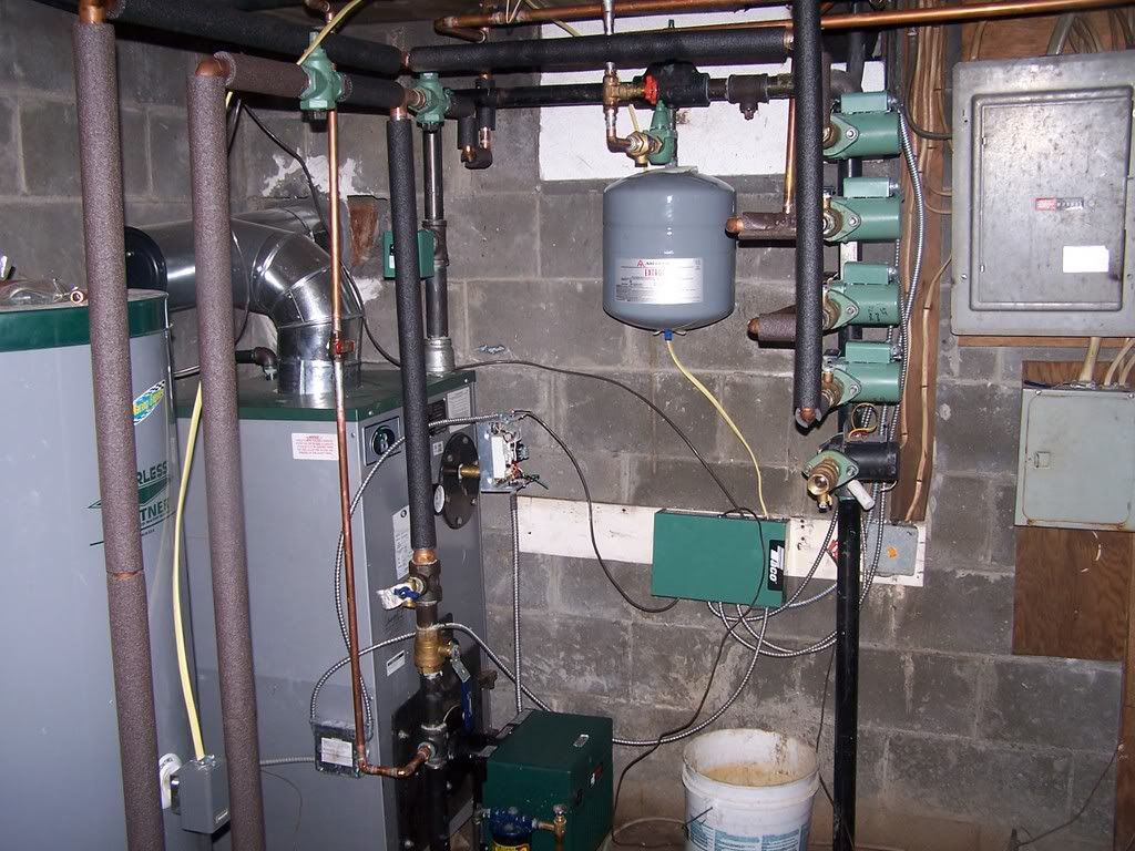

Location: islip ny
Posts: 151
http://www.myhomeheating.com/contrac...passpiping.pdf
here is a good example of my setup but i have 5 circs for 5 zones. now could i just add this bypass loop with a 3way valve? i understand it with 1 zone just not how it would work with 5 or i amPhoto Sharing and Video Hosting at Photobucket just over thinking this.Photo Sharing and Video Hosting at PhotobucketPhoto Sharing and Video Hosting at PhotobucketI i know i have to fix the wiring and the flue i am waiting on the eletrician friend of mine to do a neat job and a weekend to fix the flue and hopefully add the bypass.
  #27
Old 12-03-07, 05:30 AM
T
Join Date: Oct 2007
Location: islip ny
Posts: 151
if i add in this pipe like i drawed would that be fine for bypass loop? i lieft a link also to the website with the same setup as i have!
  #28
Old 12-03-07, 08:44 AM
boilersrus's Avatar
Join Date: Nov 2007
Location: Long Island, NY
Posts: 313
I make pretty good spaghetti sauce for the spaghetti you got! Just kidding, but I couldn't resist. hehehehe
  #29
Old 12-03-07, 09:27 AM
Join Date: Aug 2006
Location: usa
Posts: 902
barometric damper
That barometric damper is installed incorrectly. It should never be installed in a tee in that fashion. Also, the factory collar is advised to maintain the proper B dimension from the flue pipe. The Field instructions, and most boiler instructions, show how to do it properly.
Peter
