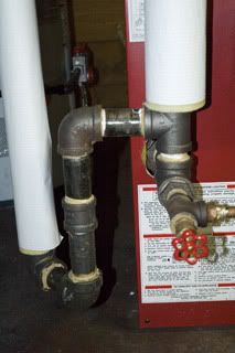

BRN, you really should post some pictures of the system and all the near boiler piping. Everything else is just guesswork.
You can post pics on www.photobucket.com for free, and provide a link here so the steam heads can see what's wrong.
I'm kinda hoping that furd will weigh in on this one, he's a REAL steam head!

I have the pictures on photobucket.com, but I don't know how to link them to this site (or any site for that matter.) So if NJ Trooper can help me (or anyone else) I'll put in the link.
Last night before I went to bed I checked the water tube. It was full with about one inch of air. This morning the heat is supposed to go on at 6:30 which it did because I heard my radiator hissing, and I went downstairs to check the tube and sure enough the yellow low water light is on. I filled it up halfway and the system is running, lots of clunking, but running.

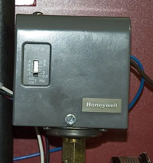

Neither the supply or the retuen are piped correctly. The pressure control seems to indicate a pressure around 2psi and to see the differential, you would have to remove the cover. The supply is probably the biggest problem. I can elaborate if you would like.

As Kfield stated the piping is in error. You have no chance of producing dry steam. The pressure control is also too high. The setting you show in the picture should be .5 and the white knob inside should be 1.5. There is a fitting right above the vent pipe not sure where it goes.

Phew! Thanks to everyone who responded and especially to Ken who had me call him. There are some major problems which need to be fixed. I have called the contractor who referred me to the plumber who put it in. I expect that I will have resolution as the plumber does a great deal of work for this contractor. I am more than a little upset as I was careful about who I got estimates from. Licensed, etc.
I just got a call from the plumber. I suspect he got a call from the contractor. He said he'd get the folks from Smith Boiler to come over to check out the installation. They are 20 miles from here, so hopefully that happens soon.
Thanks for all of your input. I've learned more than I ever thought I needed to know about steam heat.

I spoke to the tech rep yesterday and sent him larger pictures than I had on here (my friend enlarged them). He concurred with those of you who said that this boiler isn't installed properly. He also said that the plumber may even have to move the boiler. He's going to call him today and give him the "good" news.
