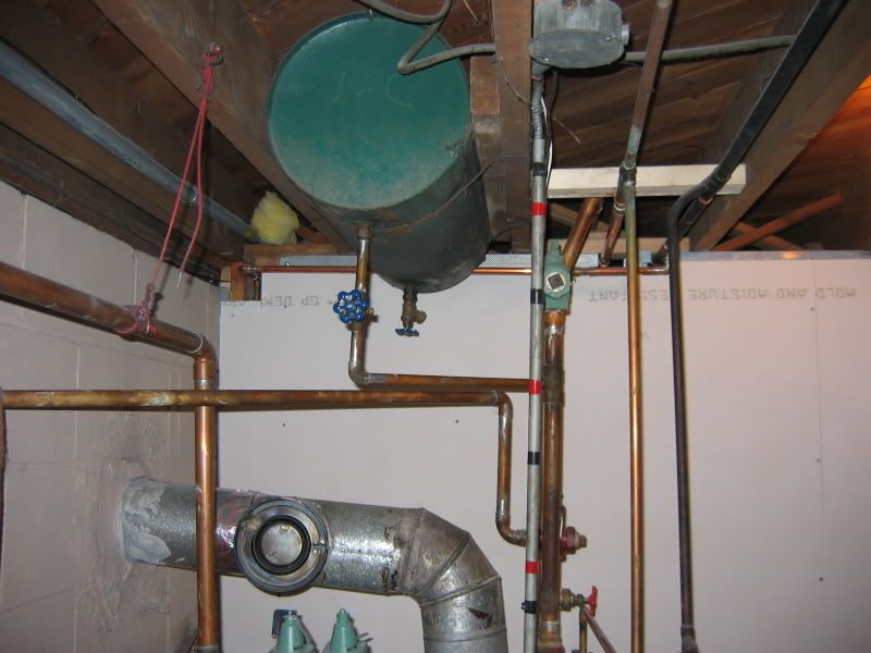

Is your expansion tank up between the joists?
Old 03-20-08, 06:15 PM
Grady's Avatar
Join Date: Jan 2005
Posts: 12,667
Received 39 Upvotes on 37 Posts
Good Point, Who
If it is a conventional type tank, I suggest it be changed to a bladder type.
Yes it is. I'm not sure what type it is. It looks pretty old.

I'd get rid of it and add an autovent on a riser somewhere or better yet a Spirovent type air eliminator.
The air from that tank is probably your bathroom issue. You could also get a B&G air-trol for the conventional tank that you have, but I'd go bladder type.

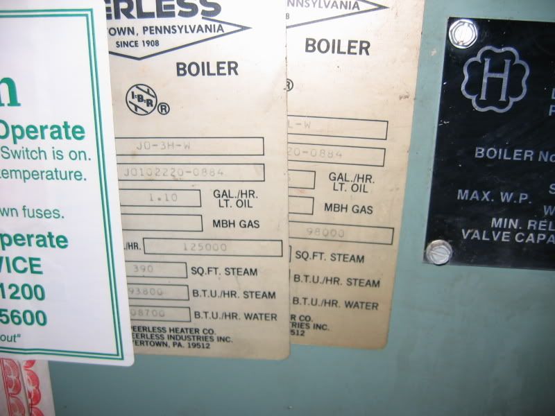

Can you get some pix that show the boiler and all the piping near it? Photobucket if you are asking how...

I'm at work now I'll get some pics tonight.

Thanks to everyone for all the feedback and help. I'm learning a lot. Here are some pics of the boiler. Let me know if you need any other pics:

deuce5, Grady is a pro, so give his opinion more weight than mine. The owner of HeatingHelp, Dan Holohan uses a conventional tank with an AirTrol fitting, not going to disagree with him although I use bladder tanks on my system.
A microbubbler like a Spirovent is exactly what you want on a diverter tee system. There are low velocity branches in diverter tee systems that will allow any microbubbles to come out of solution and mess up a branch's heat. That's what is happening now from your current tank. Water goes into solution there and comes out in the bathroom.
Autovents eventually leak. Personally, I wouldn't be putting them on branches and only for that reason.
There you go... some 180° opposed viewpoints on this.

It would work but the bottom would need to have more floor clearance. You would probably loose some heat output but I don't know how much.
You could put the new diaphram tank in the same place as the old tank. Granted, that may not be the ideal place but it would work. Usually they are mounted vertically.
