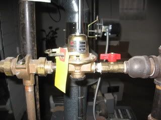

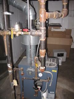

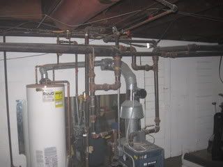

Here are the pics. You can see the expansion tank in the upper corner of the first shot. The fill water comes straight off a T junction from the main water line, thru one shutoff, the check valve, pressure reducing valve, and then another shutoff valve to the boiler return pipe.
Overview of system
View of flow regulating valve, reducing valve and SOV
Closeup of reducing valve
Overview of system

Bell and Gossett FB-38 set at 12 psi. Does that screw on the top of the bell allow pressure adjustment?
I've seen the term 'waterlogging' the expansion tank in my research here. I moved the tank and there does seem to be some water in there. Should I drain it?
Yes, the valve is adjustable, but don't do that yet. First, see if you can get water through it... watch the pressure gauge and lift up on the 'fast fill handle'. That handle bypasses the regulator in the fill valve and allows water to go through at city pressure. If the boiler is HOT, turn it off and WAIT until it cools to 100° or so. Never introduce large amounts of cold water into a hot boiler... C R A C K ! ... you don't want that.
If you do get water in, hold the handle until you are reading 12 PSI on the gauge.
Fire the boiler and watch the pressure gauge, it should increase maybe as much as 8-10 PSI from cool to hot... if it doesn't go higher than that, no need to do anything with the expansion tank at this time.

If the auto fill valve isn't passing any water, you can try cleaning the strainer screen located in the bottom.
Here's the PDF file for your valve, instructions are there...
Bell & Gossett reducing valve PDF
Since you have shut-off valves on both sides of the reducing valve, job is easier ...

I lifted the fast fill handle and there was no change in pressure, no audible water flow, nothing.
I found a manual for the reducing valve here. I removed the strainer on the bottom to check for a clog and there was none. As a precaution, I opened the SOV while the strainer cap was off to flush any debris out of the valve and I only got a very slight trickle of water. I don't think that's normal, but I don't have any way to know for sure.
As mentioned, the water line comes off a T-junction just before the water enters the hot water heater. I am having no issues with the hot water system, so I know there is water pressure up to that point. I appears there is a supply issue somewhere in the cold water flow.
I don't have a bypass, so is there another way I can boost up the pressure until I can get the supply issues worked out?

Try giving that check valve a smart 'RAP' and see what happens. It might be stucked... don't wail on it though ...
Is there a washing machine in the vicinity ?
You can remove one of the hoses from the back and create a 'cross connection' from there to a boiler drain to fill the boiler. If the boiler is hot, use the hot water connection.
There's a drain valve on the expansion tank, yes ? If so, hook the hose to that rather than the boiler drain, and don't bother 'leaking' the air out of the hose as stated below. A little extra air in the tank won't hurt a thing.
Hook a garden hose to the boiler drain, and the other end to the hose that you removed from the washer. Open the valve at the washer, but don't open the boiler drain yet. Crack the hose connection at the boiler loose so that the hose 'leaks' the trapped air. You don't want the air in the hose going into the boiler. When water starts coming out the 'leak', tighten the hose and SLOWLY!!! open the boiler drain. Watch the gauge carefully and close when the pressure gets to 12 PSI . Don't disconnect the hose yet.

Any way, that looks like a union to the left of that reducer. Maybe you can take the reducer off, open that ballvalve, and see if it pees? Maybe there is a big piece of rust or something stuck in the opening to the reducer.

I took your advice and gave the check valve a few light taps to see if I could shake it loose. On the third tap, water started moving and the pressure came up.
I bled all the radiators and I'll do it again in a few days to get the dissolved air out.
