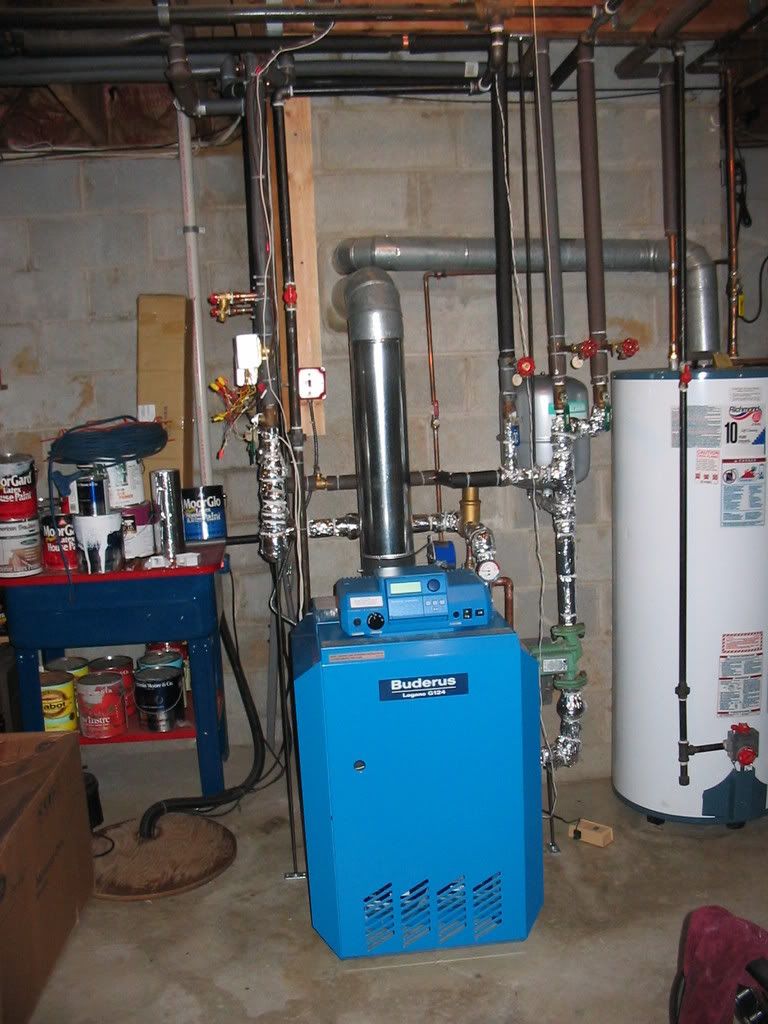

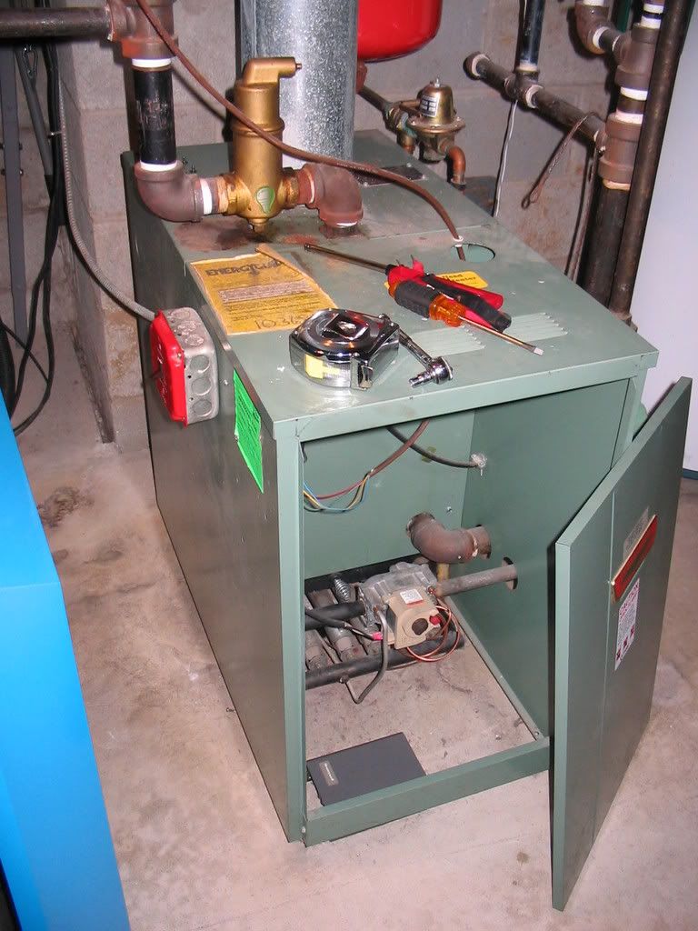

Old 07-31-08, 11:10 AM
G
Join Date: Jun 2008
Location: New Jersey
Posts: 23
Received 0 Upvotes on 0 Posts
Some Picts
Before:
After:

Old 08-04-08, 05:48 PM
Grady's Avatar
Join Date: Jan 2005
Posts: 12,667
Received 39 Upvotes on 37 Posts
Burner Set-Up
Originally Posted by gvernt View Post
Not sure what you mean by setting up the burner. The boiler is a gas boiler and according to Buderus installation manual I don't believe you don't need any special test equipment as long as your water temperature and boiler temperature are within specs. I already had PSEG (our local utility come over and look at it with regards to gas connections and flame color and they said it was fine). No problem. With regards to future repairs if I can't fixed it, I'll just call a local HVAC.
All the local gas utility did was to inspect the piping & "look at the flame color"? OMG!!!!
Any fuel burning appliance needs to have a proper & complete combustion analysis. One CANNOT tell how much CO an appliance is producing by looking at the flame nor how efficiently it is running.
