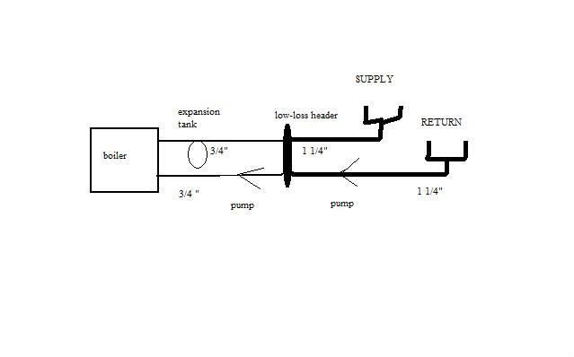

Yeah, the low loss header does seem like the best idea after some research. Does anyone have any recommendations for one? The only one that I have found is the B&G psh. I have made a beautiful mspaint diagram of how I understand this would be piped... if you tell me how I'm wrong, that'd be great!

Put the pumps on the supply side.
leave like a foot of straight pipe ahead and behind the circs if you have the room ...
You should have an air scoop on there too ? Depending on the type, you MAY need 18" of straight pipe ahead of that ... some types don't require this straight pipe.
You know them PSH's are pretty pricey ...

yeah, I'm aware of the pricey psh's, it makes me want to cry a little bit... do you have any other low loss header recommendations? The PSH is simply the only one I found online. The expansion tank or header should have something for the air, that would be adequate?

Troop, the Vito loop is to be pumped on the return. I think because it has a pressure-proving switch in the boiler, and/or because they say so. This is a small hx (holds less than a gallon of water!) and they want to make darn sure the water is doing its job.
But on the space heating loops, definitely pump on the supply side. Don't use bullhead tees. Make supply and return manifolds that have the zone supplies (and returns) coming off of them. For example (from another manufacturer, but a good diagram), page 24 of this:
http://www.htproducts.com/literature/lp-185.pdf

Posts: 25
