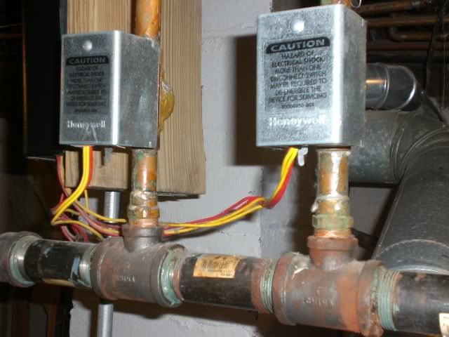

I looked at your pictures again, and one thing that I did NOT see was a device called an 'air separator' or 'air scoop'. I also did not see a device called an 'automatic air vent' or 'float type vent'.
These devices are intended to collect air in the system and vent it out. If they are not there, it will always be a problem for you to keep the system free of air.
In picture #4, on the right side, there are two drain valves, and below that, two shutoff valves. If you can not find any air bleeders on your baseboards, you will have to use those to flush out the air. Don't do that yet though, look for the manual bleeders first, and report back what you find (or DON'T find) The problem is going to be that once we do that, the fresh water you add will release MORE air when it is heated, and with the absence of the 'air scoop' and 'air vent' noted above, that air will again be trapped in the heating loops.
Is the pressure still under control ?
Is the system heating the house properly ?
Do the pictures show ALL of the piping ? Is there anymore piping near the ceiling that may have an air vent device attached to it ? Look for small brass cans with a cap on top.

I have uploaded some new clear pictures of the Boiler ,Baseboard and copper pipe connections. I could not locate any device like Air scooper or seperator?
The end of the base boards are brazed to the copper piping lining .I suppose they are Fins kind ? I am not sure .

Hello Rajan, yes the new pictures are good enough to see that you do have 'fin tube baseboards' installed in your home.
Have you looked at all of them ? I hope that at least ONE of them has an air vent on it. I am not so sure though, because if you do not have an air scoop or an automatic air vent on the boiler itself, I doubt the installers would have put them on the baseboard either.
There is another way to flush the baseboards, but as I explained earlier, you will be adding a LOT of fresh water to the system, and once you do that, MORE air will come in with the fresh water.
In this picture please notice the 'lever' on the bottom of these controls. These levers will allow you to manually open these ZONE VALVES.
In this picture, there are four red handle valves and a brown bell shaped valve with a lever on top. The two red handles on the bottom are 'shutoff' valves, and on the top are drain valves. The lever on top of the brown valve is a 'fast fill' valve.
Turn off the boiler and let it cool below 100F.
Connect a garden hose to one of the drain valves and run it into the laundry tub in the basement.
Close BOTH of the red shut off valves.
Move the lever on the bottom of the zone valves to the MANUAL OPEN position.
Open the red drain valve with the hose on it.
Lift UP on the lever on top of the brown valve.
Let the water run through the system until there is no more air coming from the garden hose.
Put the lever on the brown valve down, and close the drain valve with the hose.
Move the hose to the other drain valve.
OPEN the drain valve.
Repeat the process of lifting the lever on the brown valve and allowing the water to run until there is no more air.
Put the lever on the brown valve down, close the drain valve and remove the hose.
OPEN both of the red shutoff valves.
Return the lever on both zone valves to the AUTOMATIC position.
You should now have removed most of the air from the system. Make sure that all the valves and levers are returned to their previous positions and turn the boiler back on.
However, since there is no device on your boiler that I can see (air scoop, or automatic air vent) you will ALWAYS have trouble with air in this heating system. The solution is to have an air scoop and automatic air vent installed by a plumber.

Hi Claude, yes, let's start with pictures... you know how to do ?
If the boiler pressure gauge says like 12-15 with system cold, and the relief valve is weeping, and the valve is more than 5 years old, I would replace it. Before any 'how-to' though, I'd like to see the pics...
It does sound like air is preventing the circulation, when you say 'top floor' I'm assuming you mean 2nd floor ? and boiler is in the basement ?
What is the normal COLD pressure on the boiler, and how high does it go when it gets HOT ?

Pics to follow...
NJ Trooper...
I will post pics sometime today, as soon as possible, because I would like to work on the system this evening and tomorrow morning -- a cold front is coming!
My home is a tri-level with a basement, so really has 4 levels but three zones.
Thank you and I look forward to discussing with you later today.

Pics of system
Here is the link to pics of my boiler system. http://s450.photobucket.com/albums/qq228/claudesamm/
I am very much looking forward to your advice. Is it worth it for me to just call someone, or is this a reasonably straightforward process?
Thanks again,
Claude

I truly feel sorry for anyone that has to work on that system. Whoever installed it in that corner should be shot. Same goes for whoever allowed that installation to pass inspection.

LOL...and thanks for your sympathies. However, it's got to be done. I'm pretty sure I've got a grip on it. Just want to double check before I start the process.
