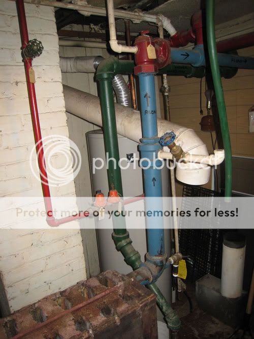

I am installing a new boiler system (LAARS mini therm 160,000btu) - http://www.laars.com/products/reside...?uniqueID=JVST - to replace the old sears monster 155,000btu.
The old system heated a total of 15 cast iron radiators within 2 floors.
Q # 1 -The orig supply & return piping is 2" steel pipes and heading up to the radiators appears to be mostly 3/4. The new boiler inlet & outlet pipe size is 1-1/4, is it OK for me to reduce this to 3/4" & run my pump, zone valve etc up to the 2" loop? Photos are below so you can see my dry run so far:
Q # 2 - I have this huge expansion tank which is 1'x5' (I drained it, but didnt notice any place to add air, is this normal), now should I just connect to it again, or install an air separator & expansion tank?
Q # 3 - The original pump was a B&G 100 series & I do not want to use this due to the oiling & mess, I installed a taco 007, do you think this will suffice, if not how can I determine which pump will be best for my system & which do you reccommend.
Q # 4- I eliminated the control flow valve because I am installing a 3/4" zone valve, I read that you can eliminate the control valve if you install a zone valve?
Now I do want to mention this: what prompted me to go with the 3/4 pipe is), the circulator pump (even the large old B&G), the zone valve orifices (and almost all the piping to the radiators (as well as the radiator passages) are all no larger that 3/4, so if they all cause this reduced pressure/flow etc, then why 3/4" can't just do the job successfully here as well?
What is the worst that could happen?
I would really appreciate some expert advice.
Thanks
Tom
Link to Tom's Photobucket album

Let's start with your pictures...
Didn't the boiler come with a 'vent damper' ? I don't see one in your pictures. The boiler won't even fire if you don't install that and plug in the wiring harness. What I do see is a piece of dryer vent connected to the flue pipe ... what is that stuff?
Your system is a LARGE volume system. You can't just connect the in and out of that boiler to the pipes without taking that into consideration. The water that returns from those radiators is going to be cold/cool for a LONG time, and this is going to play he11 with that boiler. In fact, the flue gases condensing inside it are gonna ruin it ... not to mention that if you don't pipe it according to the manual, the warranty is going to be void. In fact, most manufacturer warranties are void from day one if the appliance isn't installed by a qualified, licensed heating contractor.
Did you read and understand the installation manual ?
In particular, Section 5, starting on page 12. Understand that your system DOES qualify as a LOW TEMPERATURE system due to the simple fact that it is going to take a LONG TIME to heat that large volume of water.
These Laars boilers are VERY sensitive to having the proper flow through the unit. They MUST be piped properly, and according to the manufacturers recommendations. Did you notice how many times the manual said "Warranty is void if ..." ?
Don't think for a minute that if your house did not heat well with the old boiler, that this new boiler will be a 'magic bullet'. Deficiencies in the original installation are probably to blame... and the first step in getting energy costs under control should be INSULATION in the home, and correcting any INFILTRATION problems.
I believe that you are misunderstanding the 'high fire / low fire' feature of this boiler. Fact is, that most of the time it will be operating at high fire. It all depends on the temperature of the water in the boiler, and believe me, it will rarely, if ever, go to low fire with your system... UNLESS it's properly piped.
It's all about FLOW and VELOCITY. You don't want water SCREAMING through the heating pipes. You want the water to move at something like 2-4 Feet Per Second (FPS). In a 3/4" pipe, that means about 4 Gallons Per Minute (GPM). You can move approximately 10,000 BTU for every 1 GPM of flow. Therefore, in a 3/4" pipe, you can move 40,000 BTU at an acceptable FLOW rate. But, that boiler is around 140,000 BTU! In order to move FOURTEEN GPM at 2-4 FPS, you would need a pipe that is ONE and ONE QUARTER inches in diameter. So, now you see why those pipes on the boiler are that size ?
Pumps are designed the way they are designed because that's the way they work... yes, it appears that it's 'choked' down, but they are DESIGNED to work that way. Pumps add ENERGY (or HEAD) to the water, and they can't add that energy with huge, cavernous insides. It would be like trying to stir a garbage can full of water with a toothpick.
If there are 3/4" pipes going to the individual radiators, it's because only a PORTION of the flow is going to that radiator.
I think I've given you enough to think about for now... and honestly, I'm not trying to be cruel, just my opinion, but I believe that you are in over your head. If you had started this project in May, you might have enough time to learn what you need to learn, and apply it to the installation at hand. But now... I dunno ...

Tomzy,
Tough as it may be to take, Trooper and rbeck have made some very important points. Let me add a bit to that (call it piling on if you want...). First the bad, then the good.
In the category of "water under the bridge," we have:
1) you didn't do a heat loss before sizing the boiler. Chances are this thing is 2-3 times bigger than you need. Even if it has a half-input firing rate, a boiler sized to the heat loss will save you money over the long term. A boiler is theoretically a 20+ year appliance decision. It really does help to size it right
2) you didn't plan out this installation beforehand. You really can't wing this stuff as you go. Or at least you shouldn't.
3) you apparently didn't read or understand the installation manual. The manual is quite straightforward, including the flow rate requirements and the primary/secondary or bypass requirements.
In the category of "ok, so how can this be fixed up so it works safely and efficiently," we have
1) you need to read, understand, and follow the installation instructions. They have a decent writeup and good diagrams that cover a variety of installation scenarios, including yours. Among other things, the boiler should be piped primary/secondary and have a dedicated circulator to provide adequate flow. There's a reason they require 1.25" piping -- because you cannot shove 16 gpm through 3/4" piping. Try blowing 30 cfm through a cocktail straw sometime.
2) if you follow the directions, you'll see that you end up with a boiler loop that has an adequate flow rate so the boiler can function normally and efficiently. You will also have system (space heating) loops with zones controlled by circulators or zone valves, and those will be sized to provide adequate flow through the space heating loops.
3) my suggestion is to get a cup of coffee, sit down and read the manual. Figure out which piping scheme you want to use, and follow it to the letter. The diagrams are sufficiently complete that this should not be too difficult.
4) you will end up with a boiler loop that is composed of 1.25" piping, and uses either primary/secondary or a bypass approach. See pages 12-15 in the manual. The boiler loop will connect to a manifold that might be 2" diameter, and have the takeoffs for your zones. The return manifold will look similar.
Good luck. Believe it or not, people are here to help, not tear you down. There have been a number of excellent recent DIY installs that this forum helped to inform (e.g., the one by GEEVEE is really sweet).
