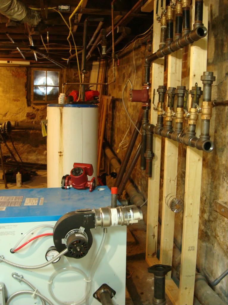

i'm wondering about having the primary loop to a secondary loop take offs to the radiators, i read that it should be supply tee then second return tee is 4x the diameter away which at 1.5 size pipe would be 6" right but this is my question
i was told to put all my supplies at the top of my header then all my returns at the bottom, so this type of configuration would not work, how would i line up all the supplies then the returns????
I'm building a black pipe system p/s system from an old gravity system that was partially torn apart, new black pipe cause copper is still over priced
thank you.
thank you.

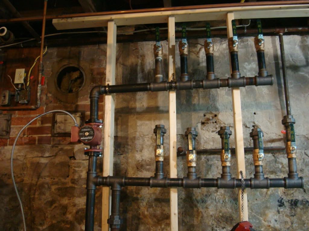

trying this out
thought I'd throw some fittings together but i have some questions about distance as you can see in my photos the tee in the bottom left how that will be my supply and the tee next to it will be the return, do you recommend more spacing say the 12" minimum distance and please critique my plumbing and tell me what i should change?
i am planning on changing to shorter nipples at 1.25 under the ball valves also
my main secondary and primary pipe is 1.50 inches and the branches are 1.25 all throughout the house except for a couple of small copper lines fed off the main branches
thank you
That won't work right... both tees need to be in the same orientation... and there needs to be straight pipe ahead and after the tees... like this:
http://www.comfort-calc.net/pictures...r_P-S_Tees.JPG
Join Date: Mar 2009
Posts: 9
Received 0 Upvotes
Okay I thought i'd just save space but i'll reconfigure the pipe and repost
It should be fine if i were to slope the return tee's to feed from behind the supplies?
and would it be still good if i were to still install the cushion tank just after the supply from the boiler on the secondary loop or should i install it on the primary up with all the valves?
thank you

Are the P/S tee spacings that critical for a single CST P/S system? The tee's are more critical when using multiple P/S CSTs for multiple heat loops to provide hydronic isolation; but for a single set of CSTS does it make any difference? Just asking.. ?
Pete
Pete
Probably not Pete, but the way that one is set up now, that circ pump being in line with the flow will upset the flow.
Nowisn, what pipe size is going to your heating loops? Do you really need to come off the manifolds with that size pipe? At some point you are probably going to have to reduce the pipe size... the sooner you do that, the cheaper the whole installation becomes. Just the price difference between 3/4" and 1-1/4" ball valves is pretty significant.
Your zones are going to be pumped with circulators, correct?

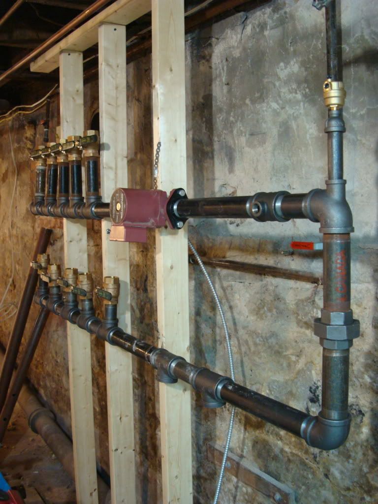

the piping is throughout the house is a two pipe gravity system which all 1 inch and a quarter, I'm converting by adding a p/s loop which is secondary through the boiler and the primary which is the feed to the house.
the secondary loop is the same size as the boiler ports which are 1 inch and a half then i'm downsizing to match the braches which are 1 and a quarter
How are you going to circulate the zones? Individual pumps?
Something about the pump mounting has got me bugged... I seem to recall Grundfos not wanting the electric box on the bottom... but I could be wrong... check the install sheet for the pump.
You're not using a decent air separator?
Where/how are you mounting the tank?

Sure looks like the tees for the boiler secondary loop are more than 5" apart from the centerline of the branches.
No air separators and if not using zone valves the circulator is not required where you have it. The circ in the primary pipe is only required with the use of zone valves.
I would also have the ball valves on the supply side above all the zone valves, circ's and everything else for ease of service. Also add a drain on for servicing on the primary pipe. You air vent is not going to be as efficienct as it would be on an air seperator as the seperator will cause agitation to seperate the air from the water as the water slows down in the seperatore. The water slows due to a larger space than the pipe has. Better air seperation.

I haven't actually decided on putting the tank in the primary or seconary boiler loop but then I decided to put an air scoop with a vent and the tank below off the left hand side of the boiler supply line, I'd go with a spiral vent but there like 200 bucks here and not worth it
the pump does concern me as well but not to many options on placement except for removing the union and placing the pump vertically
And the electrical box can be moved on that pump, manufactures don't like putting the eletrical connections on the bottom due to leaky water making its way in
maybe someone could suggest a different piping config
Oh i was going to zone it off indiviually but not now, thats why you see the unions there for future concideration and the ends of those primary supply and return lines will be just capped with temp stata on them at the end of there lines
there will be some additional nipples and tees with drain coks for each branch as i ran out of stuff and this is only a mockup, its just screwed together

You want the larger water volume to go through the air separator to get rid of more air.
It should be in the primary just behind the circulator and the tank will connect to it.
Fig 4 is showing zone valves. The primary pipe does not have to be straight but everything in the proper order.

in that diagram 4 does the circ pump have to be before the return
I have my pump just before all the supply tees, It is like the diagram kind of but the pump is after the supply and return from the boiler.
I can make room for a separator if I can find a supplier who has any
