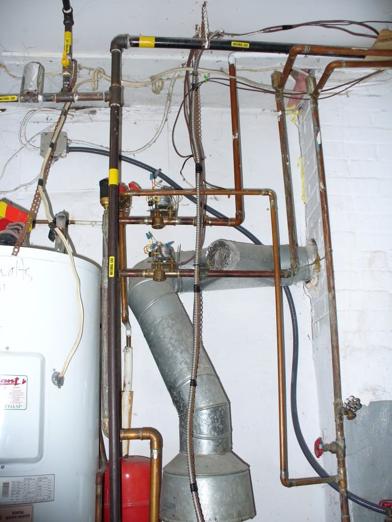

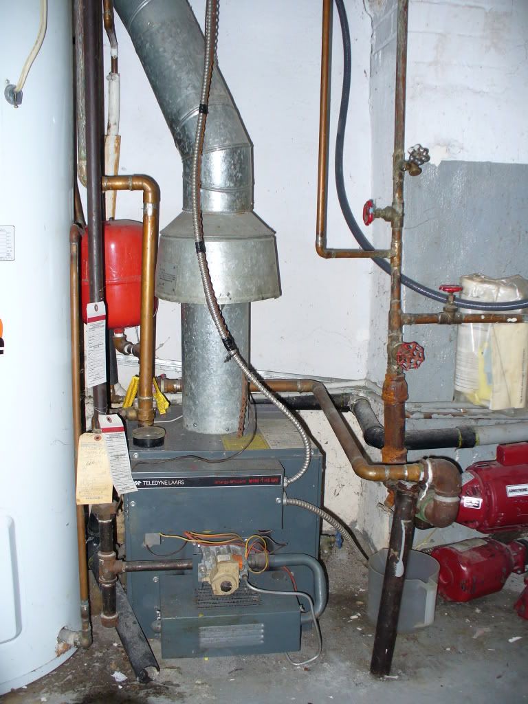

Pictures of the boiler and piping will help diagnose any problems. To post pictures you need to first upload the pictures to a photo hosting site such as photobucket.com or villagephotos.com. and then post the public URLs for the pictures (or album) here. More pictures are always better than fewer. Please have CLEAR pictures and have both close up pictures and ones from a far enough distance that we can see how the various parts are interconnected.

They are also to be piped with a SYSTEM BYPASS valve ... let's see the pics and go from there ...

Short cycling
Yer right... no bypass ... bummer ...
With two 3/4" heating circuits, of which only one might be active at a time, you might have either or both of:
Too fast flow in heating circuits (can you hear the water flowing?)
Not enough flow in boiler. (could easily contribute to short cycling problem)
Adding a system bypass would solve the boiler flow issue, and probably solve any issue with too much flow in the circuits.
I believe the heart of the short cycling problem is the fact that it's a large boiler, and a light heating load. There's just so much heat you can pump through a 3/4" loop ... about 40K BTU ... so if only one zone is calling, your boiler fires up and hits high limit quickly ... you can't extract the heat as fast as it's being put in ... so it's bouncing off the high limit.
How to solve ? ummmmm... Beckett Heat manager MIGHT help ... it would widen the differential a bit and you would get slightly longer cycles, farther apart ...

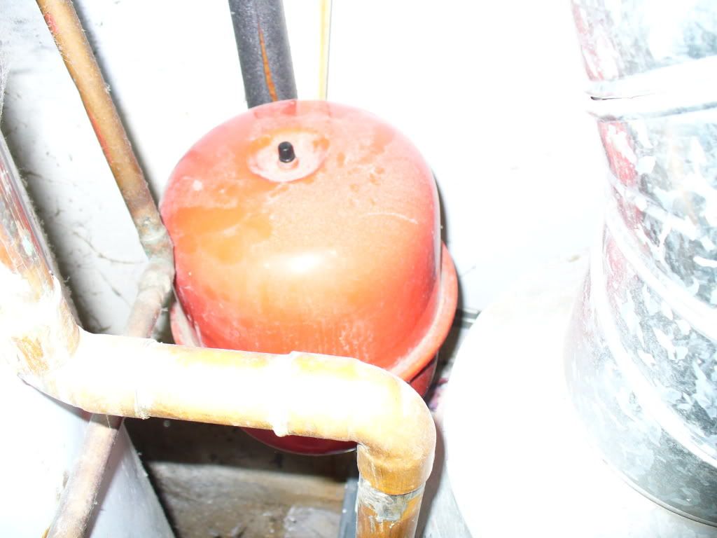

I've turned off the system and drained it until the pressure sat around 5 psi or so (I'm guessing the water in the system vs gravity) and tried to release the valve on the expansion tank ... nothing, no air, nothing.
Ok, so I checked with a tire gauge and same deal.
I went and grabbed my portable inflator (I don't have a bike pump) and set it to inflate..... nothing - no added pressure, no air going into the system - I even opened the drain while pumping to see if it would help, nada.
I wanted to figure out what kind the expansion tank was so
I turned it and heard water sloshing around in it.
From what I can recall, the membrane is to separate the water from the air so... unless air got into the expansion tank... the bladder is toast?
Like I said though, no air, no water from the top valve.
Any ideas?

- I'm going to replace the expansion tank.

I would hold off on the bypass just yet ... and we'll talk about the indirect later... right now, you wanna get that heat going ... it's been working all these years without the bypass ... right ? and your hot water heater is working ... yes ? But, it's gettin' cold out, so why not let's forget about those "while I'm at it" jobs, because they can be like opening a can of worms.
So let's get that tank replaced first ...
Before you install the new tank, verify the air charge to be 12-15 PSI ... and adjust if necessary.
While you are out picking up the tank, also pick up a 1/2" ball valve, and a short 1/2"thread pipe nipple.
You thread the nipple into the elbow that the tank was on, thread on the ball valve, and thread the tank into the ball valve. Oh, pick up some teflon tape and/or some rectorseal #5 too ...
This way, the NEXT time you have to change the tank, you won't have to drain as much water ... drop the pressure, close the valve, spin off the tank ...
If your gauge did not go to zero, and sat at 5 PSI, there's a real good chance that gauge is outta whack too ... should go all the way to zero, the camera might be adding 5 PSI ... so maybe that 20 that you see is really 15 ? and OK ?
You need to verify the pressure gauge before you go much further after replacing the tank. Maybe replace the gauge at the same time ?

On the bypass...
Manf recommends that it be a full size bypass, meaning the same size as the large supply pipe off the top of the boiler.
There needs to be a valve on that line, and it really should be a valve designed for throttling ... ball valves are not ... GLOBE valves are ...
You could tee into that large supply line, run to the left, down to that rusty return pipe between the valve and the pump. The bypass needs to be installed on the SYSTEM (not the boiler) side of the pump.
Maybe you could replace that section by the pump with copper, and put a tee right there.
You should also install a thermometer on the return to the boiler. Using the gauge on the boiler, and the one on the return, you would set the opening of the bypass valve for the correct temperature difference across the boiler.
I'm not too awful hip on the various indirects available ... there's lots of them ... not too product smart here ... some of the other guys will jump in with suggestions ... I think the concensus is the Triangle Tube ... which I believe is the same one Weil-McLain sells as their brand rebadged.
On the bypass...

Just wanted to follow up - the expansion tank replacement fixed the high pressure issue (and it doesn't seem to short cycle as much anymore).
One indication I found that the expansion tank was dead, was the black dye (from the bladder rubber {heh}) that came out of the lowest drain off the boiler.
This is the same black dye you'll find in toilets when the seals start to go.
