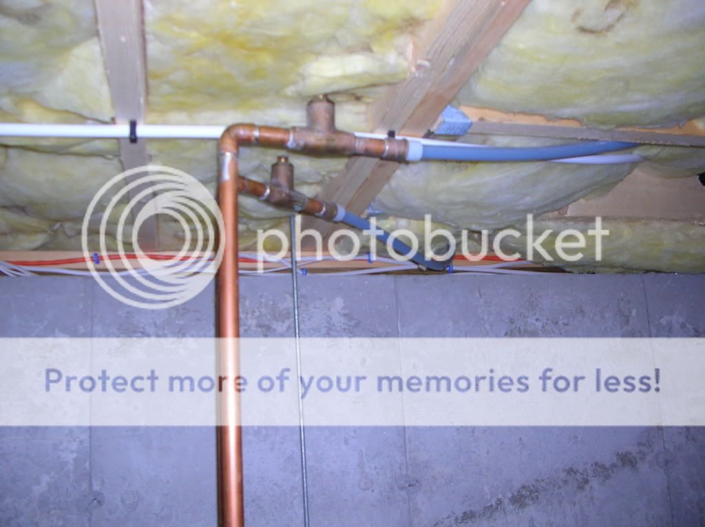

Don't go disconnecting any wires ... you shouldn't need to ... but I don't think the circ is your problem...
I'm still down with Grady's 'other' suggestion, that one of the flow check valves is hanging open intermittently.
This pic shows them...
While it IS possible that the relay panel or thermostat are at fault, it's much less likely than the flow check problem.
If you are lucky enough to catch the bad dog in the act, give the flow check that feeds the zone a smart 'rap!' with the bald-headed end of a broom.

which piece is it that I should hit?
In that pic, vertical pipe branches to two ... each branch has a hunk of bronze on it ... tee shaped ... knobby thing on top ... then the plastic pipe ... Do those plastic pipes go to the zone that keeps heating? Those bronze things are FLOW CHECK valves that only allow flow in one direction (see the arrow? that's the direction of flow) and only when a circulator is running.
If that piece is after the circulator - does it stop water trying to be circulated upstairs?
It would work the same before or after the circulator... only allow flow in one direction, and only when the circulator is running.
Keep the concept of gravity flow in mind... hotter water is less dense (lighter), and will float to the top of cooler water ...
Your system is several 'loops' of pipe, supply pipes (hot water out to the radiators), and returns (cooler water in from the radiators).
Let's say that the thermostat calls for heat, and the boiler fires, heats up and satisfies the thermostat. Heat call ends, but boiler is still hot ... check valve hangs open ... rut row ...
Now, there's nothing in the way of the cooler water in the loop from flowing back to the boiler (it's heavier, so it will just fall down the pipe by gravity), and pushing the hot water up into the loop. No pump, nothin' ... physics only ...
When that happens, that zone will probably overheat ... and that's what I think is happening. BUT, it could still be the circulator/relay problem.

valves in Troopers picture
Grady, that's bir's actual valves, one of his pics ...
Early on bir said this:
I was in my basement and hear a high pitched squeal coming off that zone valve.
I wonder about that ... possible that that flow check is sticking CLOSED sometimes also ?

bir, your new t'stat may or may not have an anticipator setting. Many of the newer models actually have a little bit of 'smarts' in them ... they track the temperature swings for a bunch of cycles and set the 'anticipator' to match ... cycles per hour is related, but not exactly the same thing ... I don't fully understand that cycles per hour thing myself.
Ya know, I looked at that pic, and thought... 'somethings wrong' ... and now that you told me that, sure there's something wrong! There's a pipe coming out of a non-existent tee fitting !
OK, so ONE of those must be going to the overheating zone ... that's the one to persuade...
If that check valve is hanging, and it's very intermittent, that means that when it does hang, it's probably by a thread ... so even the act of turning the circ on and off might be enough to dislodge it and allow it to seat again.

flow check valve (99% sure)
OK, I'm pretty sure I know what it is:
I caught the zone in the act, so I went to the basement and listened to the circulator. (I can hear when its going, its quiet but you can hear it) and I heard nothing.
I smacked the flow check valve for the zone a few times and then it seemed like the zone cooled down.
Now that would seem to indicate its the valve... but this is where I may need another physics lessons:
If the first destination on the heating circuit, if you will, after the flow check valve is the master bedroom and the last stop is the en suite bathroom and if the flow check valve is allowing cold water to fall back into the boiler wouldn't that mean the path of less resistance for the hot water which wants to rise "backwards" through the zone? So I would expect that bathroom to get hot but its the baseboard in the master bedroom nearest to the valve that gets hot first.
The physics may still confuse me, but I think the fact that after I hit the valve the incident stopped is evidence enough. Unless its a coincidence... or maybe a conspiracy.

Good point...
about the non O2 barrier PEX ...
bir, can you read any writing on the tubing ? What does it say?

Pex
Good catch ZL700. I hadn't noticed the pex either. I've never seen barrier pex in blue. Not saying just because it's blue it isn't barrier, just I've not seen blue barrier pex.

I'd be surprised if that tubing didn't look white in person ... that concrete wall is awful blue too ... seems like the color balance is pretty skewed in that shot.
Yep, the flash washed it out. The tube is kind of grey. No writing on it though.
