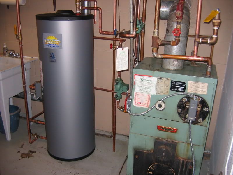

I want to add a Bock 40gal indirect tank to my oil fired boiler and eliminate the coil for domestic hot water. It seems like a pretty straightforward installation but I have concerns about the boiler controls. The way it is set up right now, it seems the boiler is set to run until it reaches the temp on the high limit on the aquastat, which is set to 180. When a thermostat calls for heat, the circulator comes on and then when the boiler temp drops below 180 the aquastat will fire the burner until it gets back to 180. The low limit on the aquastat is currently not hooked up to anything. Once I add the indirect tank, I don’t think I need this boiler maintaining 180 degrees all the time, correct? What are my options here? Can I make this a cold start system? Or can I set this up so it maintains a minimum temp and then will only fire when there is a call for either heat or domestic hot water? I’m not sure how to do this.

On your boiler ... I don't see an ASME rated pressure relief valve. You DO have a relief valve (next to your feedwater regulator), but it really isn't rated for the job it might be called on to do ... it will relieve pressure, but may not be able to relieve pressure FAST ENOUGH to properly protect ... that's the way they did it back then, when they didn't know better.
You should plan on adding the proper relief valve.

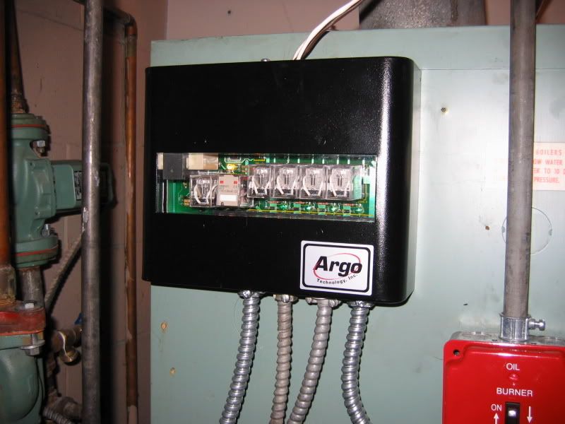

What is the model # of the two relay boxes on the side of the boiler ? (RA89 ?)

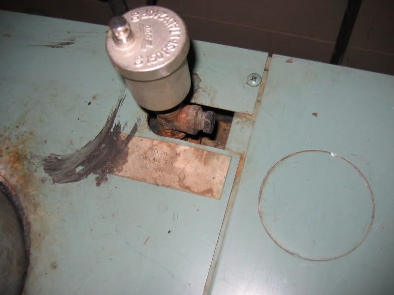

What size is the tapping that the automatic air vent is in ? Is it reduced down from a 3/4" to fit the vent ?
Otherwise, on the supply pipe close to where it leaves the boiler.
Can you get another pic or two ? Get a view of the piping coming off the top of the boiler ...

The two relay boxes are RA89a and RA832A.
The air vent looks like it goes to a maybe a 3/8" pipe size. I'm not sure, but it def looks smaller than 3/4".

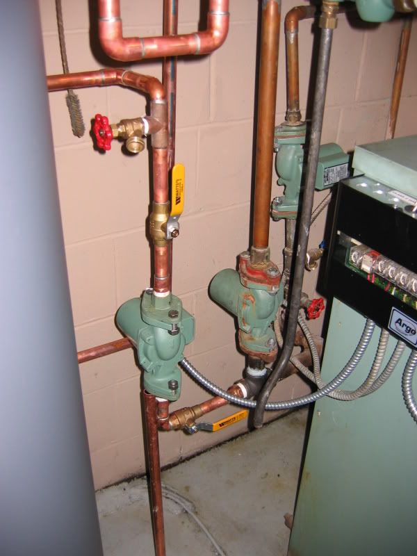

I made a drawing of the wiring that I have now. I also took some pics of the top of the boiler. The last pic is of the well for the aquastat.

Pull back some ... tryin' to see where a relief valve could mount on the pipe ...
The top of the well looks right, but you can't really tell how deep it is ...

I think I might just get 3 of these RA845A relays. One for each zone and one for the indirect tank. My only other question would be how to tie them all in to each other. Do I just wire terminals 5 & 6 on each relay to the burner control so that if any zone calls for heat it will turn on the burner? I'm not sure if this is right or if there is a better way to do this?

Too bad both relays aren't the 832 variety ... those X X terminals in the 832 can be used to fire the boiler with the new aquastat, but the 89 would need an external relay ... or just replace the 89 with an 8845 ... (not the 845 ... not a typo) see:

You could replace the 89 relay with an 8845 and wire as shown in that illustration. This would be the least $$ approach.
Your 832 relay can still be used ...

ASME pressure relief...
Replace the first elbow out of the boiler on top with a TEE ... re-connect side port of tee to supply line ... on the top of the tee, provide 3/4" threaded fitting ... into that fitting, install 30 PSI ASME rated pressure relief valve ... run 3/4" piping off valve and elbow down to within 6" of the floor ... pipe to where anyone in vicinity won't get blasted with superheated steam if it opens ... and also to where you can place a container underneath if necessary ...

As for the relief valve, I found documentation on my boiler and there appears to be a cap on the back that is designated for pressure relief. Should I install the valve there or just do it the way you described? See pic below. Thanks!

There is a cap on the back of the boiler and there seems to be enough room for the relief valve and pipe so I will start working it with the pb blaster.
By the way, do the relief valve in black pipe ... stronger ... easier ... cheaper ... than copper.

I think the best plan is to change out the aquastat and the relays... cuz even though it _could_ be run with the old stuff, you would likely need a couple more relays, and a whole bunch of time wiring it all up. With the Taco panel, it couldn't be much easier to wire everything... and to add the indirect later, and be able to set priority on it.

If you could suggest anything regarding the design of the piping for the new tank that would be great.

The tank is in. I went with the Crown Boiler Megastor MS-40 (lifetime warranty), Argo ARM4P Relay (expandable for outdoor reset and more zones), and the L4006 aquastat. The L7224 wasn't really needed because I just need a hi-limit cutoff. I put in a new aquastat well and it was a good thing because the old well was "double wide" to accomodate 2 temp bulbs from the old 4010 aquastat. I don't think that would have worked with any new aquastat. I still need to finish the piping down to the floor for the relief valves. But it's working great and it's real nice to have hot water!
