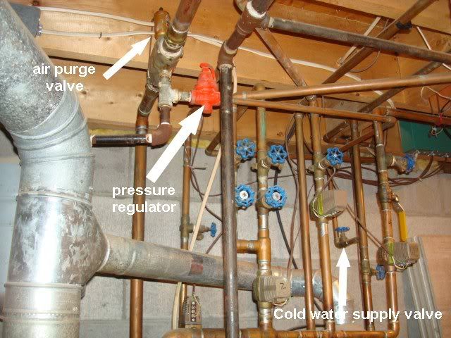

I have a system very similar to jdmclemore. I had been hearing whooshing sounds in a few of my zones and decided to read here in the DIY forums to see if anyone else had posted similar issues. Then I found this thread...excellent info!
My pressure tank had little/no pressure in it and I raised it to 14psi. The air stayed in the tank...no air bubbling sounds. BTW, when I put a pressure guage on the schrader valve, the small amount of air that came out smelled disgusting.
I do have a question for you: My feedwater pressure regulator is in line differently than jdmclemore's. My cold water supply goes like this:
cold water supply > valve > feedwater pressue regulator > return piping (w/air purge valve)
My cold water supply valve was CLOSED. Should I keep it closed or keep it open?
Here's a photo:
Here's a photo:

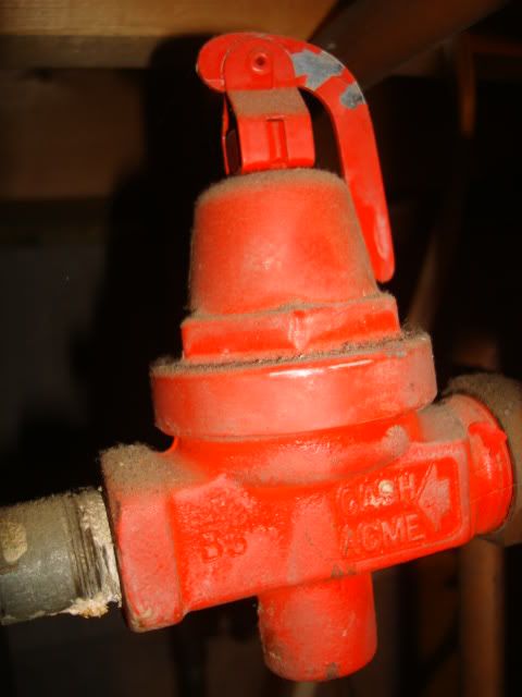

Feed Water Valve
Automatic water feeders (pressure reducing valves) are a double edged sword unless you have a low water cut off safety installed. If you do have a low water cut off (LWCO), I suggest leaving the valve off.
If you don't have a LWCO, this where the catch-22 comes in.
Leave the valve open & possibly mask a leak. A lot of fresh water coming in will rust out a boiler; close the valve & if there is a leak, take a chance on damaging the boiler due to low water.
Best solution: Install a LWCO & close the valve.
Any numbers on that "pressure regulator"? The handle on it looks more like one on a relief valve than a reducing valve but the bottom looks like a reducing valve??????

On the left side it is stamped "B3"
On the right side, it is stamped, "CASH ACME"

#23
Hope you're having a good holiday!
Nothing urgent about this; the system is working; I'm just worried about the long term prospects.
Here's a few pics:
dennislee - Photobucket - Video and Image Hosting
I hope that link works.
To answer your questions:
1. The pressure was at zero, and I determined that the pressure regulator valve was faulty, but haven't yet replaced it.
2. I added water via the drain valve to get the pressure to 15. It stays there, without much variation, whether cold or hot.
3. I did drain the expansion tank (about 7 gallons).
Thanks for your attention!
Dennis

#26
The way that expansion tank is piped will not allow any air to find it's way back to the tank... that's what's supposed to happen... air circulating in the system should be able to go back into the tank.
Since it's got that 'trap' on it, it can never get there. In general, it's good practice to use 3/4" (yours looks like 1/2", but pics can be deceitful) and have it slope upward about 1/4" per foot, all the way back to the tank. I suspect someone at some point got tired of banging their head on the pipe and thought that would be a good idea... it's not.
How/where does the pipe to the tank connect to the rest of the piping?
#27
You're right, it's 1/2 in., I included a pic to show where it's connected (Sorry it's rotated)
The pipe is coming from the hot water pipe from the boiler.
I hope it's clear. The tank is about 15-20 feet from the furnace so it's hard to get it all in one shot. It does seem to slope up except for the trap.
#28
In that case, I wouldn't worry about the 'trap' at the tank, cuz the way it's connected to the boiler isn't going to allow much if any air back to the tank anyway.
Your only choice seems to be using the bleeders on the radiators... and accept the fact that it may be a 'constant' thing. A more permanent solution would be to have some type of air scoop installed near the boiler, and the expansion tank connected to the top of that to collect the air and send it back to the tank, where it belongs.

#34
The supply pipe is a 1&1/4 inch vertical pipe that goes straight up to a T (with that 1/4 inch pipe to the expansion tank off to one side)
dennislee - Photobucket - Video and Image Hosting.
I'm guessing that an air scoop needs to be on a horizontal pipe, so do I need to put a loop into the vertical to make this work?
How important is is to collect the air and send it back to the expansion tank? Seems like a difficult proposition.
Thanks,
Dennis
#36
Where would be the best place to plumb that in?
Would I still need an air eliminator of some sort?
And where would that go?
#39
A horizontal section of pipe is required for the air separator. There are a couple types... some require 18" of straight pipe ahead of them... others don't.
If you convert to the bladder tank, you also need to add an air scoop. The cast iron type have a tapping on top for an automatic float type air vent... and a tapping on the bottom for attachement of the expansion tank. The tank will hang from this connection, so you need room below...
The tank doesn't HAVE to be installed at the air scoop. So, you might have to install the air scoop in one location, and the tank in another.
It's actually probably LESS work to add the bladder tank, because you won't have to re-do the piping to the old one ...
I need to look at your pics again ... might need more pics ... let's see... back soon...
