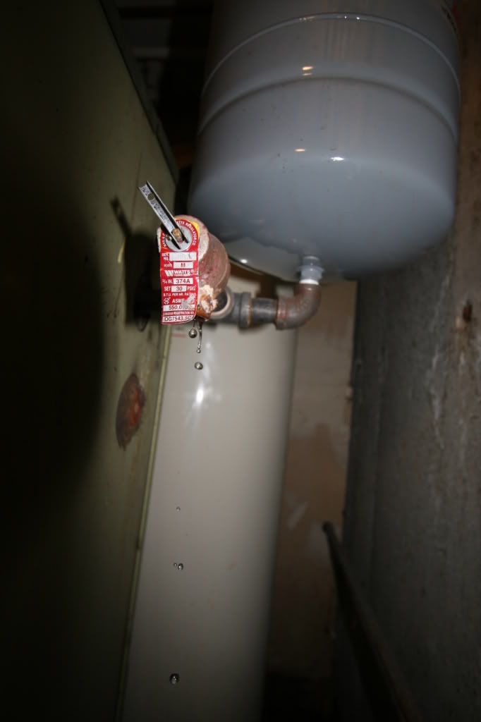

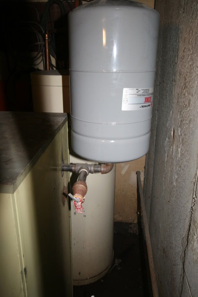

Here is the latest: I watched a few cycles and monitored temps/pressure using the new data.
When the system heats up (set ~175), the pressure rises with it. Normal.
The boiler gauge reads 28, my new pressure gauge reads 25psi. At this pressure the pressure relief valve has a steady drip. Not quite a continuous stream, but almost.
Pics below. Note this PRV has been replaced. Also note it is attached in the back of the boiler, in a T with the expansion tank. Being directly attached to the back of the boiler with a short section means it gets really HOT. ie: boiler water temp.
When I look at the old one, it looks to have a rubber seat/spring design. I wonder if its getting just too hot for operating properly (essentially the rubber fails??)

If the pressure is rising to 28 PSI with temperature, then the pressure relief had better start relieving the pressure! It is doing its job.
I suspect your bladder tank is water logged. It should have about 15 PSI of air pressure in the bladder to accomodate water expansion with temperature rise. If the air pressure is gone, due to a ruptured bladder or gradual loss of air, then there is no mechanism to allow for water expansion.
One small nitpick. The pressure relief valve discharge should be discharged to within a few inches of the floor to prevent deadly scald hazzards.

You wrote that the boiler mounted gauge read about five psi below the "accurate" gauge you connected to the drain. Then you wrote that the boiler gauge read 28 while the accurate gauge read 25.
Which is it? Does the boiler gauge read high or low?
Actually, forget the boiler-mounted gauge and just read the gauge you attached to the boiler drain. (You do have the drain valve slightly open so that the gauge is reading the variations, don't you?)
The safety valve is supposed to be mounted as close to the boiler as possible so the idea of it being "too hot" is incorrect. It should, however, be mounted so that the stem is vertical, not horizontal as it is.
Try this: Lift the lever on the safety valve and let it blow good and hard for a second. (Install a pipe nipple on the discharge port and use a bucket to catch the water. Also wear a glove on the hand lifting the lever,) It is possible it has a bit of rust under the seat and that is preventing it from closing properly. This will, of course, lower the pressure in the system and you will need to monitor it to be sure it doesn't drop below the 12-15 psi minimum.

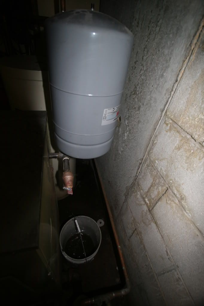

fair point furd, and the difference between the two is not consistent (I incorrectly stated it was.... but after watching more it seems they are not). So I am using the new gauge - on the drain connection and yes cracked to let it pressurize.
I cracked the relief valve to let it run a bit, and then did the same to the makeup regulator (I connected a purge line and then while purging a loop cracked the regulator a bit.... thinking along the same lines as with the prv).
THEN - I replaced the expansion tank. With the old tank off the system I was able to determine it would pressurize with a tire pump, but then relatively quickly lose pressure again.
REPLACING THE EXPANSION TANK SEEMS TO HAVE FIXED THE PROBLEM.
No prv releases, and now the system is maxing at 18psi when it cycles. I dont know what is 'normal', but this is down a LOT from prior and below the prv set point so makes sense.

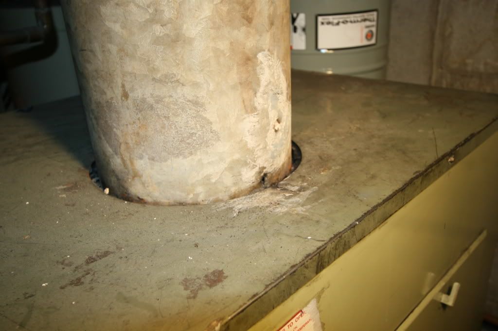

As another item, I noticed a couple small holes in the exhaust stack, noted in the pic. They are 180 degrees apart, right where the stack meets the top of the boiler, and I believe were screwholes once holding the stack on (and it appears to once have been covered with cement, but no longer). I dont know if this is a double walled pipe, but if not does this mean I am pumping exhaust into my basement? (I do have recent, and redundant CO sensors in my home)
What do you think?

The expansion tank is usually the cause of excessive pressure excursions but there are other things that could cause excessive pressure so it is necessary to look at all the possibilities. Glad the expansion tank did the trick for you.
That is single-wall smoke pipe on your boiler. Since there is a negative pressure in the chimney it probably isn't necessary to change the pipe. You can use a smoke source (cigarette or blown-out match) at the holes to see if the smoke is drawn in.
The 18 psi is just fine.
