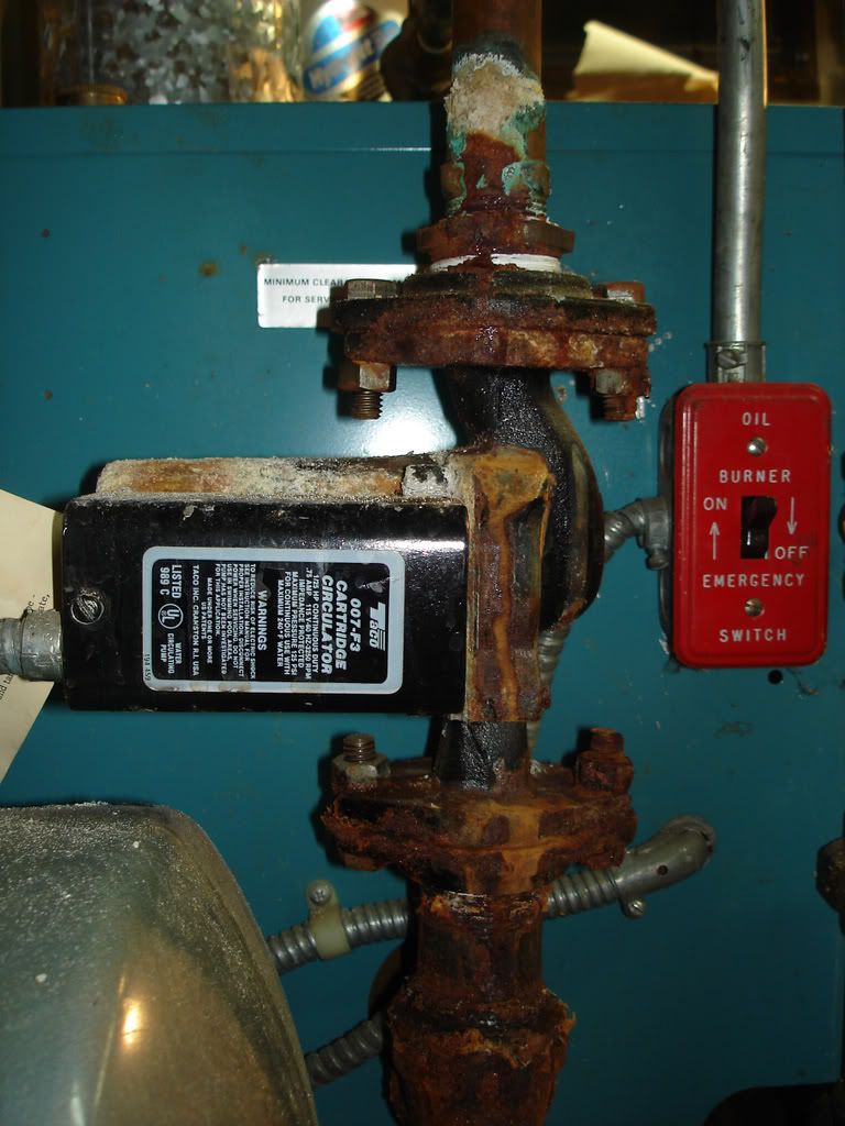

Good pics! thanks...
A few 'issues' first, then the purge routine.
I believe the part you are calling the 'pressure relief' is actually a float type automatic air vent... and it's damn near broken off! The relief valve is the thing next to that, with the lever on top and the green tag wired to it. Those air vents must be vertical to work properly... it's like a float in a carburetor, when air collects in that can, the float drops, the little valve on top opens, and the air escapes, water comes in, float raises, valve closes. Bottom line is that part needs to be replaced. And when you replace it, the cap on the tire valve on top needs to be loose to allow any collected air to escape. They aren't supposed to leak water.
Circ pump ... that's not 'condensation' as you called it previously... that's a LEAK... and it appears that it's coming from the joint where the copper pipe meets the threaded adapter that the top flange is screwed onto. Water has been leaking from there and dripping down on the whole works for quite a while.
There a plug in the 'vent' port on the bottom of the backflow preventer. If that was put in to stop dripping from that port, instead what should have been done is the valve removed and cleaned or replaced... then, that port should be piped down and out toward the floor or a drain or a bucket...
So, what to do first? Well, the pump is the reason you came by...
I'm not buying this at all. How long has it worked so far? Ten-fifteen years? why would you alla sudden have 'too much flow'?
If it were mine... I would try to wait until warm weather shutdown... then I would replace the pump. I'd replace the flanges with 'isolation flanges' (the ones with shutoff valves in them so you can change a pump without draining the system).
I would strongly consider moving the expansion tank connection to the system to the suction side of the pump. Google 'pumping away' for more info on why... ...or CLICK here and read this PDF...and install an 'air separator' at the same time. The tank should be tested while you've got the system down and either re-charged, or replaced as necessary.
Since the system is drained, now is the time to change the float vent... AND... if that relief valve is 5 or more years old (I'm sure it is) I would replace that too. The pressure gauge is most likely NFG, so that would get replaced too.

Flange by circulator is now dripping. Suspect that as system heated it expanded flanges and stopped leak. Now that system was "cold" it allowed drip to start.

Obviously you need to do some work on that pump, but before you go much farther, you really need to verify the pressure in the system. Have you seen this thing?:
Screws onto a drain valve ... open drain, read pressure. For $10 or so, you can pick up a gadget at HD or Lowes that sprinkler dudes use that screws onto a hose bib and has a 0-200 PSI gauge on it. Obviously the gauge won't give you the resolution you need to be of any use, but for another $10 you can pick up a suitable gauge and just use the fitting... or hack one together from junque like I did.

1. Only drips/leaks are below circ. cartridge flange as ID on photo. I used small amount of pipe dope on female threads and good amount of PTFE tape on all Male. Only leaks are the ones shown. All solders and other treads are tight. Why just these???
I tightened them down in a vise on the bench top as I did others and used identical protocol. Very frustrating. Do you have any great tips for getting all Threaded joints perfect the first time????

1. I believe that more than 1 wrap... 2 at most... of the teftape is enough. The 'seal' is supposed to be made by the interference fit of the tapered pipe threads themselves... metal to metal. The tape is really just a 'lubricant', and shouldn't be relied on as a 'sealant'. Too much tape can prevent the threads from mating... more is not always better! If you do take it apart again to fix the leaks, I would recommend not using galvanized fittings... use black iron. In any case though, I would use new nipples. Make sure there are no chips or dirt in the threads... use a wire brush to clean.
