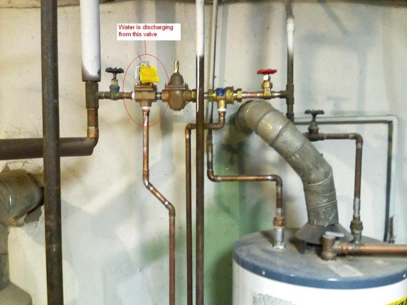

Here are some pics of what I have going on:

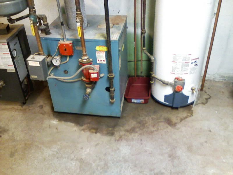

Here is a pic of the system before I did any work on it:

Is there an expansion tank for the water heater? Unless this system is on a well there needs to be one. IOW, if on city water need an expansion tank for the water heater.
For the boiler, isn't the pressure relief valve near the expansion tank? In the upper left of the first picture, off the front left corner of the boiler.
Al.
Al.
You really only need the expansion tank on the water heater if there is any type of CHECK VALVE on the cold side feeding the heater. If the city water comes straight into the home without a pressure regulator or check valve, no tank is needed, as the city system will absorb the pressure increase. SOME city water system pressures are very high, and these homes will have a regulator to drop the pressure, and there is a check valve in those regulators.
Yes, I see the proper relief valve on the boiler also. I'm not sure why the other one was added? That second one next to the regulator is not an ASME approved model. You don't need it if the one on the boiler is good to go... I would just take it out and replace it with a piece of straight pipe and be done. The one on the boiler isn't leaking, right?

I may be wrong but I thought city water feeds are required to have back feed prevention. Built into the water meter?
Where I was going is that excess pressure on the feed regulator valve may be causing the boiler to over pressurize.
#21
That's right, it shouldn't drip anyway... so try the snapping shut idea and see what happens. If you shut the valve between the boiler and the relief valve you can use the water supply to flush through instead of letting it out of the boiler...
You could also plug it, but if a home inspector see that, he might go bananas, and you wouldn't be able to explain it to him...
