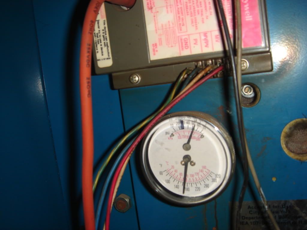

I have a Governale RM 22 US II Gas Boiler. I finally got it heating, but the pressure gauge says 50 PSI,Is that too high? Last winter the plumber had to come because the basement was flooded with water gushing from what i assume was some sort of pressure release valve. How do I get the pressure down?

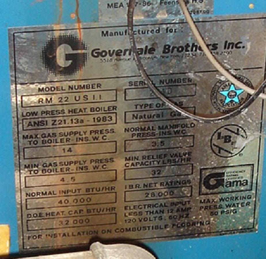

The FIRST thing to do is to look on the boiler's name plate and see what the Maximum Allowable Working Pressure (often abbreviated MAWP) is for the boiler. While most residential boilers have a MAWP of 30 psi there are some that are rated at 60 psi.
The SECOND thing to do is to inspect the safety valve. Make sure the outlet of the safety valve is not plugged in any way. Look at the tag or name plate to check the set pressure of the safety valve, it should be the same as the boiler's name plate MAWP.
If the safety valve outlet is not plugged and the set pressure rating is in agreement with the boiler's MAWP then you can proceed with several other tests and/or replacements; the first being to lift the handle on the safety valve and blow a quantity of water through it. Watch the pressure gauge when you do this to see if it quickly drops in pressure and how fast the pressure returns to the previous reading. You may have a defective pressure gauge.

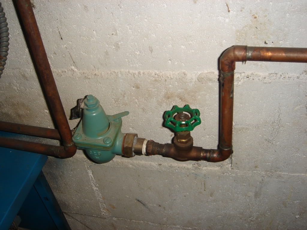

Join Date: Oct 2009
Location: NY US
Posts: 21
Received 0 Upvotes
The pressure releif valve looks new and says 45psi. When the boiler is cold the boiler gauge also says around 40 psi.

I don't see a pressure relief valve in any of the pictures?
If the relief valve is set at 45 PSI, then how come the boiler gauge is showing above 50 PSI ?
Are you confusing the RELIEF valve with the REDUCING valve?
The Green valve is a REDUCING valve.

As Trooper stated, 40 psi is too high (cold) for a four storey house and a 45-psi relief valve - 27 psi is more like it. Did it possibly get up to 40 by you or somebody overfiling the boiler? What is the automatic fill valve set for? Maybe it's leaking past the seat? Troubleshooting time.
Bourdon tube gauges sometime read high if they are old. I would replace the gauge.
Do you notice the black mark somebody put on the gauge - showing the normal cold pressure? That mark looks to be right at 27 psi, or I'll be a monkey's uncle. Clearly, something is not as it should be.

Yes. Are you going by what the tag says is the factory setting? 12 psi wouldn't lift the water up to your fourth floor or even the third. Please post a picture of the tag on that valve.
My guess is that the person that originally installed that fill valve adjusted the stem to give 27 psi (cold).
Turn off the boiler, let it cool, and drain water from the boiler drain valve until the pressure gauge shows, say, about 25 psi (cold). Then see what happens over a few hours or a day or so (keeping an eye on the gauge).
If the pressure creeps up on past 27 psi (cold) and beyond, then your auto fill valve is leaking through and must be replaced. Until you can get it replaced, drain the system back down to 27 psi, and shut the city water valve feeding the fill valve - you can continue to operate temporarily, but get it replaced ASAP.

Heres the Pressure reducing valve with the 12 psi original setting.
Boiler :: prv12psi.jpg picture by mrsoze00 - Photobucket
Heres the album of boiler pics. How do I know the water drain valve, there is nothing down towards the bottom of the boiler that would look like it. and if its above I dont want to confuse it with the return pipe.

I dont think its a faulty pressure gauge, because the pressure gauge for my 4th floor neighbors boiler says the exact same thing, 40-45 psi when cold. And the gauges for the lower floors both say 10-12 psi. I think he increased the boiler pressures for the high floors (but too high) and kept the pressure down for the lower floors.

From your photo of the fill valve, it seems that somebody has loosened the adjusting stem to change the setpoint - and didn't bother to tighten the lock nut.
But anyway, like Mr. Fixit said before. Likely your automatic fill valve is leaking through. I would replace it wlthout further ado.
Just because the gauges on two separate boilers read the same does NOT mean that EITHER or BOTH are accurate. That is flawed logic. What's that all over the front of your shirt? Looks like spit!

Running perfectly at 25psi cold and 30 psi hot.
While it was cold I let some water out of the system and that was all it took. As I was doing that I watched the pressure gauge and it immediately started dropping from 40 cold to 25 cold. Its now stabilized at 30psi hot instead of 50psi hot, and its nice and warm in the rooms.
