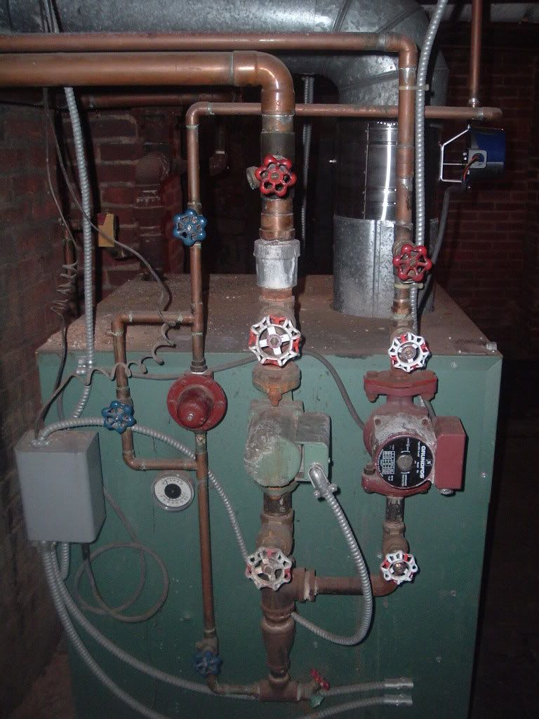

Boiler pressure gauge
Last night when my boiler was running the presure was over 30 psi which I am not sure if it is good cuz before when I bleed the 2nd floors radiators no water came out, just air, now water comes out when i bleed them my concern here is the presure to high? Last night water was driping while it run I check the presure this morning while COLD and it says 25 psi.
My question here is is the presure to hight and thats why it drips water??

Yes, the pressure is too high...
You say it's dripping water, and that would be from the PRESSURE RELIEF VALVE, is that correct?
I'm posting the link to your photos...
Lizzy's Boiler

If it's the one with the yellow tag on/near it, then yes, from what I can see it does appear to be your Relief valve.
I think the bigger question is why/how did the pressure increase in your system since that last thread! Then it was at 15 PSI, which should have been OK...
Let's look at this picture:
First, the water feed... the skinny pipe on the left side that comes down from the ceiling, first to a blue handle valve, then splits to a red bell shaped thing (that's your Pressure Reducing Valve), and another blue valve (don't touch this one, leave it tightly shut), then comes back together again, and down to another blue handle valve, then into the larger boiler piping.
If the red Pressure Reducing Valve is leaking, it will slowly cause the pressure to rise in the boiler. Same with the blue handle valve to the left of that. You won't actually SEE the water leaking, because it is leaking through the valve and into the boiler.
Where these pipes go into the boiler is a hose drain valve. Be advised that sometimes these valves don't close completely after being operated after a long time of being closed!
You can drain pressure off the boiler with that, or actually any other drain valve on the system. Hook up a hose, and slowly open the valve and watch the gauge. Drop the pressure to 15 PSI cold, and close the drain. If the drain valve does not stop dripping after you do this, you will need to go to the hardware store and pick up a brass cap to stop the dripping until the spring when you can change the valve.
After you close that drain, keep an eye on the pressure gauge for the next few days to see if the pressure starts to increase again. If it does, let us know and we'll tell you more.

when u say hook up a hose do u mean on that red valve all the way on the bottom? I apologize just want to make sure i do what u say, and the after i hook the hose ope the red and let water run until the presure is 15 psi?
Yes, that one, or any other hose drain on the system will work to drop the pressure. Please remember that the valve may or may not completely close again if it hasn't been openend in a long time! If you have never had that one open, and there is another one that you have openend, and you KNOW closes without dripping it would be better to use one that you KNOW will close again...

Mr. Trooper you are awesome I got the presure to go down so now is 15psi, when cold, the valve luckily closed all the way. I apreciate all your help as always.

Great! Like I said, now keep your eye on the pressure and let us know if it starts to rise again... then we have to talk about why that might be...
IS this installed correctly? All the PRV's I've seen say to mount horizontally (this one is vertical), with the adjusting screw facing up.
I looked at the B&G instruction manual for the pressure reducing valve. It does not explicitly specify the orientation of the PRV. But it does have a drawing of the "typical installation," which shows the valve with the adjusting screw pointing up.
The PRV's disc is held down on the seat with a spring. So, I "think" the orientation shouldn't matter.
I did learn something else from the instruction manual. B&G says that there must be a manual shutoff valve installed in the city water supply ahead of the PRV...and the shutoff valve must be kept closed except when filling the system. I had always thought that it was optional whether to run with the shutoff open or shut.
