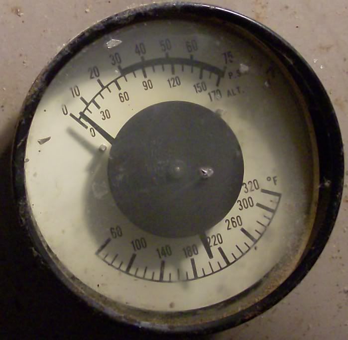

The guage is in a very awkward spot to see, but I did get a picture.
It looks like it is at about 200 degrees with a pressure of perhaps 4. I honestly do not know what the pressure is supposed to be. We have been in the house about five years, and had a problem with the pilot light last year, but otherwise it has been trouble free.
Nothing seems to happen when we turn up the thermostat for the zone that is not working. However, the other two zones have heat.

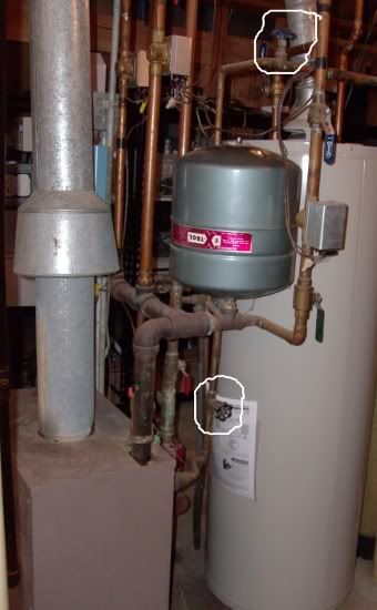

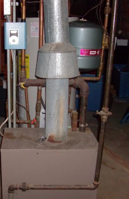

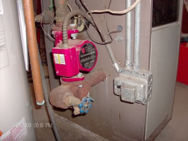

The Boiler and Pump
It is embarrassing to show how little I know about my heating system. Just take it for granted until there is a problem. There is one pump, and I think these are transformer valve assemblies controlled by the thermostat. If I am wrong, please let me know.

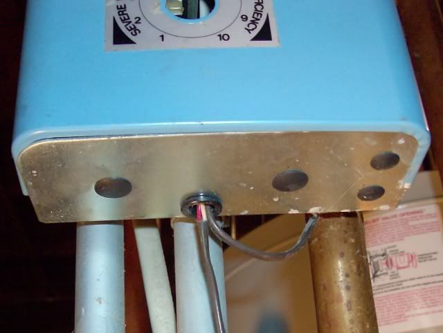

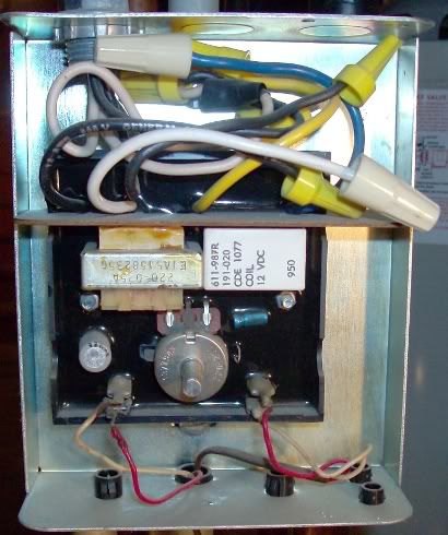

Here is the bottom of one of them. I think this is for the basement and may not have the wires for the air conditioning. The others have so many wires that it was not easy to get a clear picture.

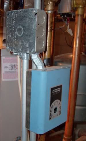

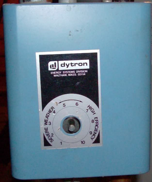

Here is one other piece of equipment, and frankly I do not know what it is.

OK, the pics do help a lot.
Very often (TOO often for me) those pressure gauges are liars. If yours is telling the truth, your pressure is VERY low in the system. In general, the MINIMUM pressure in a boiler system would be 12-15 PSI when the boiler is cool, i.e. room temp. This pressure would increase when the system is hot, depending on some other factors, it could increase as little as a few PSI, or could go as high as maybe 25 PSI.
One thing is certain, the pressure gauge accuracy needs to be verified, and if the pressure is really only 4-5 PSI, it needs to be determined why, and corrected.

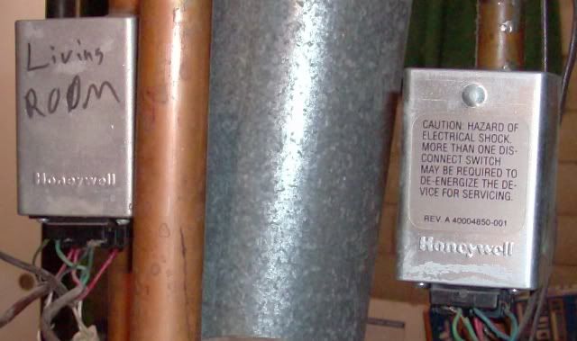

The things you are calling 'transformer valve assemblies' are your ZONE VALVES, and they appear to be Honeywell 8043 series. Since you have three zones, you should have three of these valves.
How they work:
Your thermostat is basically a switch. When it calls for heat, it switches 24VAC from the TRANSFORMER (there should be one around there somewhere, probably mounted on an electrical box) onto the terminals labeled TR and TH on the valve. You can use your multimeter to measure those and see if you are getting 24VAC on those terminals when the thermostat calls for heat. Obviously each thermostat controls one zone valve.
When the valve opens, it activates the ENDSWITCH (turns it on, closes the switch). This ENDSWITCH will then in turn activate the boiler.
The most common problem with these valves seems to be that the endswitch stops making contact, and doesn't signal the boiler or pump to operate. The valve may in fact be opening, it's just not passing the info to the boiler.
Also, the motor inside the box could be burnt out and not opening the valve, but the symptom will be the same, no boiler operation. You will still see 24VAC at the TR and TH though.
The ENDSWITCHES are all wired in parallel, so that any one of them may operate the boiler.

If you find that you do not have 24VAC on one of the valves, then the problem is with the thermostat or the wiring.
If you find 24VAC on ALL THREE valves, you know the problem is not with the thermostat or the transformer. If all OK so far, continue below.
Next, clip the meter on any pair of the ENDSWITCH terminals. Since these are all wired in parallel, you don't need to move the meter around for the following tests. You should see approximately 24VAC on these terminals when NO HEAT CALL is coming. When any one of the valves is open, there should be ZERO volts on the ENDSWITCH terminals.
Turn thermostat 1 all the way up. See zero volts on endswitch. Turn 1 all the way down.
Turn thermostat 2 all the way up. See zero volts on endswitch. Turn 2 all the way down.
Turn thermostat 3 all the way up. See zero volts on endswitch. Turn 3 all the way down.
If one of the thermostats does not act as above, the problem is with the endswitch (or the motor) in that zone valve, and the powerhead on the valve should be changed.
I believe you are going to find that one of the valves is not firing the boiler.

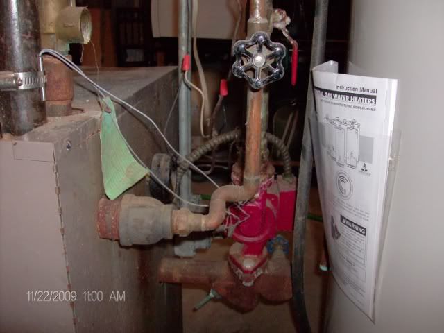

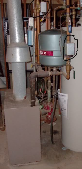

Here is the boiler from the back:
Here it is from the side:

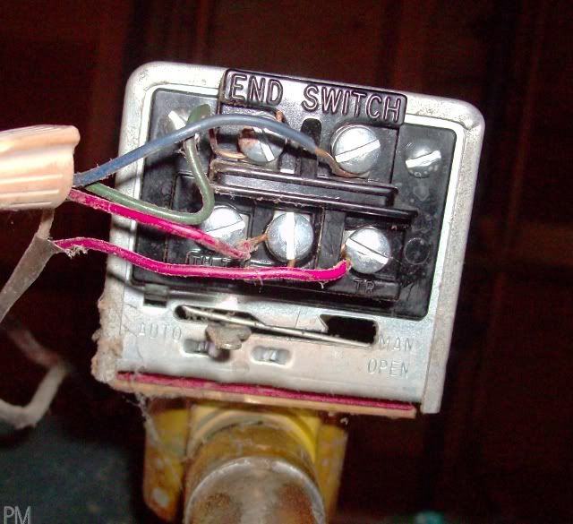

Here are two of the zone valves. Both of these are for the upstairs, and the one on the left, labeled "Living Room" is the one without heat.

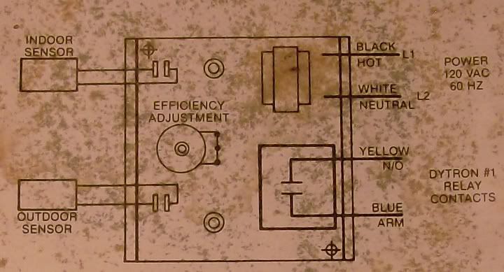

Is the transformer a separate unit?
Here is a basic diagram of how the zone valves might be wired:
This is only showing two valves, but if there were a third, it would be wired the same way. In spite of the fact that there are no 'labels' on this drawing, it should give a good idea of what you are working with there.

OK, good work.
No the pipes don't have to come apart.
Since the pump and the burner are working when you turn the LR thermostat up, it means that your problem is NOT with the thermostat or the zone valve. That part is working just as it should.
To recap, you SHOULD see 24VAC on TH and TR when the thermostat is calling, and if the valve is opening and calling the boiler, the 24VAC at the endswitch SHOULD drop to zero when the valve opens.

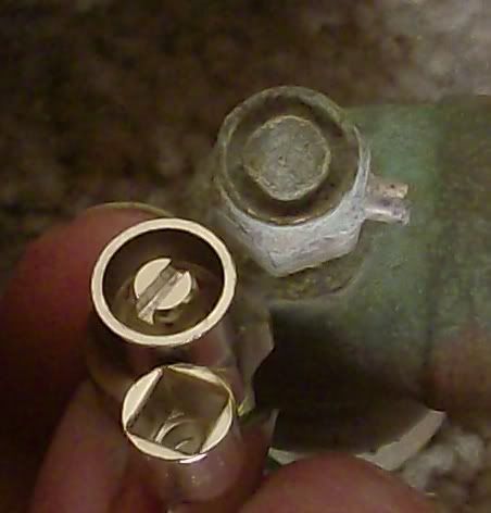

What this means is that you have an AIR BLOCK in that zone, and it won't be long before other zones follow. This is because of the low pressure in your system.
As said earlier, 12-15 PSI is the MINIMUM pressure you should have in your system. You have 4-5 PSI. It takes 0.432 PSI to raise water in a pipe 1 foot. On top of that, you need a few extra PSI to ensure that the pressure at the TOP of the system never goes below zero. If you do the math, you will see that 4-5 PSI will get you up to maybe 11 feet above the boiler. If the boiler is in the basement, and the LR zone is more than 12 feet above, you won't have any water flow in that zone.
Additionally, the location of your circulator pump relative to the location of your expansion tank means that when the pump runs, it will SUBTRACT pressure from the system. So, even if that LR zone is less than 11 feet above the boiler, it's very possible that the pump subtracting pressure is pulling the pressure in the system below atmospheric.
Even more... there should be a device sometimes called an 'air scoop' that scours the air bubbles from the water stream and vents them from the system. You don't want air in the system because it can stop the flow. I don't see such a device in your pictures.

Air added and pressure gauge jumped up to 15 psi
Adding air to the expansion tank caused the pressure gauge to jump to 15 psi. It looks like that might be working.

Pictures and some heat
Here is one faucet where the water enters the furnace.
There is another one above it on the same copper pipe. just above the expansion tank.
There are three drains. One is directly below the pump. The other two are below the original zone valves. I could not find a drain for the more recent zone valve for the addition. That valve is shown in the above picture between the two circled faucets. At least it has shut off valves above and below it.
I still have not been able to find a dome shaped pressure reducing valve. I thought it would have been between the two faucets on the line going into the boiler.
The good news is that we are getting heat. It heated up to a little over 70 degrees. It is pretty warm outside here, so not sure what to expect when it gets cold again.
Thanks again NJ Trooper.
Jerry
Jerry

Some lightweight googling couldn't turn up any documentation. I'm guessing it's a basically a high-limit that one can adjust depending on season/condition. The flat of the knob is pointing toward about 3.5 "severe weather", so high limit is probably close to 180.
#21
I thought the same thing about the Dytron... I did find a few references to the company in Waltham, MA, but they were all dated back in the 80's... and involved in 'Thermodynamics'. So, it's very possible it was a business they were in for a short time and then out again. I would trace the wiring in an attempt to figure out what it is, and whether it's still functional or not. But that's for another day...
It doesn't appear that you even have a reducing valve. Some systems don't, and rely on the manual feed. The homeowner would need to know when to add water to the system. And now you do! You would SLOWLY! open the top one a bit, not all the way, just a bit, and then SLOWLY! open the bottom one to let water in. Watch the pressure gauge as you do so, and never dump water in when the boiler is HOT. Always wait for it to cool to under 100°F.
more...

More Info on Dytron (Blue Box)
Thanks again for all of your help NJ Trooper.
Surprisingly, there really is not any sound of water and air rushing in the baseboards. We unhooked three of them, but have not found the bleeder valve yet. We'll keep looking.
Here are some more pictures of the blue Dytron box.
There is 110 coming in at the top.
I'm betting these are 24 volt AC coming out the bottom. Is there any chance this could be the transformer? The red and white wires on the left go down to the boiler. The wire on the right goes up to the ceiling and possibly to the thermostats.
I did a Google search on Dytron Waltham MA and this thread was number 1. Below it was a listing on a surplus site for something that might have been a transformer for a telephone made by them.

#28
In the one pic that Xiphias commented on, that shows a temp sensor with gray wires hose clamped to the pipe... where do those wires go?
Pop the cover off, let's see what's inside!

Inside the Dystron Box
Looks like it has something to do with the central air conditioner.
This was inside the cover.
Here is a wiring diagram. Could not really see this drawing until I took a picture of it and zoomed it up.
Thanks so much for all of your help. I have to get up at 4:15 in the morning, so this is a project that will have to wait until next weekend. Thank goodness we have heat. I could never have gotten this done without your help. Our other zone is also so much more comfortable.
Jerry
St. Peter, Minnesota
Jerry

Now that I think about it, this probably is a temperature sensor like you mentioned. The severe weather setting makes me think that you could have it set on high efficiency most of the winter and then if there was extreme cold, you could move it over to the severe weather setting. Severe weather seems more like a cold winter night than a hot summer day. At least in Minnesota.
Edit added -- You asked where the wires go. The one set goes to the boiler, and the other set on the ceiling seems to go outside. It goes directly to the wall near the central air unit, and then it is covered with insulation.
Jerry
Jerry

That is an OUTDOOR RESET CONTROL, as shown on the label. What that is 'supposed' to do is vary the boiler water temperature based on the outdoor (and apparently indoor) temperatures... by lowering the water temperature when super hot water is not needed, fuel is saved.
Howsomever, I'm sure that at some point it malfunctioned,and it appears that it has already been disconnected.
Notice that the black, white, blue, yellow wires from the board are not connected to anything, and just wire nutted with no connections.
So, I wouldn't pay it no more mind.

Pictures of the Bleeder Valve
Thank you NJ Trooper. It is always a good idea to ask me to take a picture. I got some more light on the bleeder valve and blew up the image. The "putty" was just dust and dirt, which I cleaned out.
We did not have a bleeder key, and the one I bought (with a new valve) does not fit into the existing bleeder valve. The existing bleeder valve is at the top, the new key is at the bottom, and the new (unattached) bleeder valve is in the middle.
Here is a picture of the zone valve with a ball valve (circled) above it. There is no ball valve below it, at least not on the same pipe. The circled ball valve is just above the cold zone valve. I left the circled ball valve open and closed the other two ball valves just above their respective zone valves.
Here is a picture of the drains. I moved the hose over to the blue faucet and used this faucet to drain the boiler while adding water. I think this is the drain for the cold zone, but I am not sure.
Right now, the cold zone is actually a comfortable 68 degrees. The thermostat is set a bit over 70. The purging last night actually did help. I am puzzled that it took 24 hours to get this zone up to a comfortable level. I also suspect that all the water I flushed through the system last night will release bubbles and cause another airlock.
Thanks for pointing out the way to manually open the drain valves. I had not even noticed them on the pictures.
Right now the temperature is quite comfortable. I am tempted to just leave things as they are and see what happens. Below zero temperatures are expected in the next couple of days. Should I try and find a key that would fit the bleeder valve?
Thanks,
Jerry
St. Peter, MN
Thanks,
Jerry
St. Peter, MN
#40
You can leave the ball valves above the ZONE VALVES alone.
The ball valve I want you to close are these:
This combination of a drain with a shutoff below it is known as a "Purge Station". If you don't close the lower valve, the water you feed in will just go through the boiler and UP from the boiler, through the circulator, and out the drain valve.
By closing that ball valve, and opening the respective ELECTRIC ZONE VALVE, you will force the water up and through the zone, and out the drain.
If you can't find a key to fit, then you will have to replace. If you close the ball valves to and from that zone, and open the drain on that zone to relieve the pressure (you don't have to drain it, just relieve the pressure), you should be able to change that bleeder without draining the system. Put some old towels around, just in case!, but if you have no pressure in the zone, and it is ABOVE the boiler, you should not get any (much) leakage.
