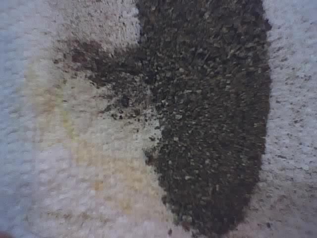

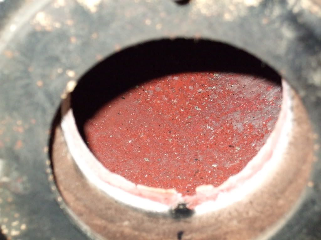

Not sure if this helps but here's an attempt to show you what I am seeing:
Viewing Carrier boiler cleanout:
Sample from chimney flue cleanout .. water was added and leached onto paper towel:
Sample collected on a white piece of wood placed near my chimney on the roof:

As for the dye burning completely... I think my experiment has shown that to not be true... BUT:
The appearance of your flakes is completely different than what I was/am getting. The stuff from my boiler is only in the combustion chamber, and stays in the combustion chamber. None of it becomes airborne and flies up and out the chimney. My flakes are obviously forming on the fireside walls of the combustion chamber, and falling off. They are the size of 'wheaties', but very fragile... once you touch them, they turn to red dust.
It was Carrier that suggested a leak, and to replace the boiler? and you paid to ship the boiler to them, and they tested and said 'No, it's not leaking' ? I sure hope they reimbursed you for the new boiler!
