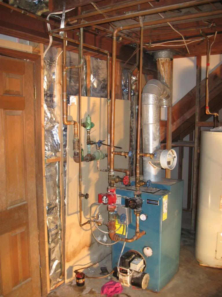

We recently purchased a foreclosure house and this is my first experience with a boiler system. The boiler is older (not sure what year) and does not have zones. It is a Burnham oil fuel low pressure boiler system (RS-111). The radiators are the smaller baseboard units. The system pressures to about 20 psi and the boiler heats to around 180-190. The problem is the water does not circulate. It was on for half the day and I did not feel heat in any of the pipes except within a few feet of the boiler - I have heard others talk about gravity working, but no heat made it to any radiators in my case. I bled out all the radiators many times so I do not think that is the problem. I do not know if the circulators are working. I do not hear anything - should I be able to hear a noise? The circulators did feel hot. One of the circulators looks just like the one pictured on:
Troubleshooting a Hot Water Boiler - Noisy Pipes.
Circulators are Bell and Gossett. One is a NRF-22.
I have a photo of the system but it is not on a URL (how do I put it in my post?)
Spent all day w/o success today, any quick ideas/troubleshooting to try tomorrow would be very helpful.

I did not hear much of any noise from the circulators. I am not sure if they are working. I never had a boiler system before - what should I hear? What should the circulators sound like?
Thanks for the photobucket info. Here is a photo of the system.

Sorry the photo didn't make it. Try again please.
Circulators shouldn't make much if any noise. Sometimes you can feel them running. Also touch the motors to see if they are warm or hot.

Circulators were hot
The circulators were hot.
I think the photo made it after my edit. Hope it helps.
Any things I can do tomorrow to narrow down the problem and/or try to troubleshoot?

You can use a screwdriver as a 'stethoscope'... put the handle to your ear, and the pointy end on the circulator.
If you have a multimeter and know how to use it, and are not afraid of 120VAC (in other words, are aware of the dangers) you can measure the voltage to the circulators... you say they are hot so I'm pretty sure this is not necessary, but they could be hot from the water in them.
Dumb questions, but are the valves above and below the circulators OPEN?
Are there any other valves in the lines to the radiation that might be closed?
Are both circs running off the same terminals in the aquastat? (the gray box on the boiler that they appear to be wired to) and is there only one thermostat in the home?
You say that the boiler 'pressures to 20'... do you mean that it starts off at a lower pressure when cold, not less than 12 PSI, and when it heats up it goes to 20 PSI?
Somewhat unrelated issue:
In the upper left of that pic, there is a green thing (air scoop) with a brass can on top (air vent). There is a pipe on the bottom that turns and goes UP... is that pipe leading to a tank strapped into the joists above the boiler? If so, that's piped all wrong...
Pull back with the camera a bit and take some more pics so we can see the whole setup.

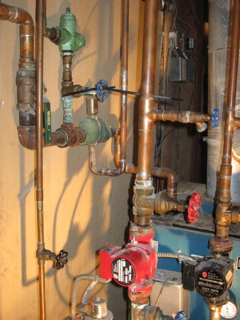

I restarted everything today and my first thought was that the red circulator was not working, but I didn't know where to go from there. It turned out that a plumber (hope this doesn't violate DIY board rules ) that helped me repair some pipes earlier came by and helped me go further. He discovered that someone had put a plastic zip tie on a closed faucet that needed to be open. You can probably see in 1st picture below (was out of view in earlier photo). Well that made a big difference. He then power purged the system just as NJTrooper was describing (I just missed your response before I left - but your advice was on track) to get the air out. In the end, the system still did not operate fully as the red circulator turned out be inoperable. I plan to replace this unit and then should be in business.
I hope the second picture clears up the question on the line running to the expansion tank. As you can see, there is a little more to it which may resolve your concern. The plumber did not mention any problem with the configuration.

Up close:
[IMG][/IMG]
Further Away:
[IMG][/IMG]
No, it doesn't... not at all. So just where IS your expansion tank, on the other side of the house? Seriously, where does that pipe go?
I'll bet your 'plumber' didn't say anything about the condensate dripping out of your chimney, rotting out your flue pipe either, did he?

I too wonder where that pipe off the bottom of the air scoop goes. I also noticed two what appear to be switching relays mounted on the wall below the switch. The one upside to the whole mess is the circulator (if it is indeed bad) will be easy to replace.

Yep, I seeum now Grady! What's weird though is the both circs seem to be wired into the aquastat. It looks as though there's also a transformer back there.

The pipe coming from the bottom of the scoop I believe does go to the expansion tank as you surmised. I will verify when I go back out.
I have the picture below of the expansion tank, but probably can't get everything in one shot.

One doesn't normally use an air scoop (green part to which tank is piped) with a conventional expansion tank & I would suggest replacing the conventional tank with a bladder type.
Said bladder tanks are normally screwed directly into the bottom of the air scoop but due to the proximity of the scoop to the wall, that would not be possible in this case. Since there is a trap between the tank & scoop you might still be OK with the conventional tank. In any case, there should be a shut off valve between the scoop & tank. Is there a drain valve on the tank?

It is hard to see, but there is a shut off valve with an air bleeder in the pipe running from the scoop to the expansion tank. In the picture labeled "Further away" you can just barely see the edge of the air bleeder and valve about half way up the vertical section (real hard to see as most is hidden behind another vertical pipe.).
The expansion tank does have a drain valve on the other side of the tank.
