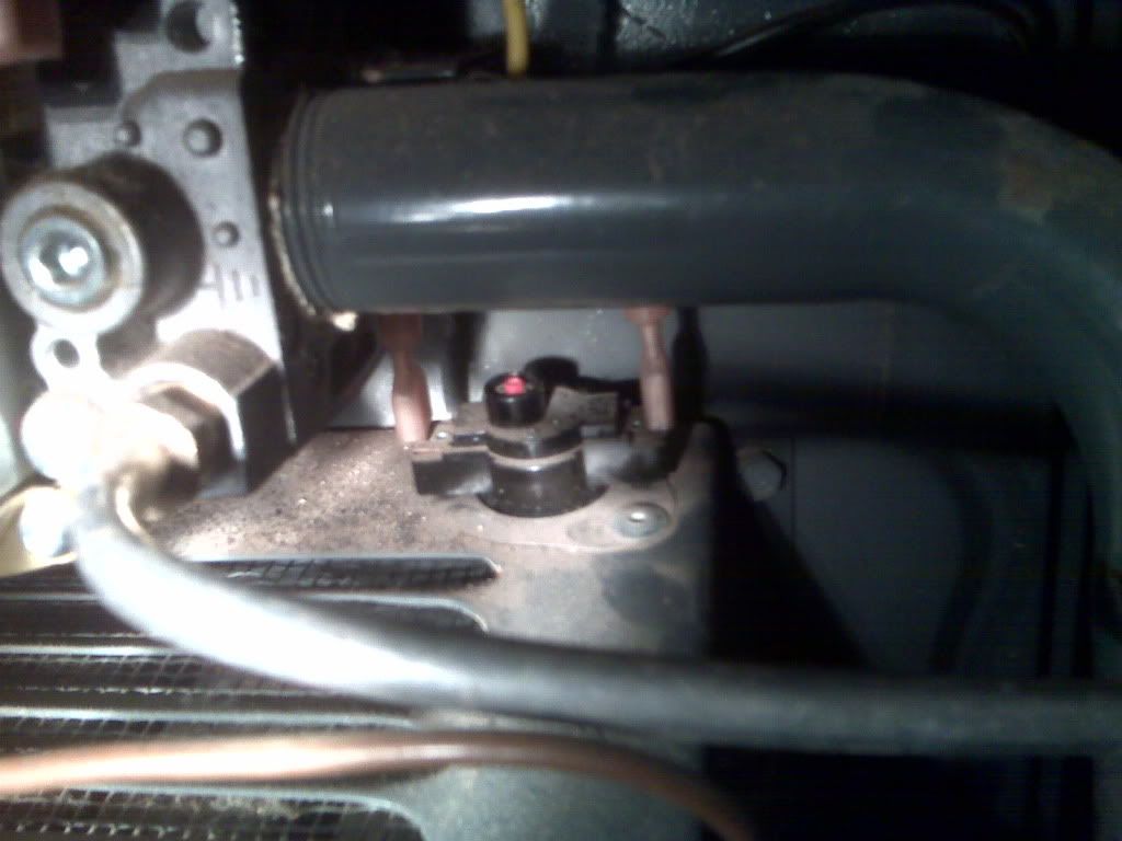

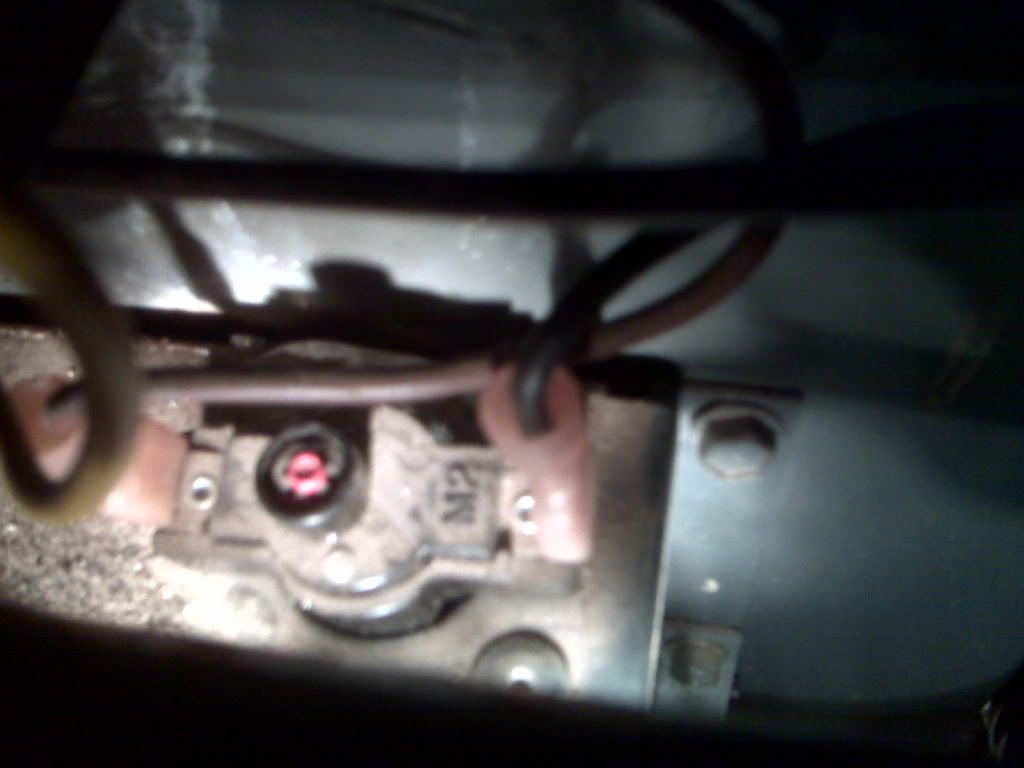

Referring to the above pic:
1. This is a SYSTEM BYPASS valve, and the Laars boilers require this valve to be OPEN. So, open it, and leave it open.
Has your boiler ever made any weird sounds, noises, etc? If so, it's because that valve is closed. One drawback to this is that the flow through the baseboards/radiators will be reduced, and the home may not heat up as quickly as it used to, but it will heat up and is something you just need to live with.
If you have the manual for the boiler, read it, and you will see that it needs to be open. If you don't have the manual, go to the Laars website and download it.
2. This 'streaking' on your flue pipe is a bad thing. That indicates that you have significant flue gas condensation occuring in the chimney, and probably in the boiler as well. This problem might be mitigated somewhat by opening the bypass valve...
3. I'm not a 'gas-head'... but your gas piping not only is probably not up to code, but those flex line stretched across the front of the water heater and boiler are dangerous... I'm hoping that one of the guys who is more up on codes and stuff will elaborate on that for me.
I didn't circle it, but fire codes require 18" from the flue pipe to any combustible, and those cardboard boxes are combustibles... as is the drywall behind the flue pipe...
Sorry you asked yet?

Circuit breaker on the controls inside the front panel box?
It's located on the right side behind the gas valve on the front of the boiler.
Can you show me a picture of this 'circuit breaker'?
Can you find a FULL model number anywhere on the unit?

That's NOT a circuit breaker ... well, it is, but not as you know it... I believe that may be the ROLLOUT switch. It's a temperature activated device that senses when there's not enough draft through the system, and the flames actually begin to 'roll out' of the boiler. This can also indicate that SOME FLUE GAS IS LEAKING INTO YOUR HOME

Let's see... you had the pressure problem, and from reading back the thread, it seems that has been corrected? You are running around 12 PSI cold, and maybe 15-18 hot?
We had talked about cleaning out the heat exchanger because the rollout switch was tripping out on ya... what's the current lowdown with that?
