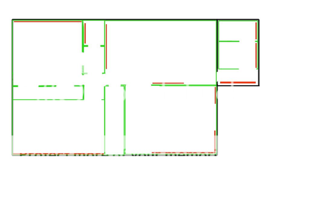

also here is the where the baseboards , this is a single pipe that covers downstairs
id like a little advice on how to break this up ? and what would be the best way to do so ?

now i have to diverge some, i need to split that zone into 2 (See the diagram picture , the red indicates where my baseboards are,the bottom right room is above the boiler. the flow goes out toward the bottom and flows to the left all the way around to that little detached looking room where it then goes into another smaller rad in the living room and finally returns to the boiler)

what i meant with that subject is that the flow check opens with the circulator on ... right ?
how does it know the circulator is on ? ... pressure ? if so how much ?
EDIT:
also just checked its about 100ft of baseboards ... all the piping for it im guessing is around 300' total .. should i be posting the questions about spliting/adding zones in a different section ?
EDIT:

#29
oh i definitely have a split since there are 2 returns vs 1 supply but i thought a "zone" means separate thermostat for each?
