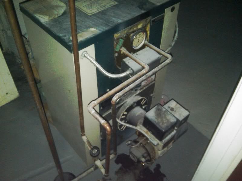

I just moved into a new house that has a Vaillant tankless water heater, model number F75-W-45 PP. The problem is that it only provides hot water for a very short period of time (5 minutes or so) until the water turns cold again. I thought that tankless water heaters were supposed to provide hot water indefinitely? I have left the water running long enough to ensure that this simply isn't a "cold water sandwich" problem.
The temperature on the water heater is not the problem I don't think, because when first turning on the shower, the water is piping hot. After about 5 minutes or so, though, the water turns cold again. I'm not sure what the problem could be.

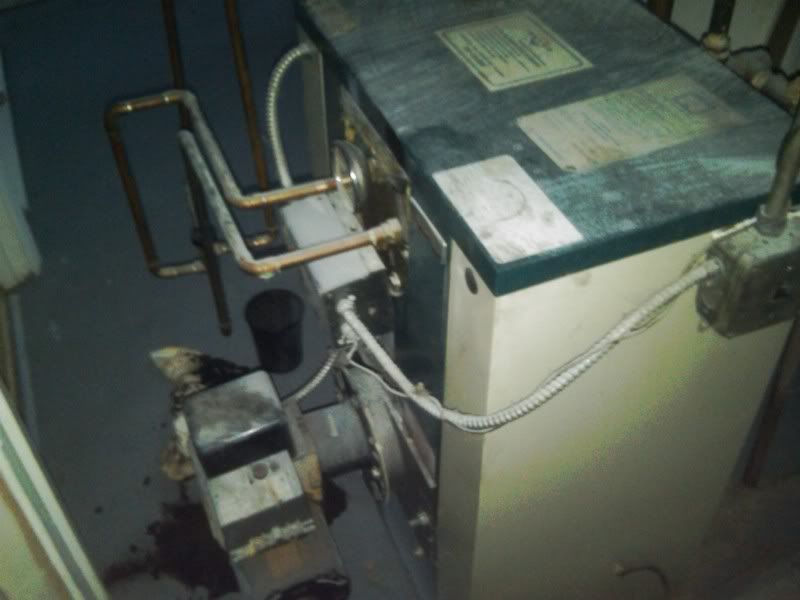

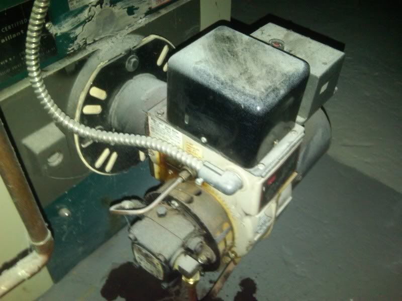

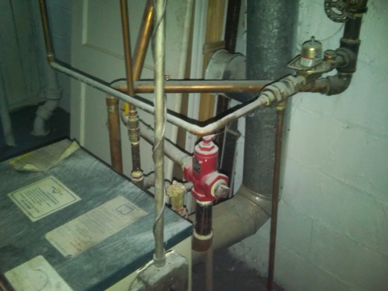

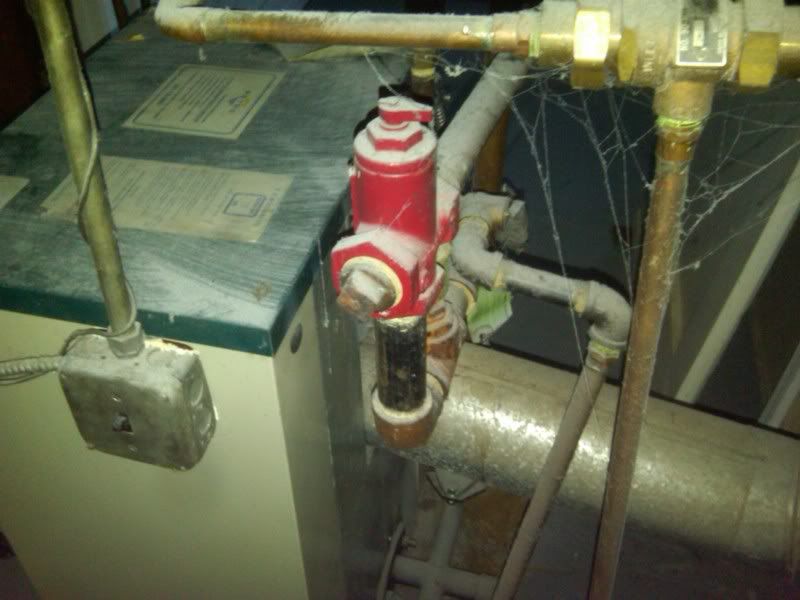

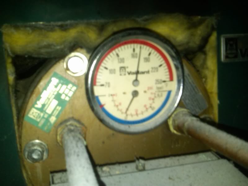

OK, I took some pics. I wasn't exactly sure what I should be aiming for so I tried to get what seemed like the important parts, lol. If you need a better angle on something then let me know and I will take a better picture. My camera isn't the best but I think it got the job done.

An important question is when the water is cool check the piping at the boiler. We already know the pipe from the mixing valve is cool but what about the pipe from the coil to the to the hot port of the mixing valve?
Vail, the 'mixing valve' that rbeck is referring to is that black handle valve to the left of the oil burner.
The cold water inlet to your coil is the pipe to the right side of the gauge, and the hot water out of the coil is obviously the one to the left of the gauge.
The black handle should be marked something like "cooler --- hotter" with an arrow indicating direction...
What position is that valve in now?

Well, I turned the mixing valve up to the maximum temperature, and that has made a big difference! I was only able to turn it about a 1/2 rotation or so, but the water temperature is noticeably hotter now, and the hot water doesn't disappear after just a few minutes.
While running the shower, I felt the pipes; the inlet pipe is cold and the outlet pipe is warm. I assume that is the way it is supposed to be?

I have observed the water heater while running the shower. I turn on the shower, and the water is hot. Soon after, the boiler turns on, and water remains hot. After a few minutes of running, the boiler turns off, and water temperature gradually declines for a few minutes, until the boiler turns back on, and water temperature jumps back up again. This cycle continues indefinitely. Is it normal for the boiler to shut off while I am still drawing hot water? Is there a setting I can activate to make the boiler stay on as long as hot water is being drawn?

Do this: and be careful... there is 120 VAC inside this box, so you might want to shut the boiler off before you open ... but that gray box on the front of the boiler, the cover slides straight off. There may be one screw that you need to loosen on the side... slide that cover off and tell us what the settings are on the three dials... HIGH, LOW, and DIFF.
I would set those temps at 160º low, 180º high and 20º diff. With the settings you are using allows the water to drop to 130º and only reheat to 140º. The temp setting should be 20º higher than the setting on the mixing valve.

These settings will allow the boiler to cool to 140, and heat to 160. The settings rbeck stated will be ten degrees hotter than that.
and see how that goes. Also, remember that the higher you set the LOW, the more fuel you will be using to keep the boiler at that temp.
You might even wanna set the mixing valve back to where it was. Your valve looks like the 'fixed' mechanical variety, and not the thermostatic type. All it does is 'blend' some cold with the hot coming from the coil, before it heads to the house. If you've got it all the way on HOT now, it's possible that it will be TOO HOT!
so BE CAREFUL! and when you make the change, please WARN other household members ... that the water may start out a LOT! hotter than it was! Hot water above 120 can be VERY dangerous... someone could even wind up at hospital... ESPECIALLY if there are children, or elderly in the home.
If you wanted more consistent temperatures, you could replace that mechanical mixing valve with a thermostatic one.

I changed the settings to Trooper's recommendations and the water is noticeably hotter again. Excellent!
