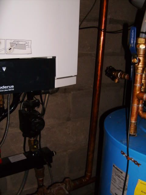

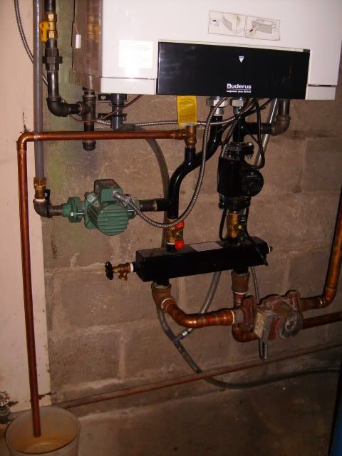

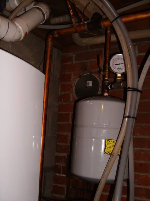

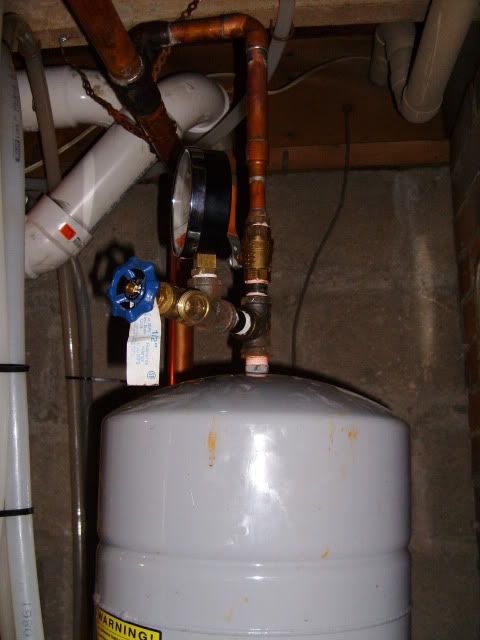

boiler pics

I was gonna suggest that you email me the pics and I'd upload them, but I guess it's six of one half dozen the other... but you got 'em anyway... Gawd, dial up... you ARE out in the woods! I guess yer lucky to even have that, eh?
One thing that I don't see in the pics is an 'air separator', and air vent... I know you said they replaced some, so you must have them... I guess they are on the radiation? But still, there should be something like a Spirovent somewhere near the boiler...
Did the installers set up the expansion tank with the valve and drain like that all on their own? If so, then they've at least come up a notch in my book... and I think you already said that you know how to use the valves to check/charge the tank, yes? So, go ahead and do that... if you have to add air to the tank, make sure to leave the blue handle drain valve OPEN when you are adding air.
Then go after the reducing valve as mentioned previously...

which way is that old beat up grundfos (system pump) ?
is it pumping into the hydraulic seperator or away from it ?
