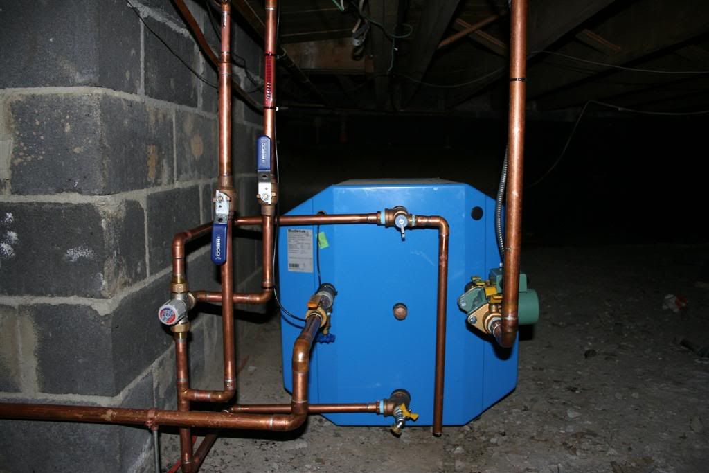

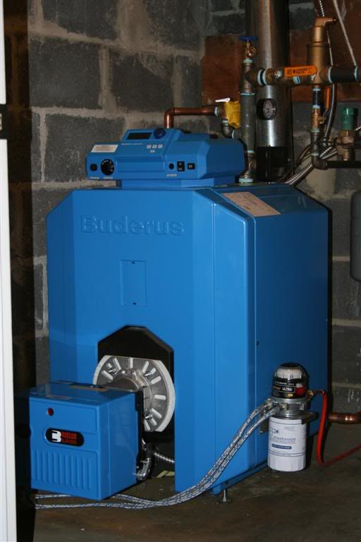

Bit the bullet and got a new system
Ok so here is the pics of my new system that was installed back in Nov. Added to the system which the pics do not show are check valves on all the returns.
Now I have spoke with a buderus service rep and he said its the way it works. the circ only shuts off during Warm Weather Shut Down and when there is a call for DHW. So when there is a call for DHW and the unit is not in WWSD then all that hot water in the boiler gets pushed through the house.

Can't really add anything to the original question but I didn't notice that there are copper fittings screwed directly into an iron fitting in the top left of the third picture. Not really good for the sake of longevity. Can't really see a hanger supporting that expansion tank either. If it ever became water-logged it could be one heck of a problem. Don't really like seeing wires tie rapped to heat pipes either.

Definitely agree about supporting the pipe that the tank is hanging on.
My jury is still out on the copper into iron case...
The main issue though: The way your system is piped, you really don't have a way to properly run with constant circulation. For that you would need a primary/secondary setup, which I don't see in the pictures.
I'm not all too familiar with the Loggy control settings, but you might want to take a look and see if the 'purge' routine is available, as TO mentioned. This would dump most of the excess heat into the indirect after it was satisfied.

The WWSD is set at 68 and the room temp is also set to 68. I don't see why this matters because the control monitors the OA sensor and will shut down the circ when the WWSD temp is met or exceeded based on the OA temp reading.
If you look at page 2 and 3 in the link below it states under what conditions the circ shuts down. So I don't understand how P/S will resolve this issue? Once one or all those conditons are cleared the circ will push water through the loop. So if there is heat in the boiler that heat will go through the house. Correct? If I'm completely wrong please enlighten me.
I really don't think it is a piping issue because if you look at page 10, it is my setup. The pic is not the greatest so I hope you can see it.
