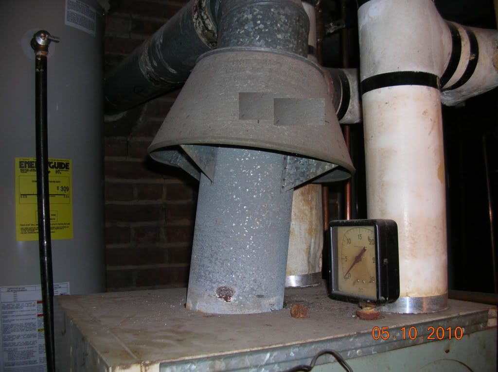

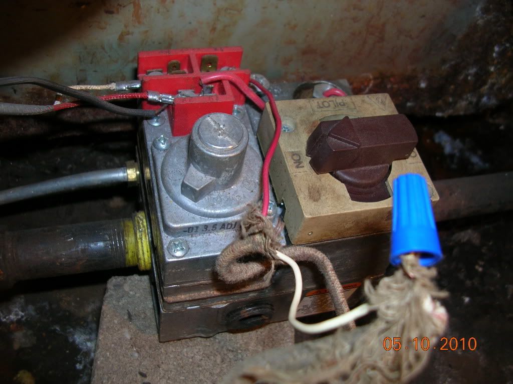

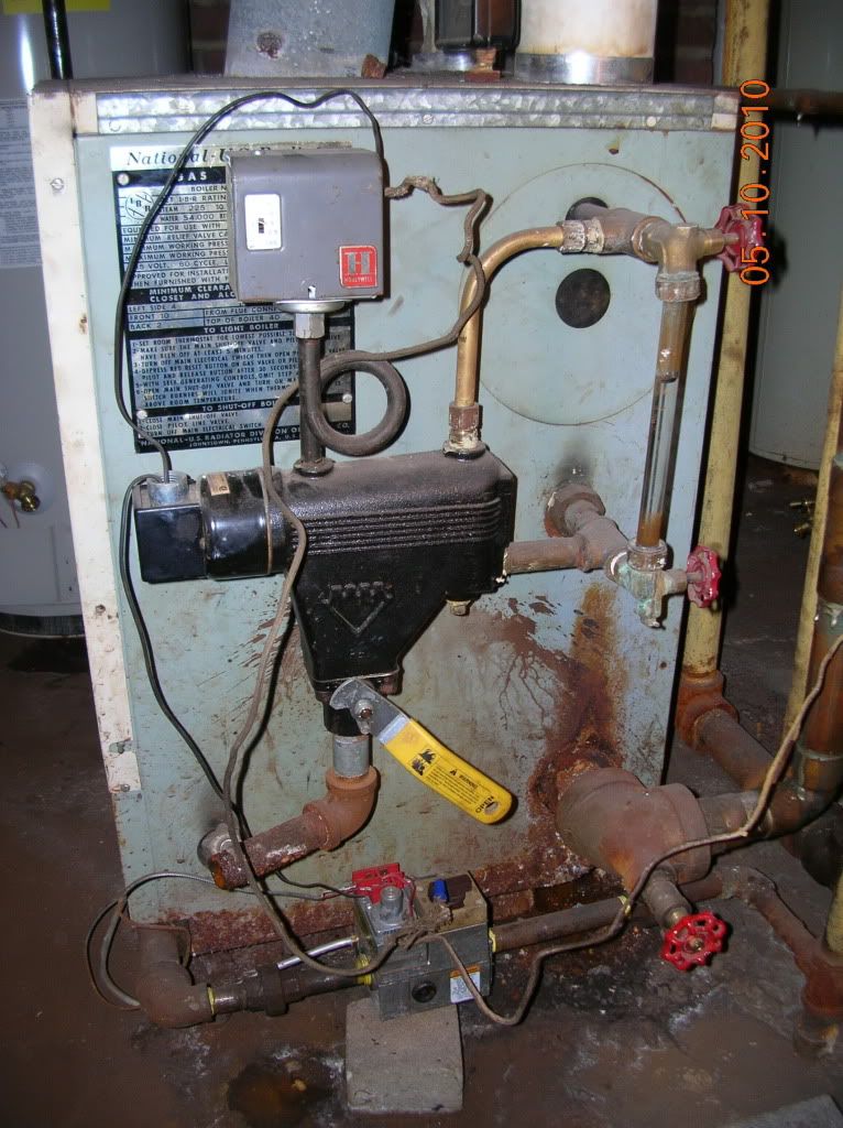

Ignitor has light on, water leverl is normal (it was low this morning, may cause the boiler shut off automatically. I added water ), but even after I adjusted room temperature to high, still can't light up the boiler.
Can't find any manuals for this boiler, but here is some pictures.

Is this a gas-fired boiler? Steam or hot water?
I can't view your photos.
Old 05-10-10, 07:47 PM
Q
Join Date: May 2010
Posts: 6
Likes: 0
Received 0 Likes on 0 Posts
gas fired steam heating boiler.

I'm going to toss in my guess...
Bad THERMOCOUPLE

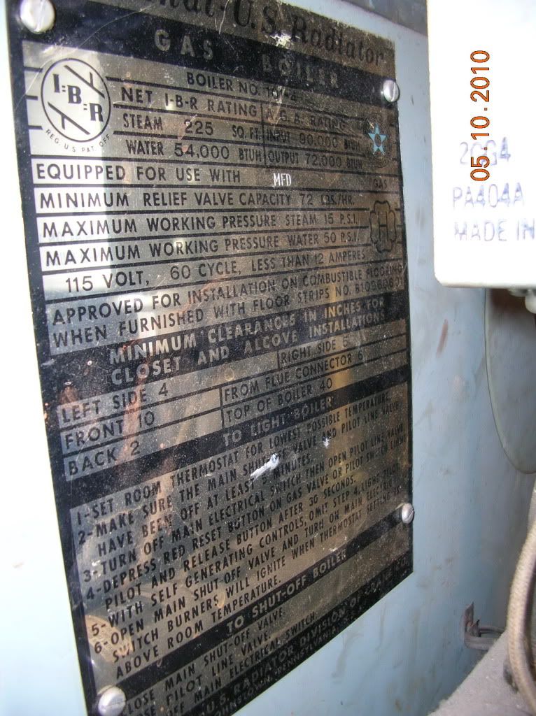

Problem was solved, now the heater is on!
I followed the instructions today by turning off the main electrical switch before open the pilot line valve. Although I don't know the reason why.
1) Set room thermostat for lowest possible temperature
2) Make sure the main shut-off valve and pilot line valve have been off at least 5 minutes.
3) Turn off main electrical switch then open pilot line valve.
4) Depress red reset button on gas valve or pilot switch. Light pilot and release button after 30 seconds
5) With self generating controls, omit step 4, light pilot.
6) Open main shut off valve and turn on main electric switch burners will ignite when thermostat setting is above room temperature.
