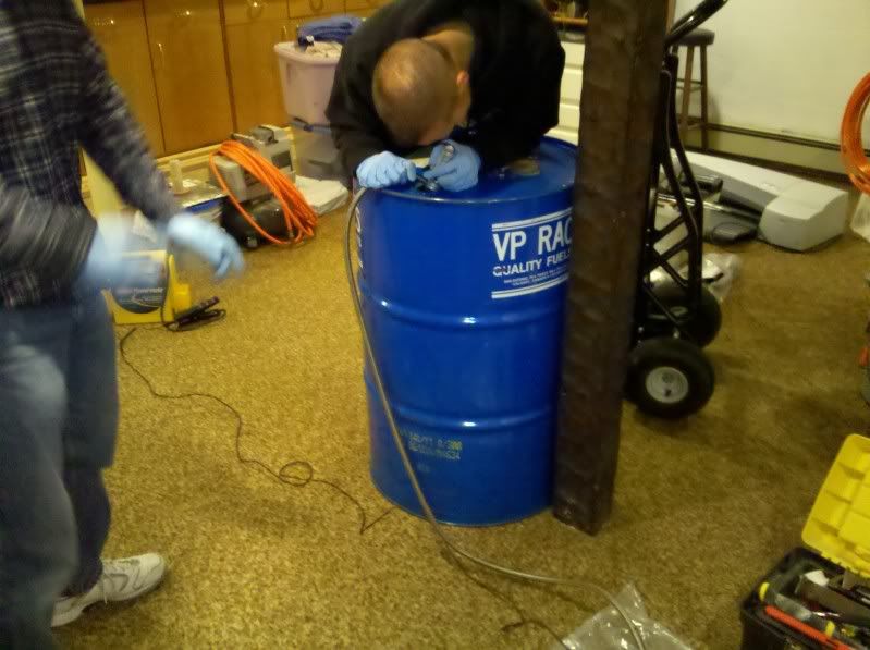

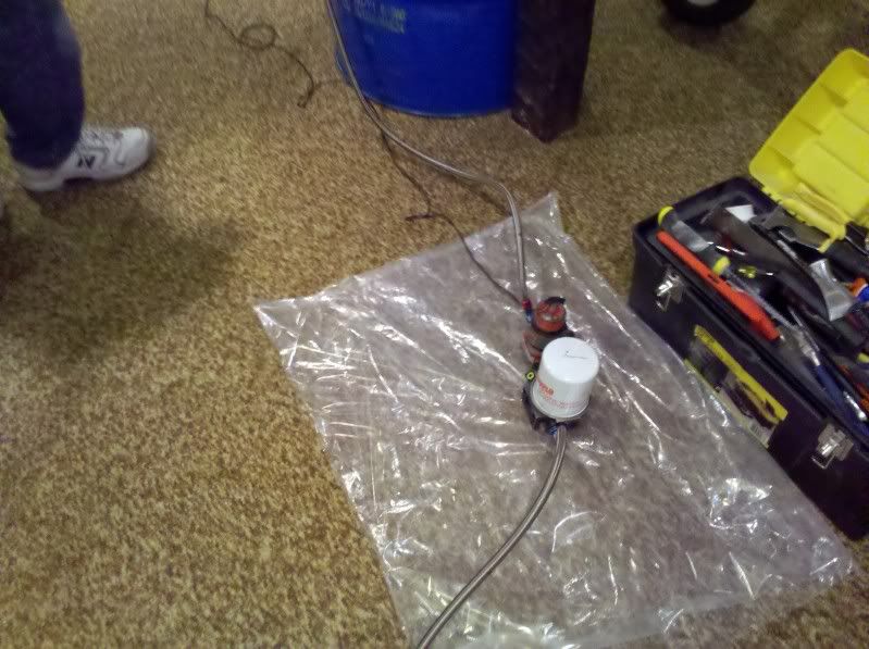

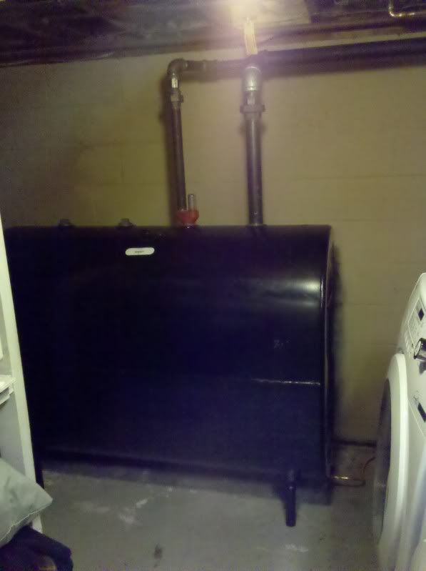

So I ended up doing the job myself. Actually I had a lot of help from my friends...4 of them! I was able to borrow a 55 gal empty fuel container and an electric fuel pump. I ran the old tank down as low as I could, about 1/8. We disconnected the feed line from the burner and pumped out the remaining oil into the 55 gal drum. This actually took a long time. I think the sludge at the bottom of the tank was clogging the line and filter. So it took a few hours.
Once that was done I just cut the old fill pipes with a sawzall and removed the feed line at the tank. We were able to get the old tank on 2 furniture dollies, and rolled it to the stairway. It was really heavy and with no place to 'grab' onto it, we decided to drive some 1 X 4 x 8ft pine boards into the sides of the tank. We then made a 2x2 handle to span the 1X4's for each end, and carried it up the stairs. It made me think of "Raiders of the lost Ark" and how they carried that tomb. It was a straight shot into the garage after that.
Getting the new tank in was easier as it was slightly lighter, and had built-in bars to grab on each end. The new tank was basically the same size (275gal) but the holes in the top were about 1" off from where the old tank's holes were. I had to make a HD run, and luckily a 45 elbow, and a few small pipe nipples got everything lined up for the fill pipes.
We pumped the old oil back into the new tank (about 25 gal). We also installed a new 3/8 coated copper feed line to the burner. Getting the oil primed into the new line was a bit of a challenge. We blasted a little compressed air into the tank and that eventually got the oil flowing thru the line. We fired up the burner and that was it!
Got 220 gal (ouch) delivered the next day, and no leaks whatsoever! All in all this was a full days work with 5 guys, but I saved a lot. All the parts came to about $760 with tax and no discounts. I then paid my oil company $75 to pickup and dispose of the old tank. I also bought the guys lunch. I'm just happy it's done!

You pumped that sludge into the new tank? At least ya filtered it...
Where's the drip pan? (secondary containment)
Is that you 'huffing' the fuel oil in the drum? or one of your friends? That stuff don't get ya high!

Yes we filtered the old oil out of the old tank, then filtered it again pumping it back in. It looked pretty clean. The sludge remained in the old tank.
I think I almost passed out a few times from the smell! Had to open a bunch of windows and get some fans going. But that was my friend with his nose in the tank.
Was not aware of a drip pan. I never had one. I wasn't expecting the new tank to leak. How much oil would a pan hold anyway? I would think if you had any significant leak a pan wouldn't be of much help or would it?

hi deuce5 –
I know very little – not like the pro’s here. I just try to learn all I can on the forum. My tanks are just a little younger than your old one.
You said you cut the fill pipes with a sawzall. I think the answer to this is obvious but I just wanted to make sure. You added the 2 unions in the picture, correct? (Guess so- I sure don’t see them in the old picture)
I don’t have any unions on mine. Just a pipe from the tank opening , through the wall, on to the outside of the house. So I always figured that’s how it would be done to replace my tank: cut the pipe then add unions.
Do you know is it pretty much flexible where you can add unions? Looks like where you added them is the most logical place and makes it easy to replace the tank again if ever needed. Just wondered if there were some requirements/conventions in terms of distance from the tank for the unions ? (Or any other rules for unions?)
Also when you tighten the threaded pipe do you do it until your eyeballs bulge or do you use some kind of torque indicator? And I always wondered are you supposed to use some kind of pipe dope on the threads? I know you shouldn’t use Teflon tape for oil connections but I was never clear on what (if anything) you should use? And are the unions a special case in terms of sealant?
Your job isn’t leaking so it sounds like a success and it looks good! Great!

I don't know what you use for the joints when piping with oil. I do know that you are supposed to tighten them until you see 2 threads left. I can confess that I didn't do this when I did some pipe work recently on my boiler, but I had to go back and tighten things up because of leaks. You don't apply sealant to unions. They have a soft metal, either brass or copper, where the two sides mate. When you tighten the nut, that soft metal makes the seal. You have to be careful not to over tighten a union.
The drip pan don't hold much... the sides are a couple inches high so it would hold a fair amount... it's not really supposed to hold all the oil in the tank, they don't generally bust open and drop their contents... they drip first. The idea is to keep the oil out of any porous materials, like concrete. A drip pan will 'buy you time'... because you will notice the leak hopefully before it soaks the concrete. The local codes in my town require them, but all towns differ, yours may not.
I don't know about '2 threads left' as a 'rule', but if the pipe had 10 threads on it to start with, that would be about right. I think a better rule would be to bury 8 threads. Yes it would take some muscle... your eyes might bulge a little, but your _____ shouldn't pop. A bigger wrench is a good thing.
I use 'blackstrap molasses' on those pipes... KIDDING! Any dope that is rated for fuel oil is fine but I think that thick black stuff is the best.
Galvanized pipe unions have brass or copper faces?
I personally wouldn't use a union, but that's just me... I don't know if there are any code considerations regarding that. I bet Grady would know.
If I HAD to use a union, I would put the male end pointing DOWN.
They are not really 'flexible.' I had to get the pipes lined up pretty exact to get the 2 sides of the union to mate properly. I did not really notice what the mating surface was, I assumed it was all the same material as the rest of the pipes. I did not use any sealant on the union mating surfaces. I just used pipe dope on all the threads. I just used my arm as a torque gauge, using 24" pipe wrenches. I watched the tank being filled from truck the next day. There were no leaks, no sweating so I think (hope) I'll be good.
As far as the location of the unions, I put it there pretty much out of necessity. I had bought a few pre-cut pipe lengths and I had to work with what I had. I had to go to HD for a few pieces that I was missing as it was a Sunday and the plumbing supply was closed.

I was not aware of this. My original thought was to dispose of all the old oil, but when I got 2 estimates from licensed plumbers they both said they would pump out the old oil, and pump it into the new tank. That is where I got that idea. Do you know where/how I would go about having it analyzed as you say?

Yes we added 2 unions. I didn't want to have to break the old pipes out of the basement wall and have to redo that because there is nothing wrong with the old pipes and it would have added extra work. I was concerned with getting everything done in one day. The plumbing supply I dealt with recommended the unions as a better alternative to a compression fitting.
Now that you mention it I do remember that one of the things I worried about in doing a tank replacement job was that it might be pretty tough to get the 2 sides of the union aligned correctly, because it seemed to me that there is no flexibility. I used unions a few times for some things where there was some flexibility and managed to get proper alignment, but I thought the case with the oil tank might be a nightmare. But looks like you got it done fine!
I'm sure if you do a web search for fuel oil testing you'll find others as well.
