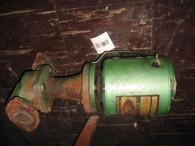

My old circulator pump (TACO 1/8 HP, 1725 RPM, FR 48, MOD 5KH32EG129EX) was leaking and the service person replaced it with a TACO 007-f5. The 2 levels on my house that I’m trying to heat is about 1300 sq feet. I can attach pics if someone tells me how to attach.
Now, my house is struggling to get heated. The hot water from the boiler is getting divided into both the sides of the house (same one zone). The right side is getting warmed up with no problem, but the left side is barely getting warm. The service person tried to bleed the water and said that there may be air pockets and when he left he said everything is fine. But, now, 2 days later, my boiler is struggling to warm the house. I very faintly feel the heat when I have my hand near the baseboard. This is happening on only one side of the house.
I’m thinking whether the new circulator has the same capacity of the older one? I’m no expert here, any help on sizing this would be very helpful. The new one says its 0-25 gmp and I’m unable to find the same for the older one (pic attached). Can anyone tell me what the older one’s capacity is? Whether the service man replaced the right capacity pump?

Hi Saturn, set up a free account at a photo hosting website. I like Image hosting, free photo sharing & video sharing at Photobucket . Upload the pics there and come back here and drop a link to the album so we can view.
The 007 is more than likely up to the job, and there probably IS air in the loop. Since fresh water has tons of dissolved oxygen, when it's heated a few times that O2 comes out and reforms the bubbles... that's why it worked a few days... I'm sure the guy had to drain the system to replace the pump, yes? So you've got all new water... after a while, the air should all go out and you should be OK...

First things first... you need to get him back to fix that wire where it enters the new circ... that is awful... how could he leave it like that? The metal sheath on the cable is split, and the wires are exposed... that's just plain WRONG! (not to mention dangerous, if the wire gets nicked by the sharp edge) ... There should also be a 'redhead' insulator stuck in the end of the metal sheath to protect the wires... should look like this:
photo courtesy popularmechanics.com
It's stretched too tight... He should have replaced the cable with a longer piece... or simply turn the pump 180° so the cable was long enough...
Bottom line is that needs to be fixed... soon!
While he's there doing what he should have done right the first time, ask him to bleed the air again, and watch what he does... you shouldn't have to pay for him to come back and fix that wiring!
