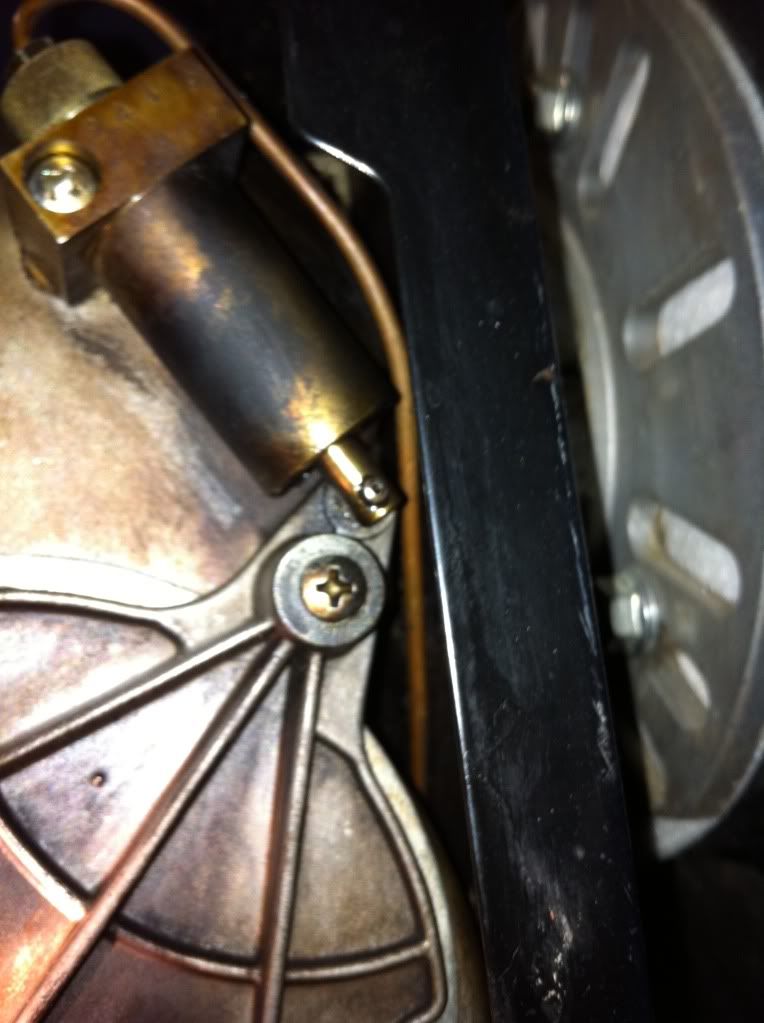

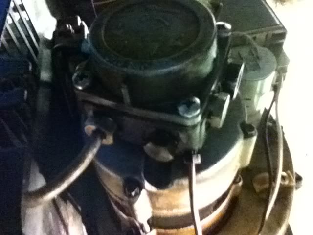

Some pictures (albeit poor ones...)
OK, I tried cleaning everything (a toothbrush and soapy water worked pretty well). But I still cant seen to tell where the leak is coming from.
Here are some pictures with things cleaned up:
The butterfly valve (again, not where the oil gets and this all looks pretty clean)
This end is the problem area:
and then unfortunately the blurry one is after running overnight, you can vaguely see a drop of oil ready to drop from one of the plugs
In the first picture you can see a plug just above another one. This plug seems to be hollow so you can put a screwdriver in there and turn another nut. As best I can tell, this is the one that is leaking and then the oil migrates down and covers all the others.
Can I take these plugs out one by one and inspect the washers?? (and would resurface the washers while out? Do any of these make fuel ratio adjustments? (meaning I would have to have someone come and reset it?) Of course the pressure would need to be released before taking any of these out.....
Tell me, oh great ones, what should be my next step?? (maybe better pictures and more attempts at isolating the leak......?)

Grady is the 'great one' when it comes to Riello, in my book anyway!
While we're waiting for his comments, I don't think it's a good idea to do anything with the screwdriver slot ... that one is the PRESSURE ADJUSTMENT on the pump. If it's leaking from there, I'm picturing perhaps an O-ring that has failed...
Honestly though, the best thing might be to just replace the pump... unless the Great One has a better idea!

Well, well, well, the computer gods have finally decided to let me post a reply, or so it seems.
From the looks of the strainer cover, something's been leaking a while. As Trooper suggested, don't mess with the screwdriver slot. It is the pressure adjustment. Don't be afraid to tighten those plugs. The one below the pressure adjustment is used for bleeding air.
Another place from where oil could be leaking is around the solenoid stem. You would have to remove the knurled nut, saddle, & solenoid coil to see.
With that pump being the older style, I can't remember just where the hydraulic jack line would connect on the new style pump but I think it is on the same side as & below the nozzle line connection.
One more thing: DO NOT take of the strainer cover unless you have a replacement O-ring for it.

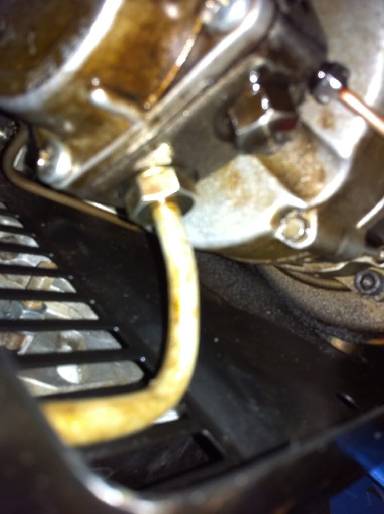

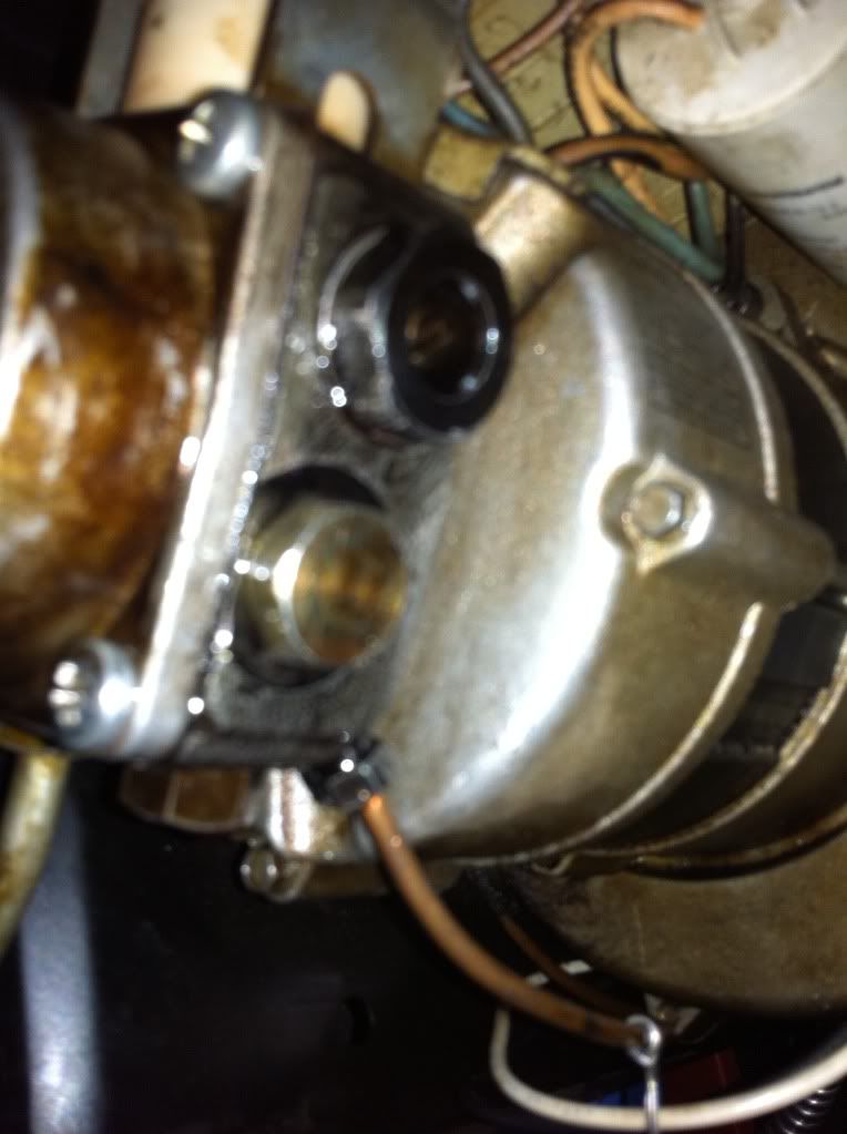

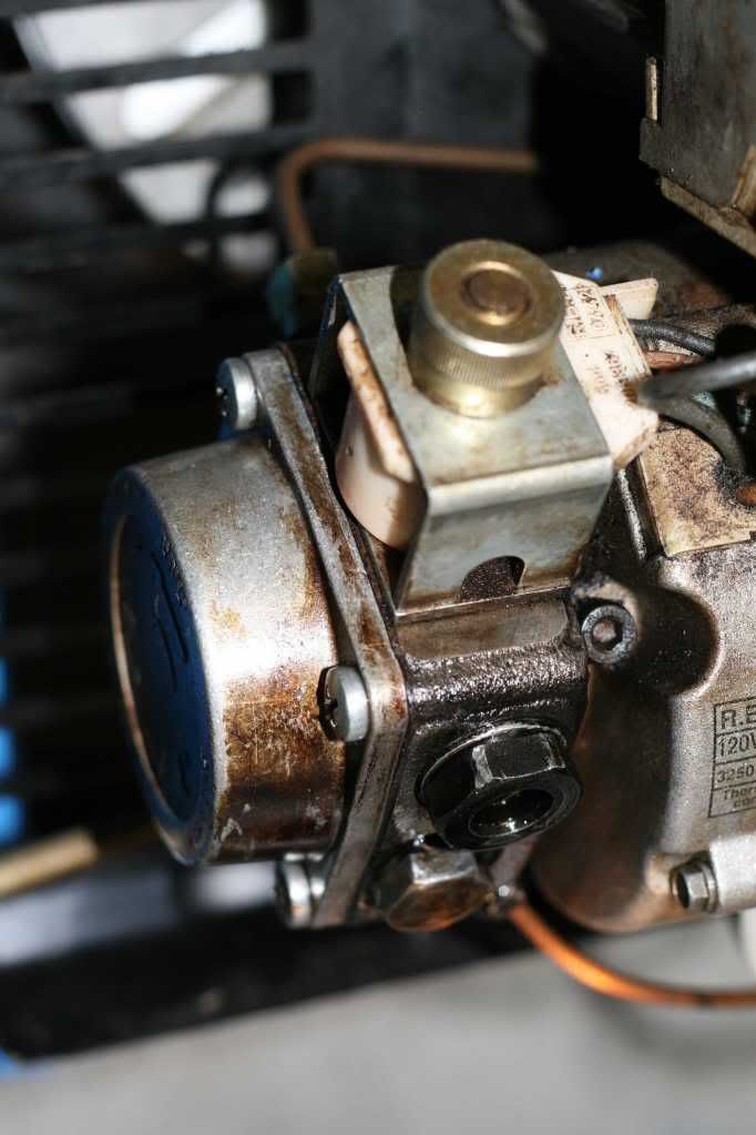

More pics
Im trying to get some decent pics, but its not all that simple (low light, close to the floor, closeup shots, etc etc). Here are a few more:
Some observations. In the second picture you can see the solenoid and this doesnt seem to be the culprit. The top surfaces stay pretty dry and clean.
Second, when I look closely at that fitting with the screwdriver nut inside (the one you all told me to stay away from), I dont see accumulation around this fitting from the INSIDE. There is a metal compression gasket (or appears to be) around the outside nut... and this seems to get wet around the interface with the housing, but not as much as other areas.
In the first picture you can see a drop of oil accumulate on the lower fitting(s), including this small copper line connect. Its not clear to me that these are leaking, or just the lowest point for the oil to migrate to before dripping.
Something that bothers me is that although its not that obvious on the pictures, the surfaces around both of the fittings on the front (the one with the screwdriver slot, and the one below it) get wet. Since gravity tends to pull things down, this suggests at least something is leaking on these higher areas (again meaning, not the copper line connect because this is the lowest point).
I am trying to study the end cover gasket. Maybe it is seeping along the entire area? This would explain more than one point being wet. I did give these screws a turn, and all 4 squeezed down a little more, but I cant tell a difference in leak.
And yes, I would say this has been leaking for over a year now.
What do you all think if I were to remove and inspect all of the plugs (minus the ones you tell me not to touch)??. The ones I am interested in taking out and inspecting (and resurfacing gaskets if metal, maybe replacing if fiber):

Join Date: Jan 2005
Posts: 12,667
Received 39 Upvotes
37 Posts
Good Pictures, thanks.
Under the pressure adjustment is a crushable aluminum washer. Don't hesitate to try tightening the hex. Just don't mess with the screw without a pressure gauge.
The plug below the pressure adjustment should also have a crushable washer. In a pinch I have been known to use a bolt gasket from an oil filter.
I don't think the plug in the return port has a gasket.
Both the fuel inlet & capillary fitting are a compression like fitting & metric. All threads on a Riello are metric.

OK, I cleaned this all up again and got some white cotton string and tied a few loops around each fitting. The thought was this way I could see which particular fitting it was leaking from.
Sure enough, it was the top one with the screw adjustment in the center.
Per the suggestion here, I cranked this down a bit (didnt use a torque wrench, just gave it a good solid seating). It definitely turned.
Viola! No more leak (at least so far so good......)
