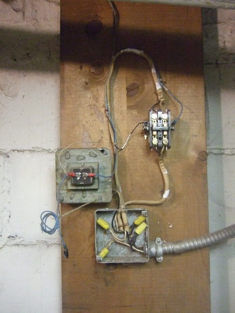

Here is my problem... My circulator keeps coming on and going off intermittantly during the call for heat from the thermostat.
What i have noticed is that if I turn the thermostat all the way up (85 or so ) to a constant call for heat then the circulator will come on and stay on.
When i leave the thermostat setting at 70 then it will kick the circulator on and off all during the call for heat. i have tried adjusting the anticipater dial to different settings with no luck.
Will a new thermostat fix this problem?
will any thermostat work? or does it take a special thermostat for boilers? Its 24v going to a transformer downstairs that works a 120v switch for the circ.
can i use digital or stay with the old type mercury themostat?
Thanks for your help.

Cat, are there only two wires on the existing thermostat? Chances are that it is... and that you can use a digital or mercury.
Tell us exactly what the 'transformer downstairs' is... what it looks like, are there any make/model numbers on it, etc...

The picture #4 shows the transformer thingy. It is the thing on the left. You can see the thermostat wire coming down from the top. One thermostat wire connects on the left side of the transformer and the other thermostat wire connects on the left side of the110v switch which "clicks" when the circulator comes on or off. i didnt see any numbers on the transformer. It jsut looks like it has 110v going in the back and 24vac out the front I actually measured it at 26-27vac.
Yes there are just 2 wires on the thermostat. So I can use any type thermostat? do you have any recommendations on thermostats that work best with boulers? I was going to buy one at lowes last night but wasnt sure what to get. I didnt see any that said they would work with a boiler.

Oh yeah, now I remember... that's that extremely dangerous setup that I saw in your other thread. The one with the exposed 120VAC terminals on the relay on the wall... and the junction box with no cover... yer lucky I'm not an inspector in YOUR town!
Yes, any two wire thermostat will work, just ignore the wiring for the cooling part.

Trooper... I have also put the cover on the box and the 120v relay I covered back up with the thick styrofoam box held in place with bungy cords. I use the box because that relay makes a really loud click that can be heard throughout the upstairs. The styrofoam box and the paint rollers I have behind the board reaklly helps dampen the sound. Its always made that loud click and I figured since it was a 120v switch that was just the nature of the beast. Do they make quieter relays now? Or is that relay not supposed to be that loud?
All relays are gonna 'click'. Yeah, some are louder than others. Your solution sounds fine to me... but if you did want to spend a couple bucks, you could consider something like a Taco SR 501 which would combine the transformer and the relay in one box, or a Honeywell R8845... or ? ... there are a number of them out there.
R8845U1003 - Honeywell R8845U1003 - Universal Switching Relay w/ Internal Transformer
Your relay is switching both the hot and the neutral. You don't need to do that... you only need to switch the HOT. The neutrals can be tied together. Just like a regular light switch... only the black wires are switched, the neutrals travel through.
I didn't notice the paint rollers! I must be slipping!
[I just looked at the pics again, and can't see them at all... you hid them well!]
I think the board that relay is mounted on is amplifying the sound. I bet if you got some rubber faucet washers, removed the mounting screws and put one washer between the board and the relay, another washer on top, and put the screws back 'loosely' you would hardly hear it at all.
