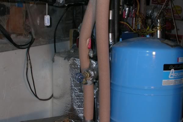

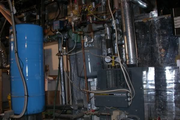

system pic
Hopefully, there are 3 pictures following.
One picture shows a drain valve to the left of the blue storage tank. One is of the whole system, messy. The last pic is of another drain valve just above the Taco air purge. Hope these help, but am doubting it.

OK I see the pics and thats a mess. I see 5 zones out of the 6 you mention.
I do see three valves at the zone valve but no drains... Could you take better pics???
Is that a valve at the pressure gauge going into the boiler? It looks like we may be able to isolate the boiler there and then drain each zone at the drain on the boiler.

Finally got the pics posted. Don't know if you can tell but there are not enough isolation valves. Can't isolate the expansion tank, or the boiler, nor each zone individually. Only 3 of the 6 zones have a manual shut off valve in addition to the automatic zone valve. And these are placed next to the zone valves. So I don't understand how I will be able to isolated each zone, then the boiler to do the drain and refill for each individually.
Can I just do a whole system drain and refill? Will that top most zone get filled? That one has only the auto zone valve. Seems like this one will drain but not refill since I cannot isolate it.

I noticed some problems in your pix. The green Taco pump is mounted wrong. The motor should be horizontal, or else it will fail prematurely.
See the automatic air eliminator mounted on the air separator above the gray expansion tank? Evidently it has been leaking based on the rust on the pipe below. And make sure the green valve cap on the auto air eliminator isn't screwed down tight - otherwise, it won't work.
It looks like you've got 120-V wiring dangling all over the place - that needs to be in conduit or greenfield. Call an electrician.
What's the make and model of the boiler?
The system's arrangement seems very cramped, probably making access for maintenace difficult.

Tell me what you want to see in the picture. Just better pics does not tell me what to shoot specifically. The air purge was replaced 1 or 2 years ago. The rust is from the old one. This one works. The circ pump was mounted 15 years ago and is still going. I will wait till it fails to change to correct angle. There are no valves at input or output of the boiler. The yellow item is the info tag on the pressure relief valve. All the 120 volt wire was there when this was originally inspected and okayed by the county, 15+ years ago. The system looks a mess but is easily serviced. I don't know about adding all the extra valves though. That might be difficult.
I don't really want to rework a system that has been working for 15 years unless there is a problem. Then it makes sense to make the mods necessary to make it easier to drain. If it ain't broke...
Now that I think about it, I don't know the system has ever been totally drained. It originally had 2 zones with manual shut off valves plus the indirect water heater with no manual shut off valve. Then a zone was added about 4 years later. I assume he just opened or drained the system enough to add the zone. Then about 9 years after that two more zones were added. Those last two are the ones without manual valves. But they are also the ones with the longest runs and the one that is 22' above the boiler. So I am guessing there must be a way to get the water into this zone.
The boiler is a Teledyne Laars Mini Term II 100,000 BTU induced draft on natural gas. Originally for propane then converted.

Your zone valves will isolate each zone. If there is no call for heat at any zone they are closed. We want to open one at a time individually and push the water through each zone and out a drain. But we need to isolate where the fill water comes in so it goes around the zone and out the drain, not just out the drain.
I see the drain valve above the circ and a blue isolation valve left of that. We need better pics there to see how that area is connected to the boiler. You may be able to bleed there and open on zone at a time. But not if the make up water it just going to come in and go right out the drain valve.
I see the other drain by your hot water tank, with the read handle isolation valve. Same there as stated above
I also see a valve in the off position just below the fan in the background in the one pic. Where does that go and why is it off?
Or either one of these may be able to isolate one side and you can drain at the boiler.
What will happen if you do what you say in your post is you will have air in your zones and not be able to bleed them. Isnt that what we are trying to do here? You might not want to try that, especially if its cold out and you need heat. You never know what can happen.
Better pics of these areas and where the pipes lead.
