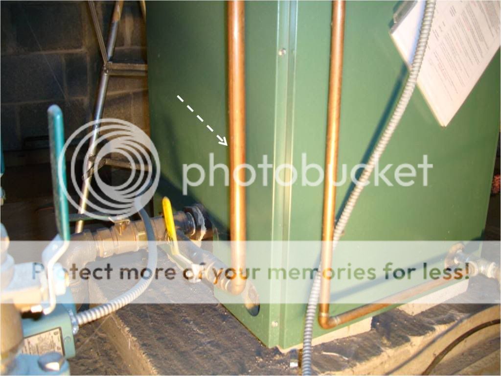

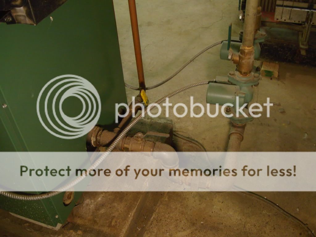

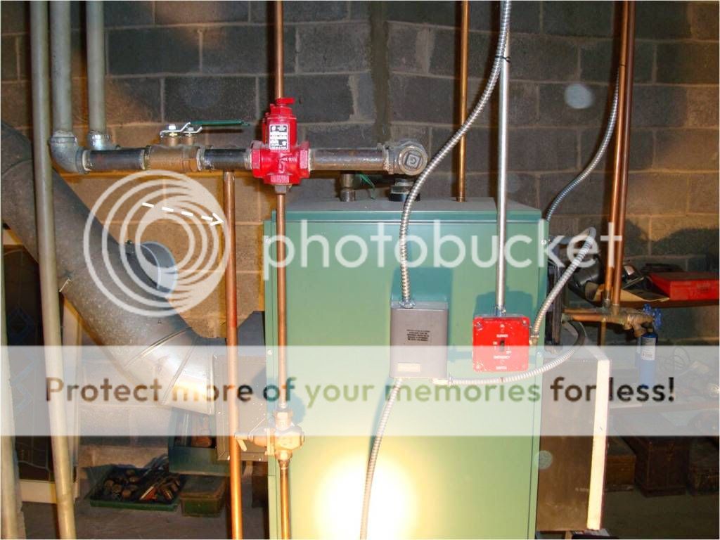

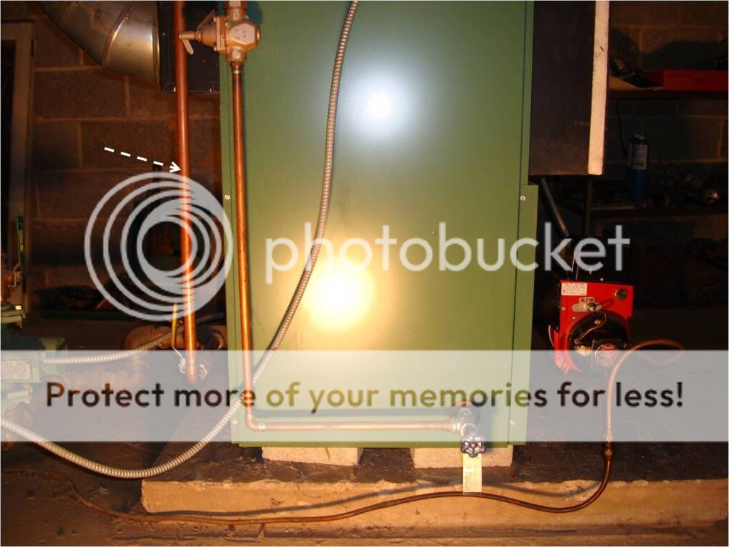

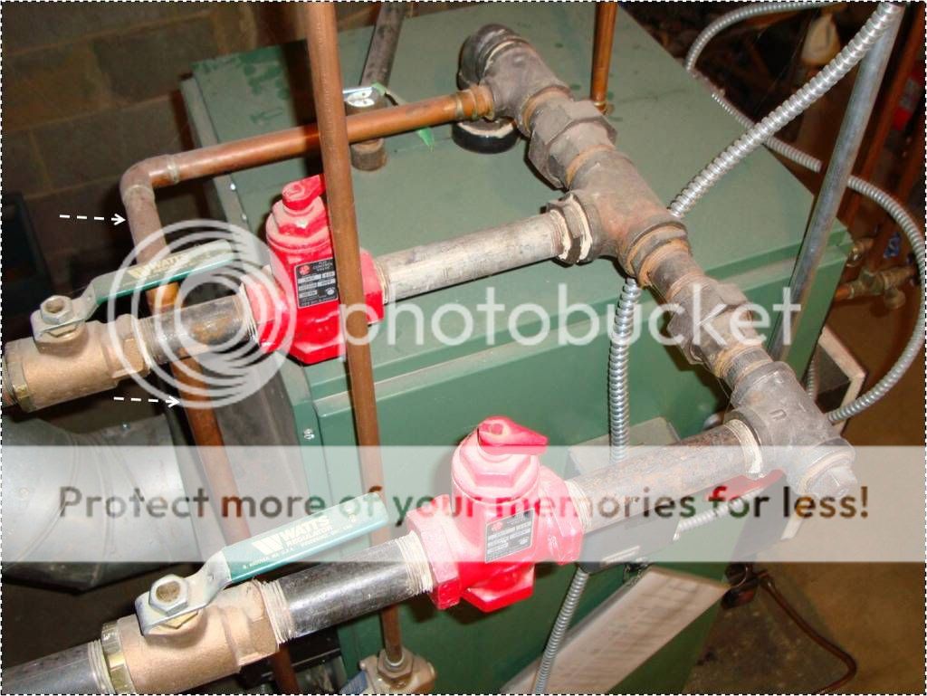

hi guys -
Got a few more pics then my battery got tired and went to sleep (charging it now in case you want another pic).
I put some dashed arrows in the pics to help identify the so-called bypass pipe or whatever the heck it is ?

Looks like a boiler bypass. like Trooper said the valve on the return is useless when it come to adjusting the flow between the boiler and the bypass. Did you measure the temperature of the return and supply water to find out the Delta T? and the temperature after the bypass?
The bypass on my boiler is not full size but it is mixing the supply water with the return water, my delta is 30 degrees.
Unless the idea is to slow the flow for the whole system including the boiler, allowing the boiler to heat the water faster if needed, but then it will not deliver even/enough hot water to the whole system.

You have a bad attempt at a boiler bypass. The bypass should be full sized and if there is a valve in the bypass it would be full open. There would have to be a valve either supply or return but between the tee's for the bypass and the boiler.

I'm thinking that your system doesn't even need a bypass anyway. What were your emitters again? fin-tube?
Also thinkin' that if you just went ahead and left the bypass valve fully open, you might not even notice anything different. Any flow that did occur in the bypass would offer a bit of protection.
