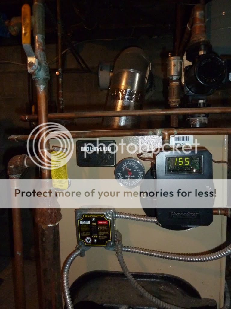

Hi, I'm new to this forum, and my wife and I are homeowners for about a year now. Trying to DIY on pretty much everything and learning along the way. We have a simple 1200 sqft ranch with a walk-out basement. It's baseboard hotwater with a coil over furnace/boiler/burner (not sure what the proper term is). There is only one zone that circulates around the house, room to room. I noticed that the last 2 rooms (dining room and small office room) do not heat up as well as the other rooms in this loop.
My question is, is it possible that I have air in the system? I don't really hear any gurgling, and the copper pipes seem hot. I've been thinking of wrapping some insulation around the copper heat pipes in the basement. (Older house built @1960).
I guess I'm looking for some help on some of the valves around the unit and an explanation of how the system works, id it's self purging, etc... Also, I have temp adjustments set at 170/190, is this correct for winter/North East? Below are some pictures I just took of the unit.

See the automatic air eliminator just to the left of the circulator pump? Is the valve cap screwed down tight? If so, loosen it or remove it - otherwise it won't work. Ditto for the one just above the expansion tank.
There is an old, rusty flo-control valve above and to the right of the expansion tank. Rap on it and see if the check valve is stuck partially shut. Or, temporarily jack open the manual lift screw on top - see if it makes a difference. Anyway, put that valve on your list of things to replace eventually.
The expansion tank seems to be hanging from a copper pipe that is bowed down due to the weight. Needs better support.
If it's just your last two rooms that seem to be low on heat - could be a series system or a monoflo system with the front end hogging the heat. By feeling the piping, see where the temp seems to drop. We need more photos showing how the supply and return are piped to the individual baseboards and any valving or monoflo tees in the supplies and returns.

It was tight but I loosened it by hand, and air came out and stopped. A quick burst. Leave it loose? Will air get purged?
I will add some better support. No change from tapping the check valve. I will get some more photos of the system but it looks to me like they go in one end of the baseboard and come out the other and that's it, no valves or tees. In a circle around the house. Thanks for the help!

Troop, it looks like there is one hiding behind the greenfield in pix 1 & 5. If it works or not is another matter.

So I have a THERMOSTATIC TEMPERING VALVE?
Yes. It's that 'three pipe' device with the red cap on it, located to the right of the black box with the LED display.
What's the greenfield?
A type of wire. The 'corrugated' flexible silver colored metal casing... in the pictures that wire is 'hiding' the tempering valve.
Is that the digital box with the temp readout?
That black digital box is your AQUASTAT.

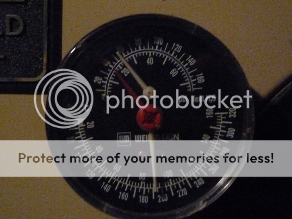

To the left of the aquastat is a gauge. That gauge has two scales on it. One is for pressure, the other for temperature.
Tell us what the pressure reading is... and at what temperature... and if the temperature gauge agrees with the digital readout.

That explains my last post I think.... I just ran downstairs....gauge reads 55 PSI now. The temp gauge reads 195 and agrees with the digital gauge.
Check the gauge again... if you are reading 55 PSI, your relief valve would be spewing already... it's set at 30 PSI.
There are probably TWO scales on the pressure side. One is in FEET, and the other is in PSI. Check which one you are reading... 55 FEET should equal about 24 PSI, which may be a bit on the high side.
There may be a THIRD hand on that gauge... that third hand if present is only a 'bookmark'. It can be adjusted as a 'reference' point. So if you do have that third hand, ignore it for now.
Take a close up of the gauge...
Yes, I am an amateur...lol. It's about 24 PSI!

OK, that's not too bad really. When you operated that fill valve lever, you probably added a few PSI, but you should be fine where it's at now.
A little bit about that fill valve... aka Pressure Reducing valve, aka lots of other names... (Some not so nice!)
That valve is actually a 'regulator'. It sets the MINIMUM pressure in your system. The minimum pressure is usually 12 PSI for a one or two story home. Three story home would be a bit higher.
This minimum pressure is seen when the system is COLD, which yours will never be because it stays warm to heat your domestic hot water.
The type of hot water you have ( with a coil immersed inside the boiler ) is very inefficient. The boiler needs to be kept warm 24/7 just to make hot water for the home... EVEN IN THE SUMMER...
If you are planning on staying in this home for a while, you would do well to research INDIRECT WATER HEATER, and consider having one installed at some point. They are somewhat pricey... probably over $1000 installed, but MUCH more efficient than your 'tankless coil' setup.

Originally Posted by NJ Trooper View Post
By the way, has it been mentioned to you that you should have the boiler cleaned and the burner serviced YEARLY? SOP with an oil burning appliance.
Yes, and I need to have that done but was told every 2 years. The boiler was replaced April 2009 before we bought the house because it was under warranty with the seller. So I was figuring this coming April or so after the winter.
UPDATE: The baseboard in the room that gets colder, seems to be getting much hotter now when the circulator kicks on...but I think my issue would be solved if I zoned that room/side of the house separate because right now, my thermostat is in my livingroom which seems to hold the temp real nice. Because of that, the other room cools down before the heat kicks on again. My temp solution may be an electric freestanding portable baseboard for that room this winter.
I'm going to take temperature readings in all the rooms to compare to the living room where the thermostat is.
I know that fans can cause drafts, but if the floorplan is open enough, a small-ish fan might circulate the heat around ... and save some $$$ on electricity...
Also, if you haven't already done this, you would be surprised how much more heat you can get out of a baseboard unit after it has been cleaned. Pop off the covers and get a brush and vacuum cleaner and vacuum out all the fins. I think rbeck mentioned earlier about wall to wall carpeting... the bottom opening of the baseboard needs to be CLEAR... air MUST flow through the unit freely.
I will clean out the fins, we remodeled the inside of the house , no carpet, all hard wood floors. Circulating the heat out of the living room is an idea! Thanks for all the help!

For curiosity sake, get a tape and measure the amount of installed baseboard... just the part with the fins, not the straight tube... this will tell us if there is too much element installed in the single loop.
When thinking about separating into 'zones' in the future, you probably want to think about how the zones are going to interact with each other. If there is a fair amount of air exchange between the proposed zones it might not make much sense to do it. On the other hand, there might be some advantage to zoning the bedroom areas though...
One problem you might encounter... if you make the zones TOO SMALL, you will end up having a problem with the boiler SHORT CYCLING if only one small zone calls for heat. You wouldn't want that...
What is the BTU rating of your boiler?
Last thought for now... there should be 'damper flaps' on the top of the baseboard cabinets that you can close... try experimenting with closing some of the flaps in the warmer rooms... you might have some success balancing the temps in the home. Worth a shot... don't cost nuttin!
