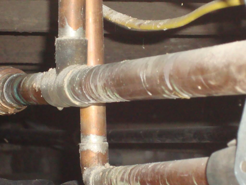

Hi everyone first time here and my first post.. Well i want to have a 3 zone heating system, i have a baseboard heat and trying to get everything together to start the project. I am looking at buying the taco z075c2-1 zone valves (51.99 each). The big problem i have is on my first floor i have mono flow t's and the second floor i have straight 3/4 copper no t's, and im adding heat to a room on the first floor on its on zone 3/4 straight copper so do i just install another normal T in the return line like the second floor was? So if anyone needs more info or pics let me know thanks.

I can't see enough in those few pics to give any advice really... we need enough pics to get a mental image of the whole system... the way it all fits together. You need to step back with the camera and get some shots from various angles that allow us to see how the whole thing is piped.
How big is the addition? How many feet of baseboard?
The problem that often arises when running zones for just one room is that the boiler will end up 'short cycling' because there isn't enough load on it...

ok i will try later tonight to get the pics but im in a half basement the rest is a crawl space, it looks like a mess of pipes with some soft copper and sticking a water heater next to it but i will take pics later, but i can tell u the addition is 28 ft of baseboard not including the run to the room and back.

Did you do a heat loss calc on the new room in order to determine the correct amount of baseboard to install?
28 feet is around 15K BTU output. If that happens to be the only zone that calls for heat you may end up with short cycles on the burner...
By the way, you said 3/4" piping? What I see in the pics looks like ONE INCH to me...
Do the best you can with the pics... anything will help visualize...
Is there another RELIEF VALVE somewhere on that boiler? The only one that I see is the red one to the right of the boiler, next to your pressure reducing valve. That valve is likely not a 'proper' relief valve by today's standards...

no the room is a 12x18 with vaulted ceilings about 12 ft.
yea it comes out of the boiler with 1" then splits to 2 pipes with 1" for a few feet then reduces to 3/4 for the entire second floor, the first floor has 3/4 then at the flo t's go to 1/2 baseboard.
No thats the only relief valve, yea i dont know if it is, just that i had to replace it because it was leaking and i put in a back flow preventer because there wasnt one. Also the boiler haD a domestic coil but got rid of it for a electric water heater. getting pics now

In the first pic... I believe I can see the domestic coil pipes out the side of the boiler on the left... and they appear to be capped off. Most manufacturers recommend NOT capping them when they are abandoned. There can be an issue with pressure building inside the coil if they are capped. I've never heard of anyone having a problem that way, but just so's ya know what is recommended. Myself would loosen the cap so that any pressure build-up can vent.
Also, the return pipe coming down to the pump... there is a drain valve teed off that pipe... it appears that you have a brass hose cap on that drain valve... good idea because if it leaks it looks like it will drip on the burner. If my eyes are jivin' me and you don't have that capped, then do so.

k so what do u think i should do??? the room is built with 2x6 and insulated well there was pics of the construction the last owner gave me.. Yea there is a hose cap on the drain tee thanks good eye. Not sure why but looks like a mess of pipe that needs to be organized a little. Thought i would come out of the boiler with 1" and have like a manifold with 3 outputs of 3/4. and then bring the return back for the one addition and tee it with the other return line. Not sure if i should have a shutoff b all valve before or after the zone valve? Also are the taco sentry z075c2-1 a good zalve to use in my application?

So, I guess that the answer to the question you asked is:
Yes, basically that is correct. I myself would take the opportunity to 'clean up' some of the piping, and install manifolds for the supply and return. I would install them in such a way as to make replacement of the boiler really easy... just cut out the old and splice the new one in... and judging by the age of yours... that day is soon... or maybe not, I guess it could go another 50 years with some luck.

Is the addition like totally separate from the rest of the living space? or is it 'open' with good air exchange? If it were open, I might just consider adding it onto another zone to avoid the short cycle possibility.
I think you posted your previous reply while I was typing one of mine! and it looks like we are thinking alike...
In general, one would want two pipes of some size to feed the next size up... rule of thumb... so two 3/4" into one 1" ... that would keep the flow velocity under control.
But, what are the odds of all three zones ever calling for heat at the same time?
Still, to 'make it right', you would want to use 1-1/4" in and out of the boiler to the three 3/4" ... I believe you could probably 'get away with' keeping it at 1" though.
As I recall though, isn't the pipe in and out of the boiler ALREADY 1-1/4" ?
